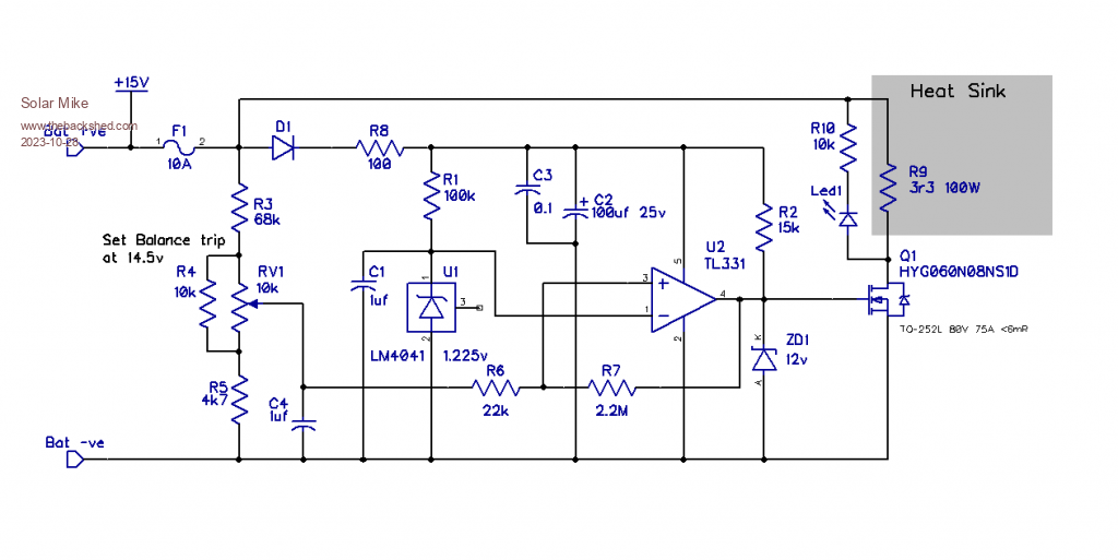

Currently building a couple of systems for 24 volt DC submerged water pumps; the pumps each draw 8 amps when running and > 50 amps on starting; intention is to power the pumps from two series 12v car batteries and charged by two 180W parallel PV 24v panels using a simple PWM controller.
To keep costs down, we have a number of (got from the wreckers) 12v car batteries in various conditions and will use these in pairs based on similar capacity.
However charging two of these in series because of their indeterminate condition, results in one battery always getting over charged. I need some sort of balancer that will discharge with > 5 amps load to keep them evenly charged.
Figured the most simple solution is to sense each batteries charge voltage at the bulk state and place a discharge load across it when bulk is exceeded; this will allow the other battery to get up to bulk, so they both even up.
I threw this circuit together as I have these components on hand, its just an accurate voltage reference, comparator that will work with high battery voltages and a mosfet switch plus load resistor; place on a small pcb, one for each battery.
Would be interested if anyone has perhaps a simpler solution.

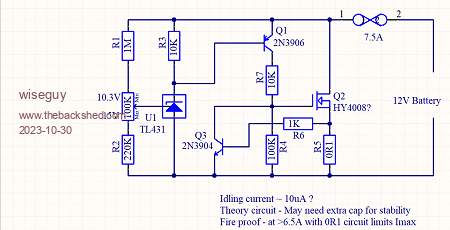

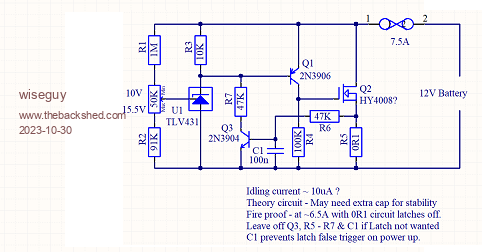

Posted: 11:13pm 29 Oct 2023

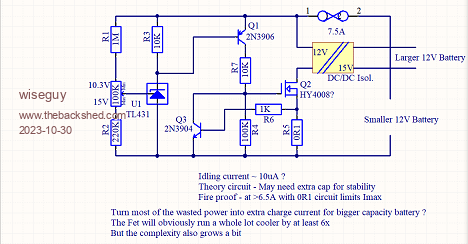

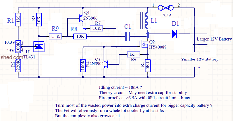

Does the circuit need to be any more complex than this ?
It can be considered as a precision high power adjustable Zener.
After posting realised that the Schematic was for TL431 voltages so have recalculated for the TL431V and posted both.  TLV431 is a lower power version of TL431 with better specs but a lower reference of 1.24V instead of 2.495V !
Edited 2023-10-30 09:48 by wiseguy

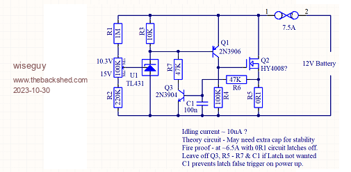

Posts: 3422
Posted: 11:47pm 29 Oct 2023
Trying to follow the circuit.
When Id > 6.6A Q3 turns on supplying base current to Q1. That then applies 12V to the gate of Q2 which blows the fuse.
Likewise if Vbat > setpoint = blown fuse.
Should Q1 be NPN?
wiseguy
Joined: 21/06/2018
Posts: 1336
Posted: 12:00am 30 Oct 2023
Sorry for the brain teaser Phil, you are quite correct it latches on instead of off .
As I said theory circuit warts and all
I will edit one of the schematics and repost, it was just meant to illustrate the programmable nature and connection of the FET without needing opamps etc.
It would be better configured to just limit current to the 6.6A and forget the latch - it seemed like a good idea at first.
Q1 is correct as PNP as TL431 reaches Vref point it conducts, turning on Q1.
The scenario of blowing the fuse at connection, as drawn above would only occur if the battery voltage was already overcharged > for instance the 14.5V desired setpoint.
Circuit Rev2 with current limit....
Edited 2023-10-30 10:08 by wiseguy

Posts: 3422
Posted: 01:02am 30 Oct 2023
  Quote  Q1 is correct as PNP as TL431 reaches Vref point it conducts, turning on Q1.
Yes, I didn't look at that properly. As Q2 turns on it limits the supply to the reference, thus has negative feedback.
As Solar Mike has 2N3055s the circuit could easily be adapted to use one of them with the addition of a NPN driver transistor.
Edit
A single 2N3055 would overheat so 2 in parallel, each with a 0R22 emitter resistor.
14.5V x 6.5A = 94W
2N3055 P.max = 115W @ 25C case temp.
Edited 2023-10-30 12:23 by phil99

Just had another idea....
Turn the wasted FET heat into more charge current for battery with lower potential.
A flyback boost circuit would probably be simplest and essentially self regulating.

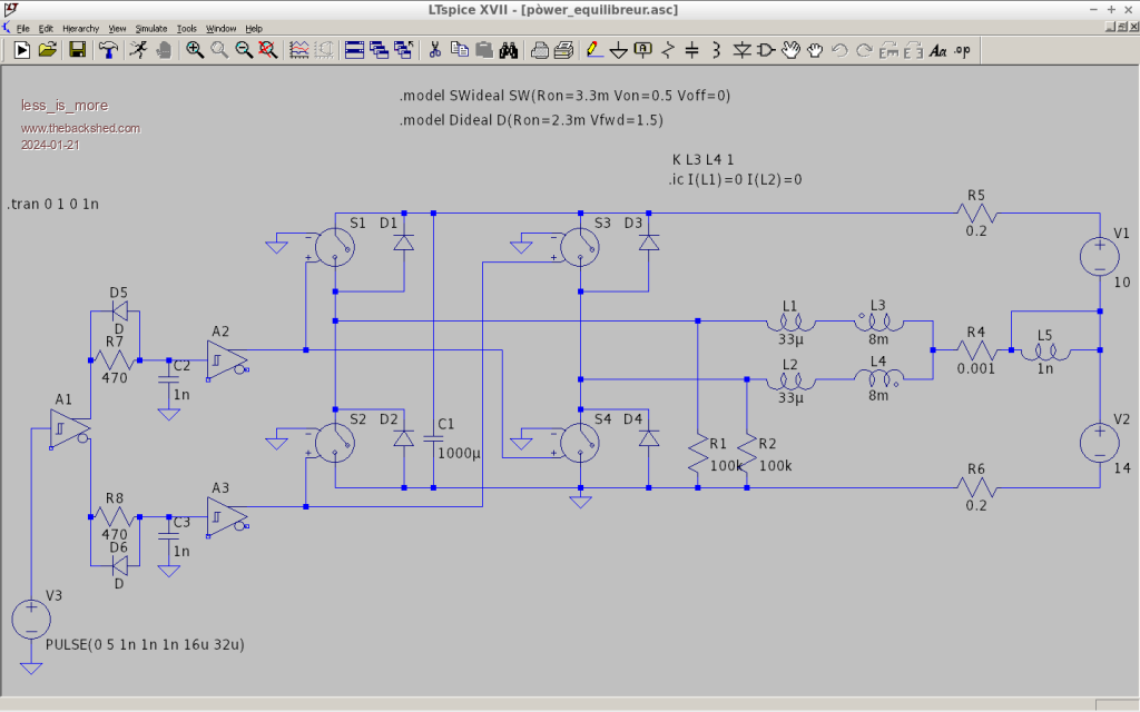

Posts: 3422
Posted: 07:32am 30 Oct 2023
Taking Wiseguy's idea and circuit diagram the boost converter can be merged with the charge limiter.
Positive AC feedback makes it oscillate when the battery voltage reaches the setpoint. The current limit now sets the peak inductor current so will need to be increased for the same average current.
The values of L1, C1, R8 and R9 need to be determined by simulation / experimenting.
Too much AC feedback may keep it oscillating when the battery voltage falls.

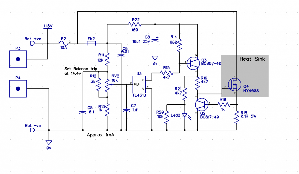

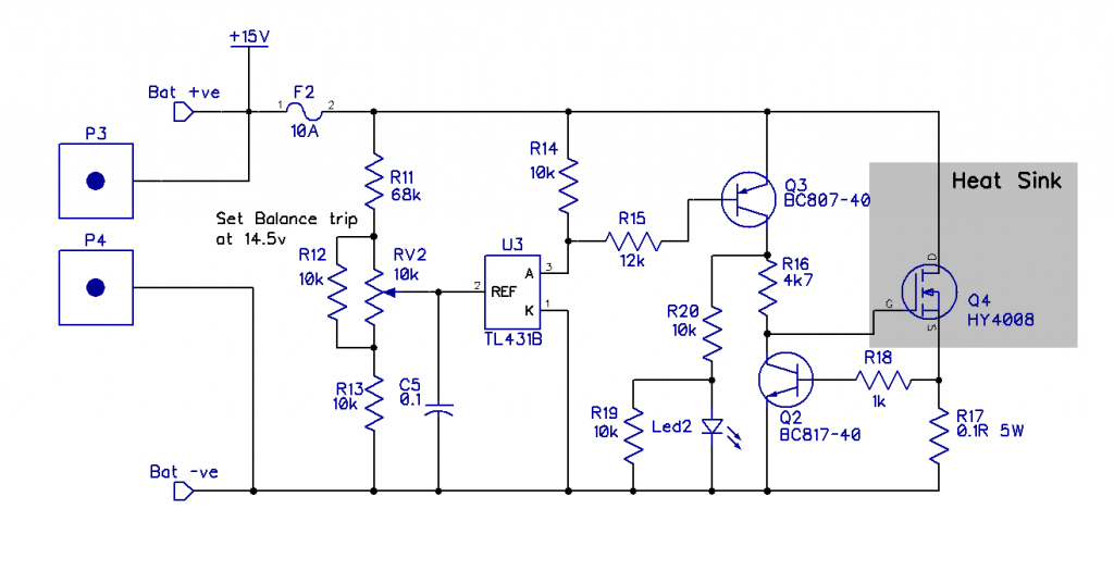

Posted: 01:12am 31 Oct 2023
I don't have any time also to work on an active flyback or similar load, need to get something basic built first.

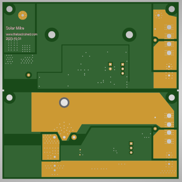

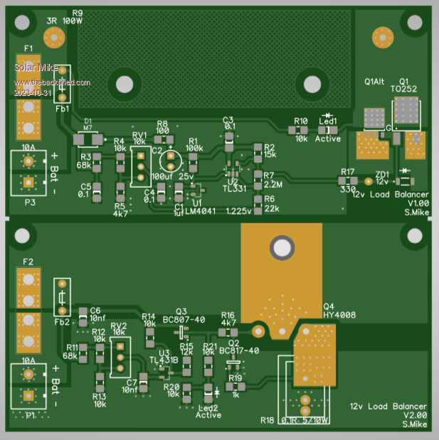

Here is my take on the proposed circuit using the TL431, delving into my parts bin, have several of the 3 pin smd versions and same with some NPN/PNP small signal transistors.
Will make a 100x100 pcb with both versions on it to test.
Mike
wiseguy
Joined: 21/06/2018
Posts: 1336
Posted: 02:27am 31 Oct 2023
Looks like it should work to me. My calculations says adjustment range is a bit high ~ 13.8 - 20.7V trivial change to lower..... Other comment not sure how well the LED will work might, need reduction of R20 value to improve illumination.
Edited 2023-10-31 12:30 by wiseguy
Cheers Mike
Solar Mike
Joined: 08/02/2015
Posts: 1255

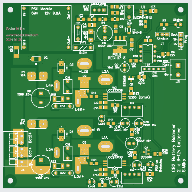

Posted: 05:16am 31 Oct 2023
  wiseguy said   Other comment not sure how well the LED will work might, need reduction of R20 value to improve illumination.
Super bright smd leds, 1mA current and they are too bright to look at. (R20 now R21)
Here are the PCB layout for both versions, each is 100 x 50mm on a single board, when made 1.2mm thick, easily cut with a craft knife, then snapped in half. There maybe a couple of bypass caps and a ferrite bead on the pcb, not shown in the schematic.
For the heat sink, intended to bolt the mosfet \ 100W resistor to a piece of 3mm alloy plate bolted to top of the pcb, perhaps with a 50mm fan for testing; see which version works the best, then do another Ver3.
Top:
Bottom:
Gerbers:
12Volt_BalModule.zip
Mike
