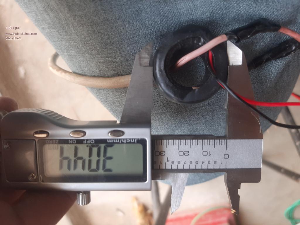

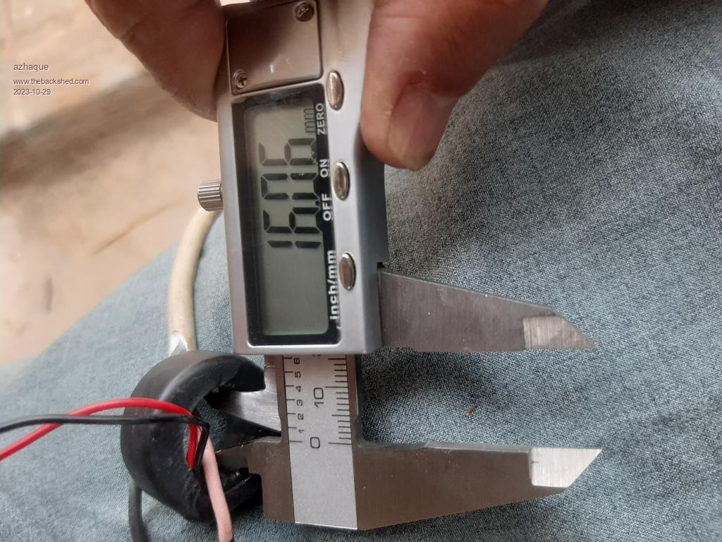

Just to take the discussion a step fwd here are the pics of the ct
The inner and outer dias. of the ct are 16 and 30 mm respectively.
A supplementary question is what kind of a rectifier bridge should be used. A silicon based one will have a cumulative voltage drop of around 1.5 volts. How do I iron out this drop in the software.

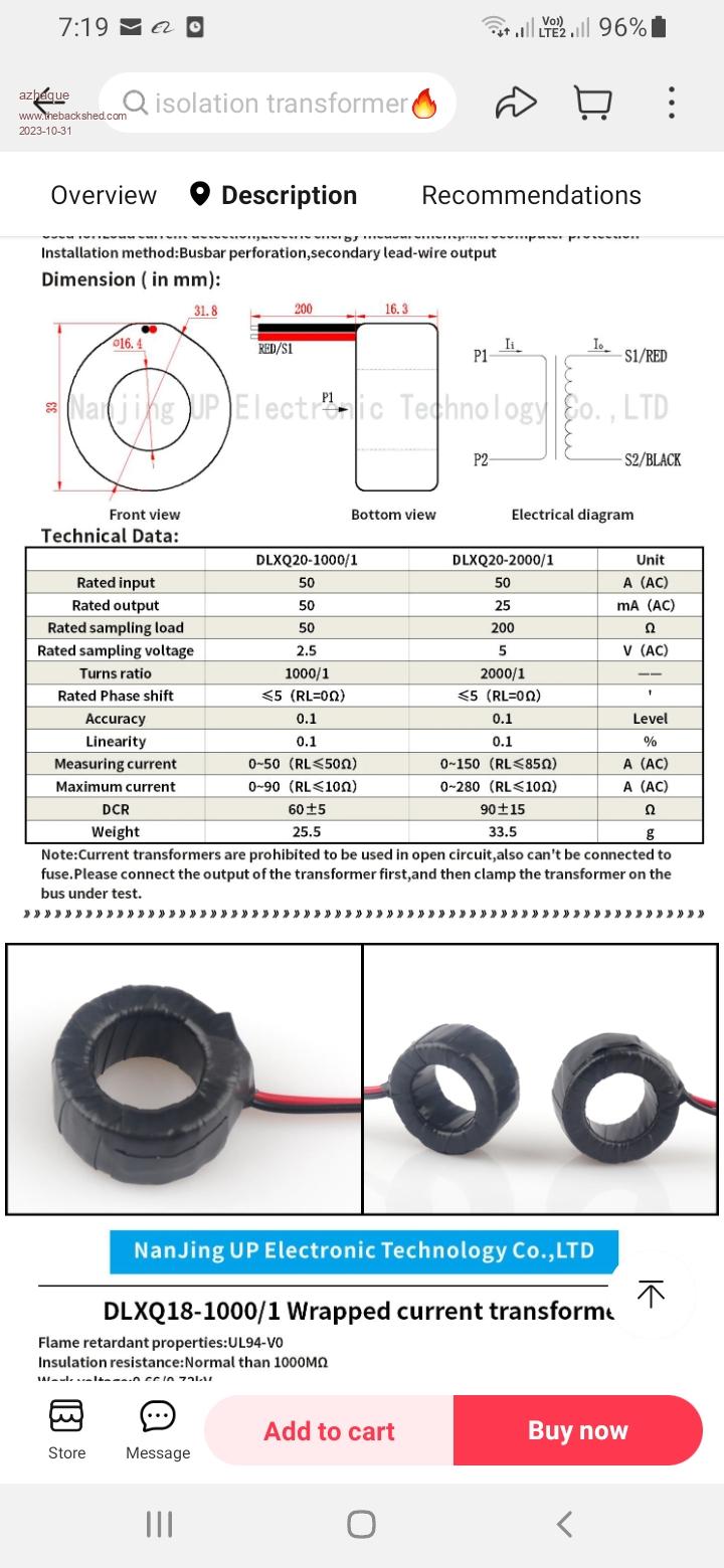

As suggested, scouring the Net I believe I have found the exact data (God bless Aliexpress and China- Pakistan free trade agreement) for the CT.
The sizes and the internal impedance match.
As per the datasheet the burden resistor should be 50 ohms with 50A/50mA ratio. It will develop 2.5 volts across the burden, which is slightly on the lower side. Full wave rectification should output 2.5*1.4=3.5v peak which isn't too bad for a 4x1N4004 type bridge. The u-controller should be able to read the values comfortably with adequate resolution.
Thanks again guys.
