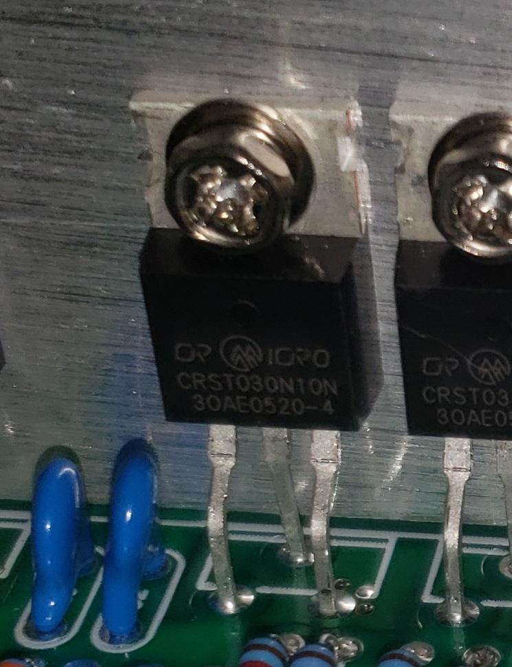

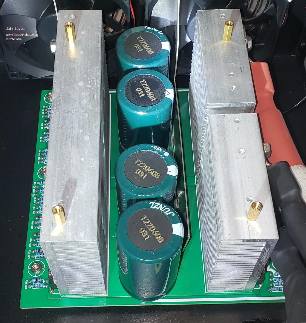

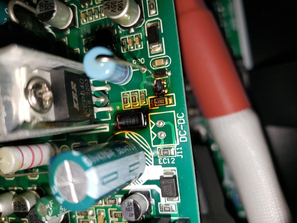

I opened up the inverter. The capacitors look ok physically. The inverter also maintained 25V after I disconnected power. However, normally my resistor gets very hot when I use it to drain or charge the capacitors. This time I was able to hold the resistor without having to disconnect every second to let it cool.
I attempted to measure the capacitance and got a 0 reading when I used my cheap multimeter across the battery inputs. Maybe I need to disconnect things before attempting to check the capacitors? Maybe my multimeter is not capable of measuring large values? I tried it on a small cap I had lying around and it produced the correct value.
Is it possible that the capacitors are OK and something else failed to cause the DC current to oscillate at 60hz? My problem is that the DC amps are oscillating from 0 to 2x the expected current when the inverter is on and either charging or inverting regardless of the load.
I uploaded a photo of the only components that look discolored on the control board.
I included photos of the capacitors and the fets in the hopes that someone might tell me if these are decent quality or not.

John it may be a trick of the light but in your second photo there looks like heat related damage to some components just above where it says DC-DC.
one component looks like a mosfet driver transistor the other one has something like 101 written on it. I would suggest looking carefully there for damaged components
Good pictures, re the quality of capacitors and FETs, it's not possible to know as forgeries are so good these days.  But the main capacitors show no typical signs of degradation and the main FETs don't look stressed either.
The "discoloured" parts on the control board appear to be the real problem, I am confident there is more going on there than just discolouration - I would expect that some of those bits (and maybe others that may or may not be so obvious) need replacing as they are now faulty/broken.
Good luck in your endeavours to fix it, finding a schematic will probably be the hardest part, finding another unit and reading off the parts might be easiest or and reverse engineering the schematic to help understand why it failed and what else may be faulty!

A picture is worth a thousand words so Ampinvt won't be able to dismiss you again if you email the photo of the burnt bits to Ampinvt Tech. Support and request a circuit diagram and any other relevant servicing info they may have.
Even if they regard the complete circuit as proprietary IP a reputable company would provide enough information to repair it.
If it is still in warranty get them to repair / replace it.

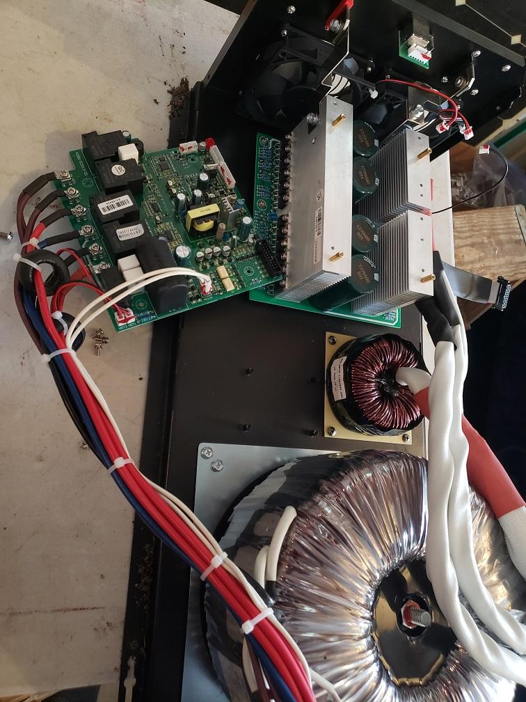

I figure the loose board in the photo below is called the control board, and the one with the fets, caps, and heatsink is the power board. The control board has the failed components and Ampinvt has seen the image of that, and immediately asked for my address and sales info. They are sending something to fix this. I am not sure what they are sending.
(I assume it will be the control board. But if I wasn't eager to open this and find bad parts, I don't think I would have managed to convince them it was bad. But if they had comprehended what I was saying about the DC current, what were they going to do? Would I have to ship this heavy thing back for them to fix? Because I opened it, are they now OK sending me the board to replace? I am just thinking out loud.)
Anyway, back to my real question. I see two different types of chinese inverter boards. One has no power components, so I figure it is the egs002 based control board. The other solutions have the heatsinks, fets, and caps, and also that egs002 control board sticking up.
Are you saying you'd swap out both the control and the power boards (I apologize if I am not using the correct name for these two)? Or maybe just the control?

  JohnTaves said  Anyway, back to my real question. I see two different types of chinese inverter boards. One has no power components, so I figure it is the egs002 based control board. The other solutions have the heatsinks, fets, and caps, and also that egs002 control board sticking up.
correct, swap both power and control boards out and reuse the choke and trans. the chinese boards also power on with a closed contact like you want (open = off, closed = on)
if you want to get adventurous, you could make your own board to adapt the egs002 to your ampinvt power board instead of using the chinese power board. take a look at the EG8010 datasheet, the chinese boards are basically direct copy of the application schematic. minimally all the egs002 module really needs is 5V, 12V power supply and an AC feedback circuit for the Vfb pin. you would have to find out the pinout to your power board to match the gate signals to the egs002
