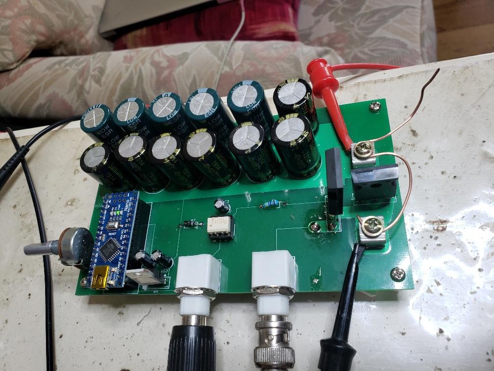

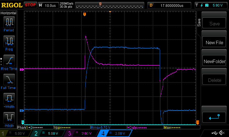

I made a more proper inductor tester.
looks like this:
I felt it time to make a better one.
One BNC is the pulse, 0-5V, taken from the Nano.
The other BNC is the voltage across the current sense resistor.
It uses a nice 0.02R shunt resistor for current sensing.

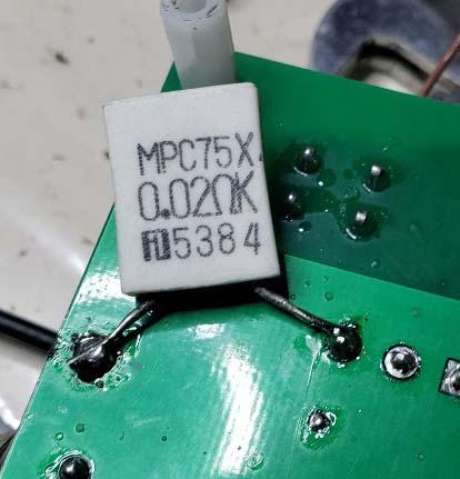

I first tried a simple 1mm diameter copper wire, about 50mm long
as the current sense but it has a strong temperature coefficient
so it's resistance increases as it warms up.
so I used this instead:
It works fine, getting a good trace of the inductor current.
But I am interested in how this thing works.

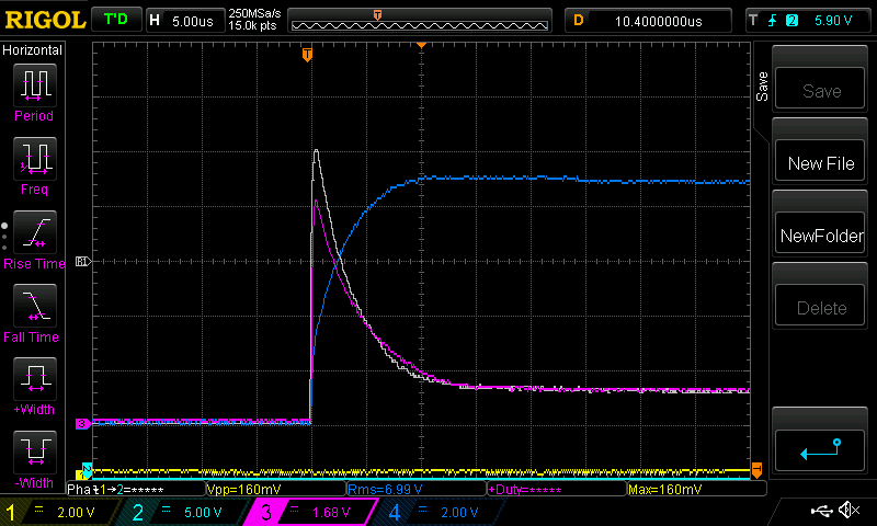

what woud happen if I used a 45mm long length of mm diameter copper
as the "inductor".
We see this:
Blue is voltage across the 0.02R current sense.
Pink is voltage across the copper wire.
(The 0.02R resistor is in fact 0.0193 Ohms, after calibration.
That 9V across it corresponds to 466 Amps!)
I believe we can see the high resistance of the copper wire
at the early stages of the pulse, and then it settles to a constant
about 10uS. This seems to show to me the skin effect.
The pulse sees a higher resistance initially then after 10-20uS it becomes
a solid 1mm diameter copper wire.

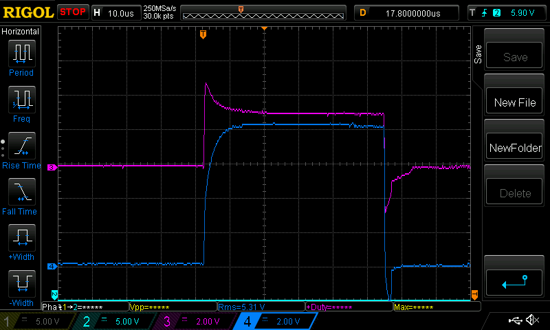

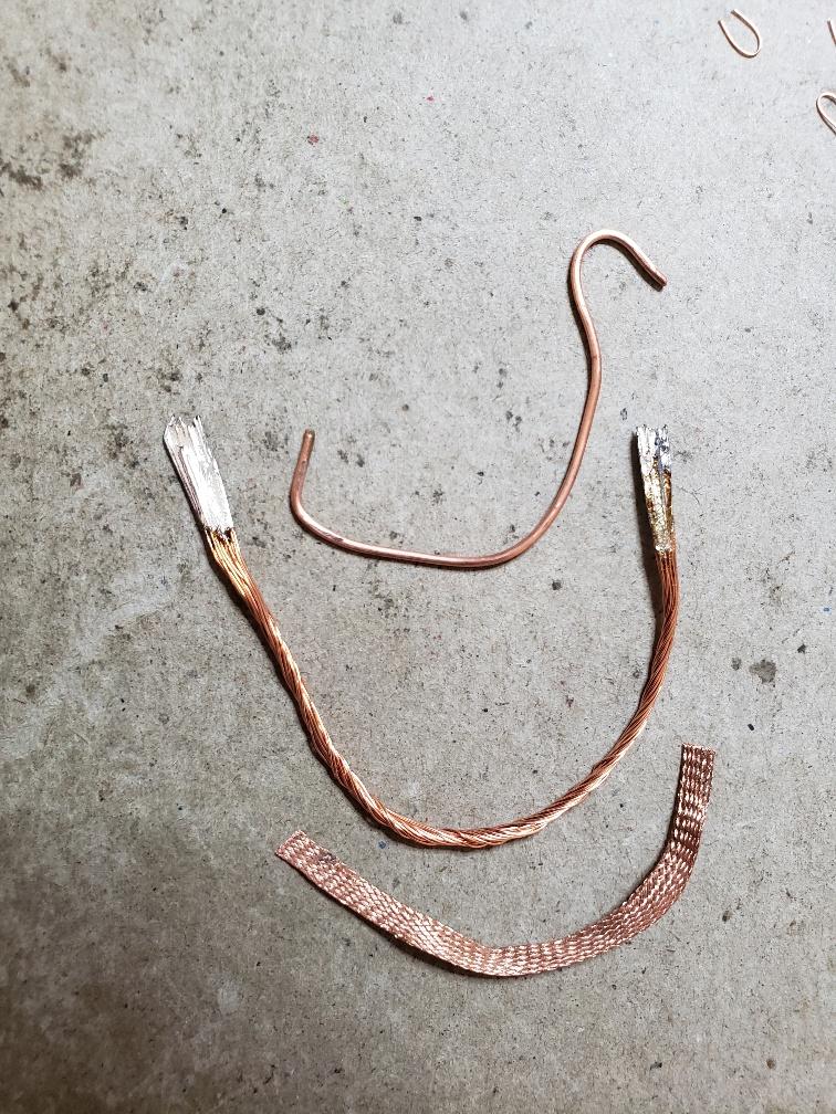

I do not have Litz wire but I do have some copper desoldering braid
When tested it looks like this:
We can see a much smaller peak voltage across the wire compared with the
1mm solid wire.
I always wanted to SEE the results of skin effect
in a conductor. It's one thing to read about it in theory but another thing
to see it in real world tests.

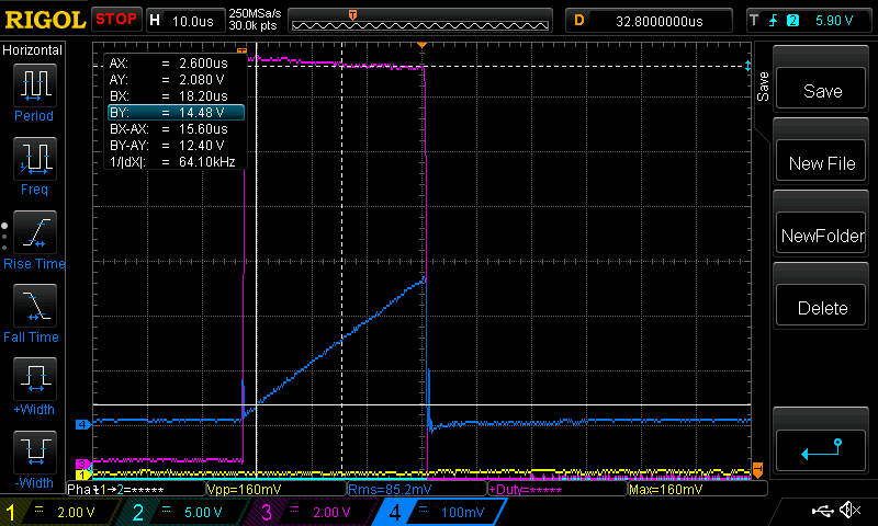

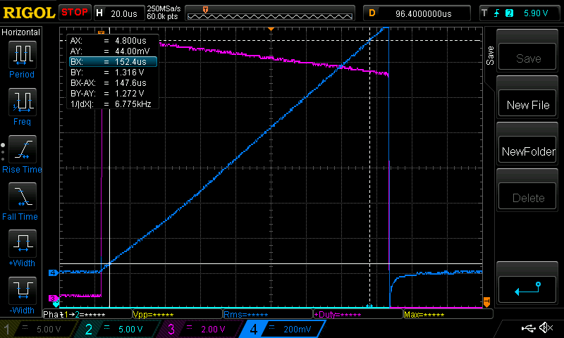

here is a 38.9 uH choke (as measured by the LCR meter)
147uS pulse width, the current rises a total of
1.272V on the 0.0193R shunt = 66 Amps
Test voltage is 15V but the Blue trace, the voltage across the choke,
shows it drops about 2 volts during the pulse. So I average it out to
14V test voltage.
L = t.V/A
or 147 uS x 14V / 66 which is 31 uH
Not real close but the current trace looks lovely and straight.

here is the same 38.9 uH choke (using 7 turns with a TDK ferrite E core)
but looking at the first 30 uS of the pulse.
36.6us
0.282V on the current sense
14.5V across the choke at the mid point of the pulse
(and 0.0193V/Amp for the current sense)
14.6 Amps
L = 36.6us x 14.5V / 14.6 Amps = 36.3 uH
that's a bit better. Maybe the ferrite core is non-linear?
Edited 2024-01-09 21:31 by poida

I made my own Litz wire, using 0.25mm diameter magnet wire, which has a thin
lacquer coating.
here is the 1mm solid copper, the home made 16 strand Litz
and the length of desoldering braid I used.
One fibre of the desoldering braid is 0.002" or 0.051mm in diameter.

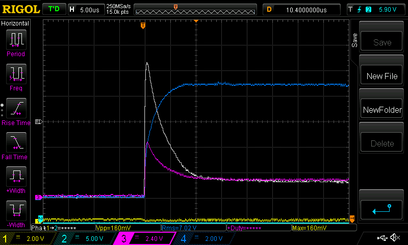

back to the choke tester and we see the home made Litz compared with
the 1mm solid. I changed the vertical gain to make both curves line up
after about 50 us. I had to do this since the length of the 3 test pieces
are all different.
The Blue curve is voltage across the 0.02R current sense.
All tests showed current levels of around 450 Amps from about 40us onward.
The White curve is 1mm solid, the Purple is the 16 strand home brew.
You can see a reduced peak voltage and the peak is flattened a bit.
This means the resistance of the 16 strand wire is a little lower
during the early part of the pulse.
this is what the desoldering braid look like:
this is a huge difference.

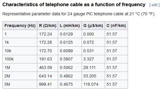

I saw this on the wikipedia page on skin effect
This shows resistance of 0.51mm diameter copper wire
as a function of frequency.
Once you get to 1MHz you will see it's nearly 3 times higher resistance
I often see evidence of frequencies well over 1Mhz in the inverter
and charge controller switching. The ringing during crossover is usually
something like 1-5MHz

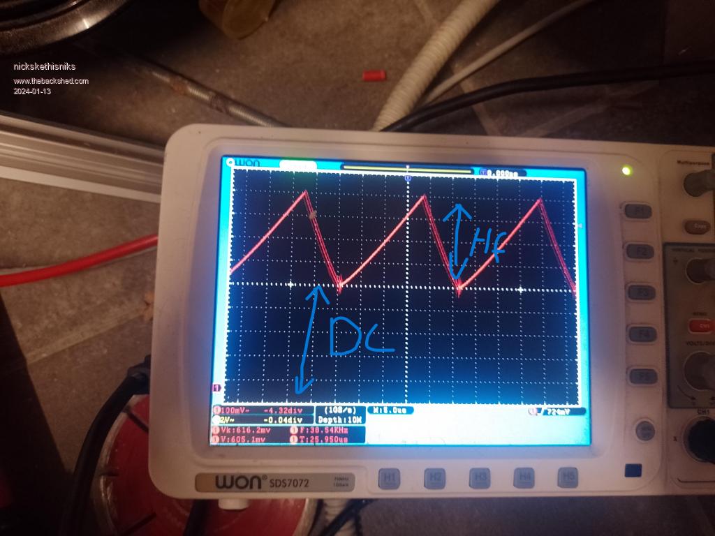

Something else to point out for those that don't know yet, the current in the inductor has 2 components DC+AC, the skin effect is only present in the ac component. The higher the inductance, the lower the ac component.
Typical current waveform of the inductor: (100mV equals 1A)
You can get away with solid wires you might think, but when using gapped cores something else gets introduced, "fringing".
