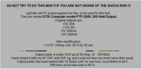

I had a SMPSU from an old PC. this was 200W with a tl494 PWM. I was able to find website power supply mods and this gives some instructions on mods to use as radio power supply, 13.6V output.
This used a model ptp-2008 cct design, of which I had the same.
I read a bit further and decided not to go further, when the important value 60% efficiency at max output came to light. Seems a lot of power goes to waste. Approx 100W wasted to give 200W output.
Here is the text.

do you think that’s normal efficiency for an ATX, or due to the mods done on it? ie; unbalanced output. I modded a recent ATX for 48V output, but didn't check before & after efficiency.

I was told once on this forum that these units were efficient. There were claims of modded units better than 95%. This guy has made some measurements and come up with 60%. I cannot confirm these numbers. Mods will affect efficiency. Maybe VA was measured on the input and the power factor was not 1.
