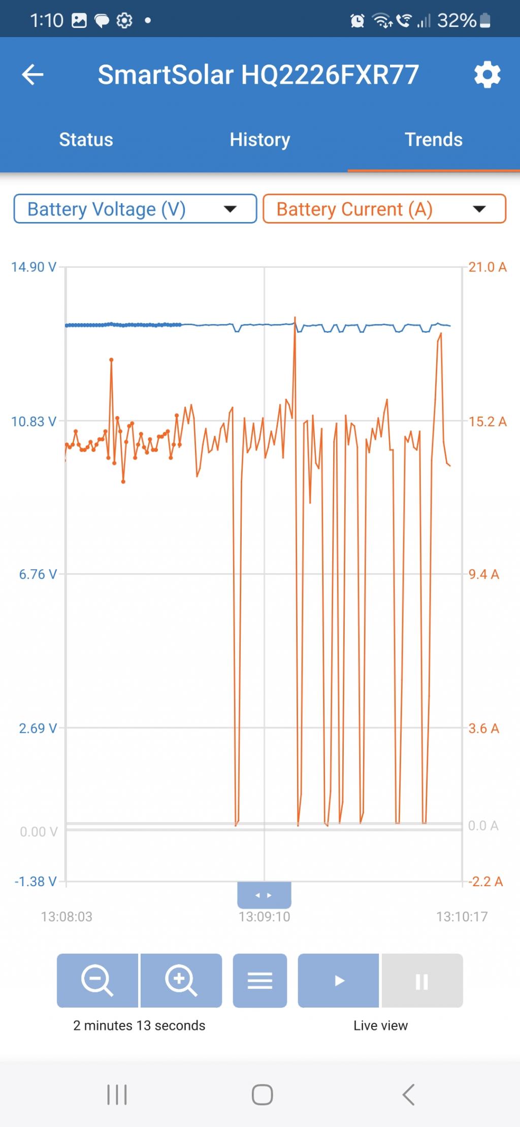

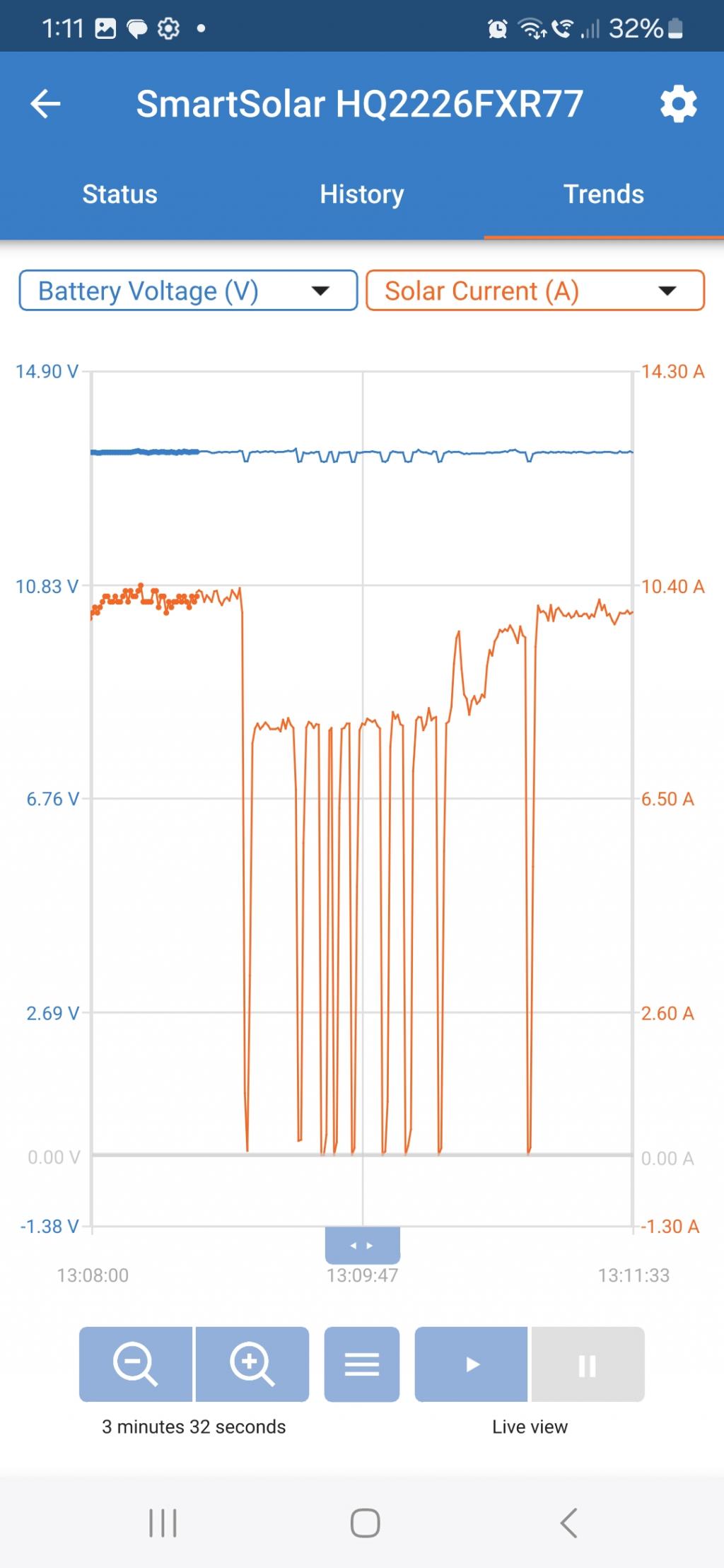

Victron provide an app for the phone. It shows input and output volts, Amps etc.
the first screenshot shows input current. it was at 12A, which was maxing out the 200W output
This was the PS constant current output limit, 12A
I then increased the CC limit to 20A and we see the mppt scanning
seeing there is too much, shunting it (and showing what IT thinks is input current
when shunted, but it's wrong. It's measured AFTER the shunt, on the battery output)
Then I reduce PS current to 12A and the mppt scans, sees output is 15A or less and
gets back to work.
The second image shows output (to battery) current (the device has a max of 15A)
during the above tests.
The power supply shows about 20A output when the CC limit is set to 20A
and this was when the mppt said it was pulling 8A (in first image)
what a piece of crap.

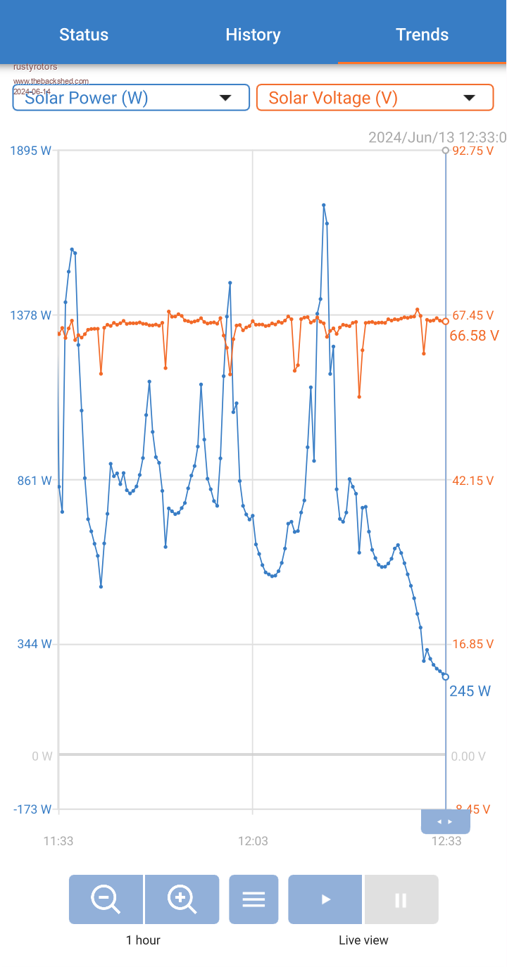

Is this a 'working' unit? I didn't observe the input being shorted (once I'd removed the two shorted fets (one each high side and low side)) on the 250/100 i tried to repair: obviously,  it would pull the pv input down to b+ during the mppt scan, but not to ground.
Having said that, i was only watching the digital meters on the bench psu, and if it shorted very briefly they wouldn't necessarily show <b+, and i might not have noticed if they did as i wasn't looking for that.
To be fair i thought the mppt scan algorithm worked ok and it did find the sharp 'knee' of the bench psu current limit fairly quickly, and i liked the fact that it could put 30A into a 12v battery with no heatsink without getting detectably warm. But i am still slightly  paranoid that i triggered some sort of deliberate self destruct mechanism by trying to fix it
Edited 2024-06-14 03:35 by mab1

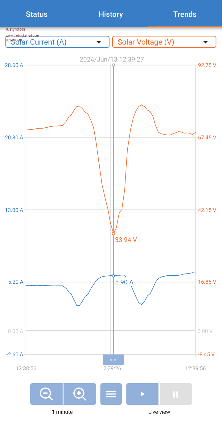

rustyrotors
Joined: 07/01/2023
Posts: 36
Posted: 10:55pm 13 Jun 2024
Yea i noticed the mppt resets every 10min, probably in case it gets stuck in a local maximum. Here are shots from my 150/100 at 24v battery, it doesnt short either. I think poida is seeing a different problem
