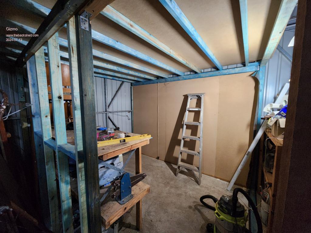

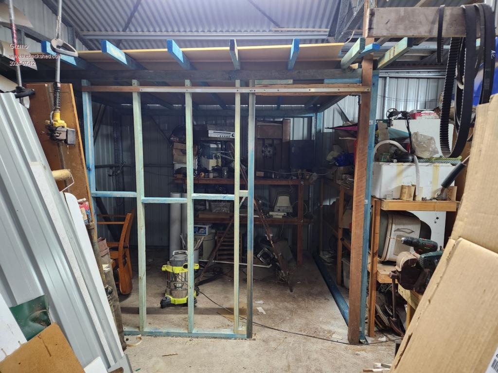

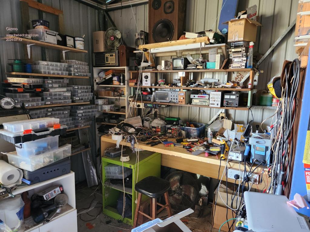

Hi Guys
Building a new electronics workshop room. Currently my workbench is in a corner of my shed. Its dusty, and it gets very hot in summer. Also its a mess, because its cramped and I use the bench for other ( car ) projects.
So building a dedicated electronics room in the shed. It will double as storage space above the room. Its going to be lined, insulated and air conditioned, Lots of power points and lighting, plus I'll paint the walls white to brighten it up.
So looking for suggestion on the work bench. It will be 3 meters long, down the far wall. The rest of the room is for shelving and cable hangers.
My current bench is high enough for a stool seat, or to stand at for quick jobs. Thats what I'm used to. But should I go for a table height, and use a office chair?
Maybe I can have two levels, a bench and a table.
The dept from front to back, currently using 850mm, but tempted to increase that to 950mm. The shelves for the test gear above the bench need to be 400mm deep to fit some of my larger test gear, a bit of overhang I need to allow for.
What do others find work for them?

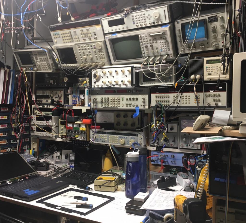

Not that I have an opinion but...
Don't make the same mistakes others have made. The bench should be easy to use and all displays should be easy to read.
Bench height. Here in the US, tables are 30" (76cm) tall. I found after decades of putting in benches where I have lived that this is to low. Even for computer desks this is to low for many reasons. I would suggest about 33" (about 84cm). Once you start working on boards on a shorter bench, you may find your neck and back getting sore or you will be spending too much time looking down. You may also want to make a simple table about 15cm tall, about 35cm wide and about 20cm deep (depending on what you work on), with enough weight so it does not slide around while you work on it. There will be times you want to look at boards really close like probing and soldering SMD.  Having a distinct second bench setup differently will make a lot of sense, even if it sits right next to the main bench.
Bench depth.  It should be between 37" (94cm) and 38" (97cm). 37cm might turn out to be the best size. It is based on the ability to reach the test equipment controls when sitting down.
Bench length. Longer is usually better, but two things happen with long benches. Stuff gets too far away to reach and you need to slide the chair around to get to things. Also stuff tends to collect in the less used part of the bench which, over time, will begin to encroach on your normal work area. My current bench is about 154cm wide. It could be a little wider but test equipment begins to get too far away to reach when sitting down.

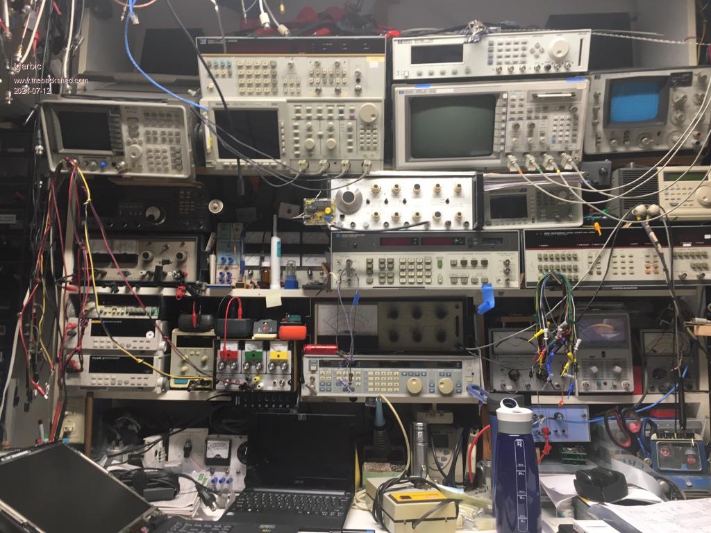

Shelves.  You will want to design around the equipment you use. I have a lot of scopes and HP equipment. You will also want no test equipment sitting on the bench as this becomes a problem with stuff bumping it or inability to attach wires/probes or reach knobs/buttons. It also keeps stuff that tends to migrate to the back of the bench from collecting around the test equipment. Additionally it allow some room to shove your soldering or desoldering station back out of the way and easy pullout when you need it. The area under the first shelf, on the bench, could hold some storage boxes or fixtures like resistive loads or test speakers.  Nothing should be mounted to the bench but rather mounted to the far left or right bottom of the first shelf. You should be able to easily remove everything sitting on the bench to clean it.
I designed my bench to allow me to sit at the middle of the bench and reach all the test equipment controls, I succeeded for about 95% of the equipment. I have to stand for some of the analyser top controls on the top shelf right corner.
I have three shelves. First shelf is most used equipment. Since I have an analog VOM, it is directly in front of me to remove most reading errors. Some equipment at the edges are turned slightly to point more toward me for a direct view. Much less used analog meters are sitting at this level but off to the right.
Second shelf up is the rest of the commonly used equipment. Since the shelf distance is further away, I put longer equipment on this shelf, and anything shorter is set to stick out as far as the longer equipment. I can reach all of this without getting up or moving my chair.
Third shelf is different. I have all the rest of the long equipment there, such as oscilloscopes and spectrum analyzers. The long HP signal generator and frequency counter sit on top of the scopes. The shelf is angled down so when I am sitting in the chair, I am looking directly at the face of the scopes. They are easy to reach, don't experience glare from the overhead lights and allow standard probe lengths to reach anything on my bench. The shelf is re-enforced down the middle to make sure it does not bow under the weight. The shelf is also only 33cm deep allowing the test equipment to sit on it without needing or using the feet. The feet hang over the back and there are heavy wire attached to the back of the equipment that raps under the shelf and around screw shanks sticking down under the shelf. Very secure but easy to remove. I have a 2X6 outlet strip screwed under the back of the shelf to plug the test equipment power into (lots of room at the back bottom of the third shelf.
The bench and shelves are about 3cm from the wall to allow backs of equipment to hang over and provide room for cords and cables.

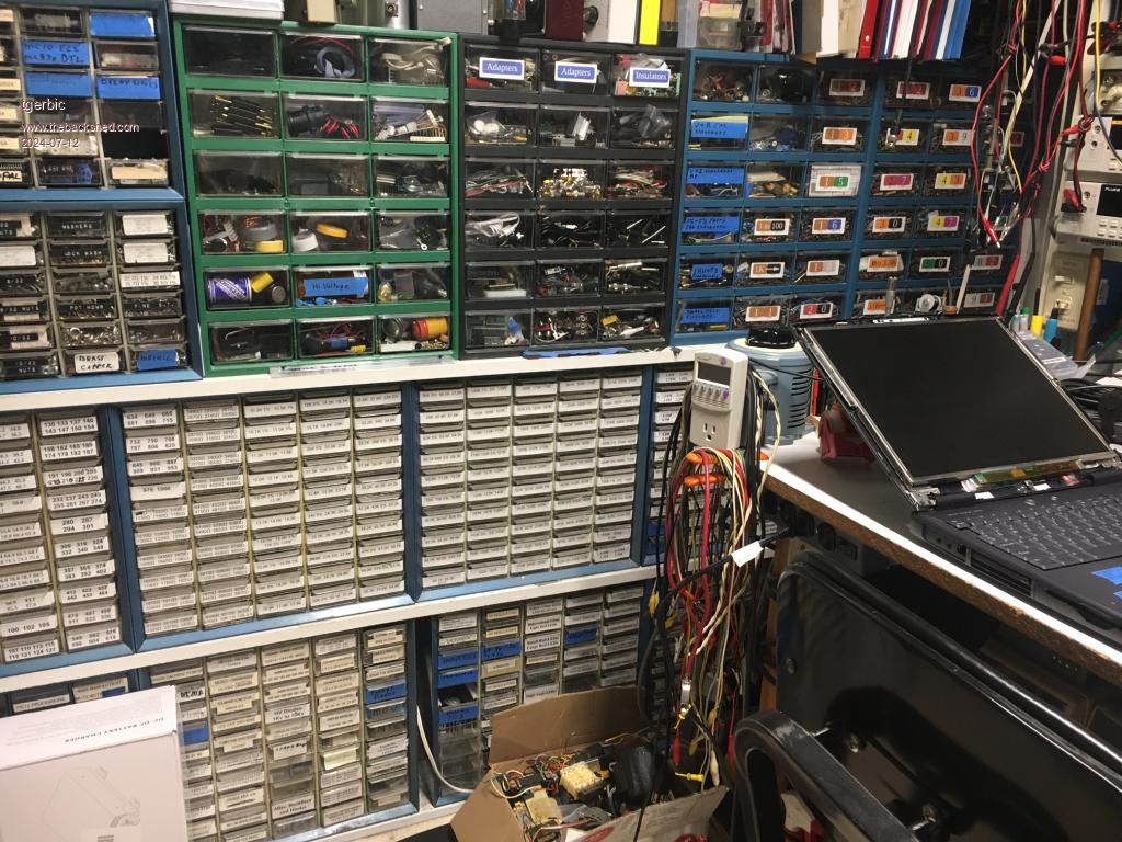

I would also advise you line the left wall with 50 drawer cabinets three layers deep from the ground up (on a thick bottom board so you can sweep the floor and nothing will roll under). You should be able to reach resistor, caps, semis and transistors just by swiveling to the left and opening a drawer. I have seen too many people have to get up and hunt through miscellaneous boxes to find parts. What a waste of time and energy.

Here are some quick pictures of my messy bench. Note the slanted top shelf.
View while sitting down.
What you cannot see above in this picture are ~4cm X 4cm boards sticking out horizontally from the top of the shelf vertical boards that stick up almost to the ceiling. There are three of these. I have horizontal dowel pins about 15mm diameter going between them with spools of wire. If I need some red 20G wire or some yellow #26 wire, I can get up and just pull down off the spool and cut a piece. This keeps me from needing a box or drawer to store spools of wire in. It is a good use for the space above the bench near the ceiling that normally would not get used.
Convenient to reach storage. I pull out parts as I build things. Note the variac and watt/volt meter on the left corner of bench. Further down the bench leg is the switched isolated AC socket. Sometimes you really need an isolation transformer.
In all fairness I do have a 250cm closet filled with parts boxes to the right with things well organized for larger parts like connectors, pots, gang switches, memory simms, large capacitors, packages of ICs, etc., but I need to pull from them less often.  Your situation will probably be different but getting organized up front makes the rest of the hobby enjoyable.

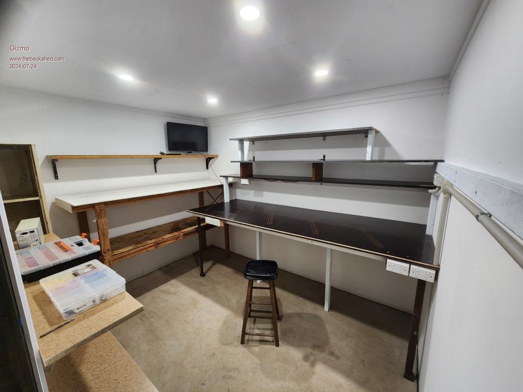

Posted: 05:47am 24 Jul 2024
Finished at last, more or less.
Still need to add a few shelves, and touch up some of the paint where I stuffed up in places. Where possible I used timber I had lying around. The bench is 18mm form ply, very tough but a black slippery finish and difficult to paint, so black it is.
Now I can move in

Posted: 06:05am 24 Jul 2024
Wow, great job Glenn. Bit of a difference to the first photos.
Good luck with working out where everything goes now.
