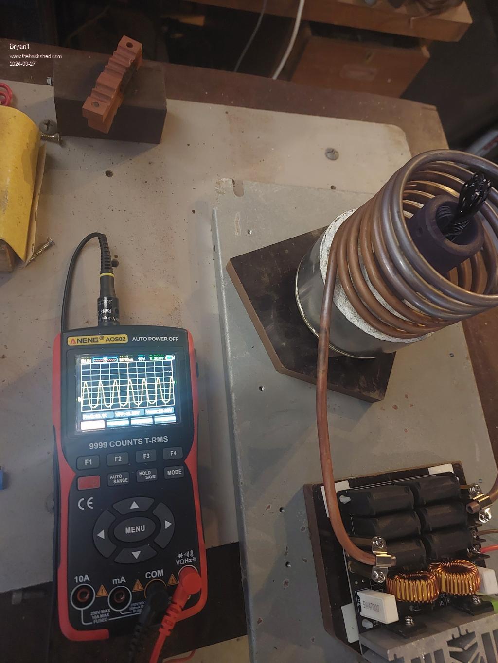

G'day Guy's,
            Well I got this Temu induction heater for $49 just to have a play,   Now the supplied coil was under 40mm internal diameter and just too small so I first made a 4" diameter coil then changed it to a 3" diameter coil.
I used a an old machining project as the crucible and found it only get to around 460C and stays there. Did some quick research and soon found the circuit so upgrading this is going to be needed.
Now with crucible in it was drawing around 340 watts and I do think we need to get around 1Kw to get the crucible over 1000C to melt copper.

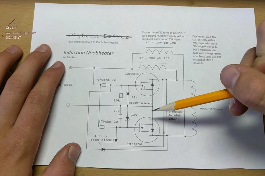

This is the circuit and I do have a heap of HY5608 fets and looking at those small chokes from the aerosharp they are 0.5 mH for the caps ordered 20 of those to use as the cap bank.
Here is a pic of the setup

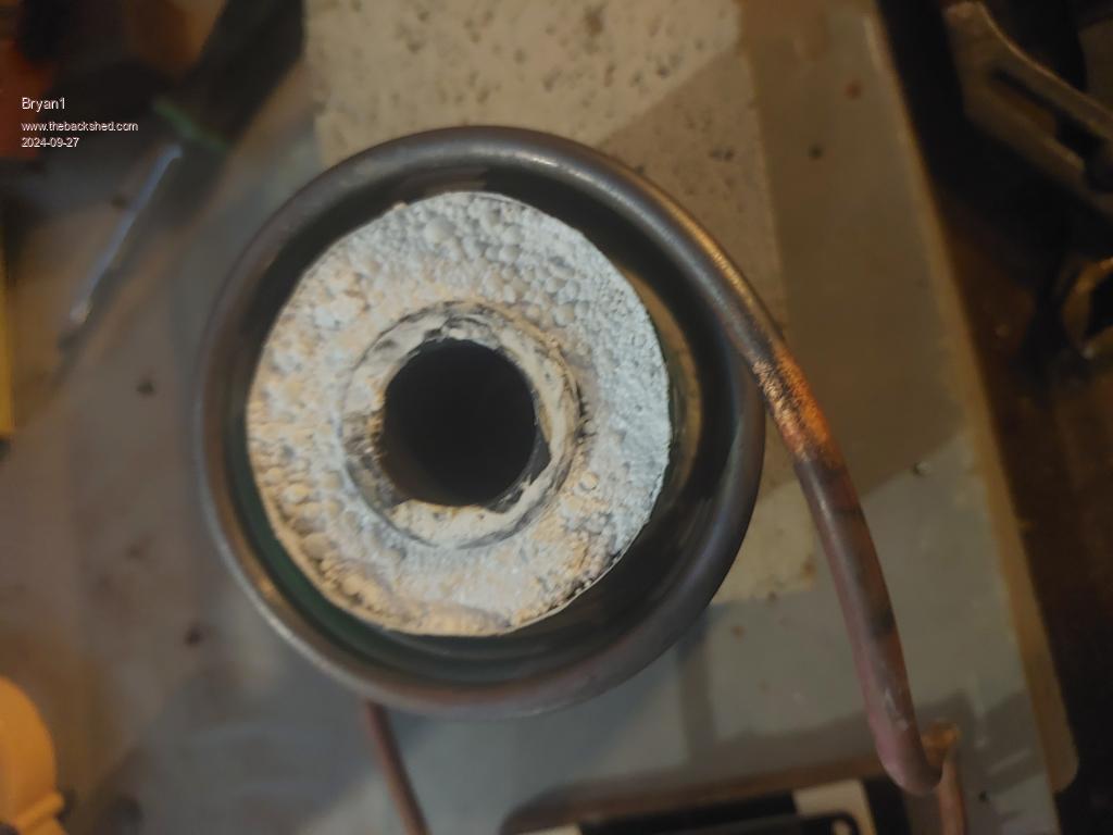

I have found any metal below the coil so I cast some refractory cement into a tin can and with this morning trial the tin is heating up so I'll take the can off and just have the refractory block. So the heatsink issue can be fixed.
I did look at this many years ago and guy's were doing the same thing as the ZVS oscillator is the electric version of a small forge.
Regards Bryan

Posted: 04:12am 27 Sep 2024
Insulating the crucible may be all you need to do.
Cast a refractory cement cylinder to fit between the coil and the crucible.
Make formers from thin cardboard or stiff paper wrapped loosely around the crucible and inside the coil.
Mix the cement with plenty of sawdust. When the sawdust burns out it leaves voids that improve the insulation.
As you have already observed keep it well away from metal when running by sitting it on a brick or cement block.
When trying to melt wire rather than a solid lump you may need to improve the RF coupling by winding it into a multi layer coil with the turns parallel to the drive coil, and the ends twisted together.

Hi Phil thanks for that tip on insulating the crucible and I did find a Coopers Lager beer can was just the right size for a former so the refractory cement cast is done. I just put a 5/8" nut under the crucible to raise it and tomorrow when it's done I'll peel off the can and get the crucible out. Also I put some sawdust in as per your suggestion and I found a brick the right height to sit under the coil.
I did try everything I know to get that 20x4 LCD working on that RP2040 Zero but everytime it came back with the error of the LCD not open did my head in so a change of tack was needed. I was surprised just how quick those RP2040camera boards got processed and they have shipped already.
Now I do have 1.5Kg of tin coated copper from an old job I did where I kept the billets from punching holes in an ironworker so I'll have to come up with an idea for a bronze project when this unit does it's job.

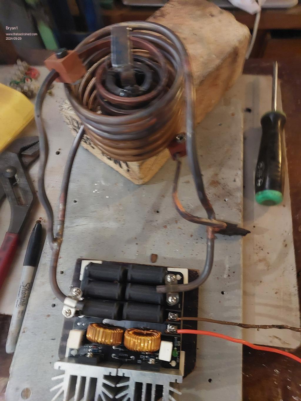

G'Day Guy's, Well took Phils suggestion and made another coil to sit inside the copper coil. Silver brazed the connections and gave it a run.
Well the 15 amp fuse popped so put a 30 amp fuse and that one popped so put another 30 amp fuse and used my clamp meter and 64 amps was being drawn. The 30 amp fuse soon popped so found a 63 amp fuse   Not thinking on the size of the wire about 5 minutes into the run lets just say the cable let out the magic smoke and lots of it   So cut the negative wire coming from my shed battery and looks like I'm going to have to move it closer to the battery due to the current drawn.
I welded on a handle so the crucible can placed and removed easily. Now with these duel coils I'm thinking it may be too much for this Temu board so when I get back from holidays I can on making the new heavier duty one.

Posts: 3421
Posted: 03:47am 29 Sep 2024
It seems I failed to explain properly what I meant.
I the photo the copper you wanted to melt in the crucible was bunched up vertically. That will absorb the RF energy poorly, So wind it into a coil (with the ends shorted) that just fits in the crucible with the turns parallel to the RF coil.
Having two RF coils in parallel is obviously overloading the oscillator.
Put the refractory cement insulator you made between the crucible and the original coil.

Well may as bring this project back as I knew that first pic would give me the schematic in the future when I needed it
Now going off that first schematic all I need to buy in is the 470 ohm 2 watt resitors and the 12 volt 1 amp zener diodes.
Wire it up the old school way so no waiting for a circuit board to clear customs
Just get the parts and make it as the inductors are the big part and that powdered iron core choke I made this morning does need a mate.

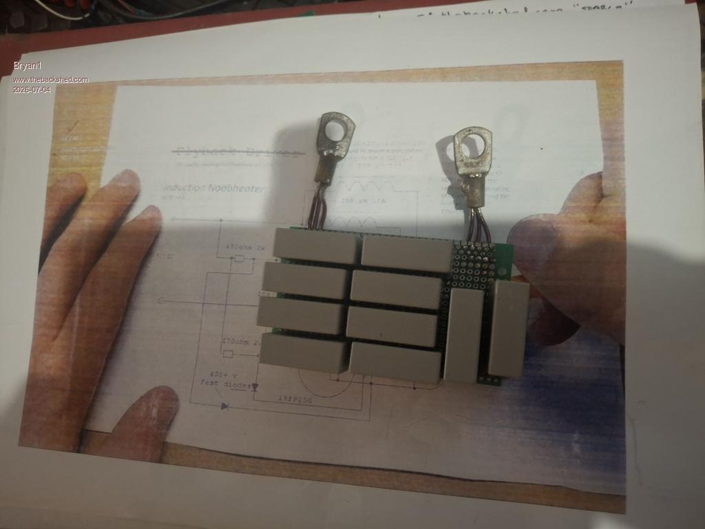

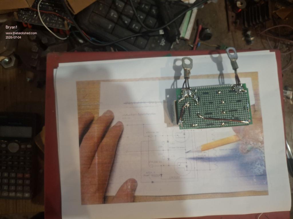

Well had a bit of fun this morning and got the cap board made
Now as I bought 0.47uf caps put 10 in series to get 0.047uf so thats one job done and as my daughters are coming over soon thats end of the fun.

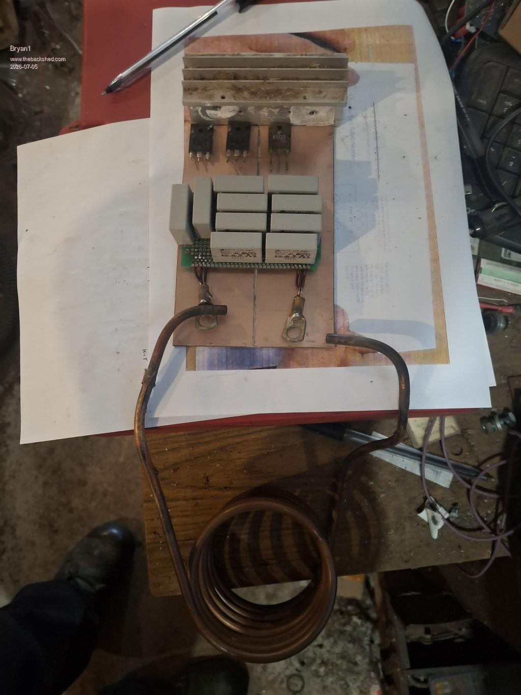

Well got a bit more done this morning and later I'll do an Altronics order to get the 5 watt 12 volt zeners and 5 watt 470ohm resistors. Also I'll get the headers and limit switches for the Surface Grinder project and other gear.
Here is the mock up
As I do have some of those STTH6002C dual diodes I'll use them along with some HY5608 mosfets.
The pcb is dual sided so the negative rail will be on C1 along with positive rail on C2 so plenty of copper to handle the power. The main connection will be a 8mm bolt to hold everything together.
So getting there.....

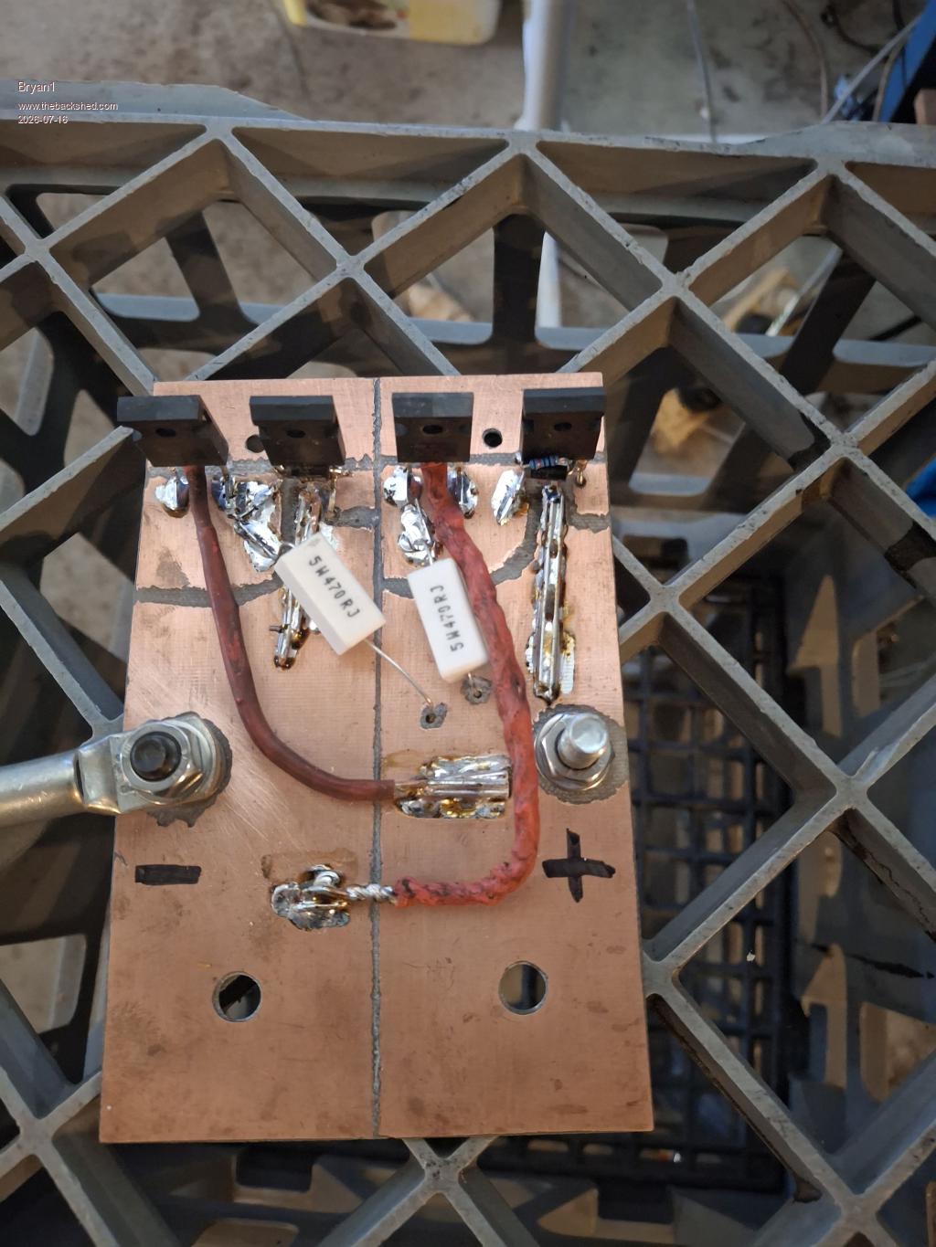

Well finally got the board all finished so was eager to test it and didn't do a continuity test
Just used my programmable power supply and it was a dead short
Now the 5 watt 12 volt zener and the 10K resistor are soldered directly to the mosfet pins to cut down in interference.
Now that extra copper I put on the drain pin on the left mosfet was in contact with the source pin so yet another fet going to my Blown Fet list
