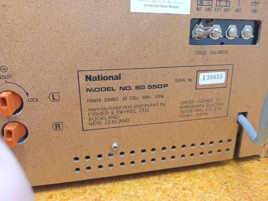

@ phil99: Thanks!
@ Marcel27: I'll get the make/model number and post it later.  No fuses in speaker lines, no speaker relay that I can remember.  Does have an A/B switch, but it feels OK.

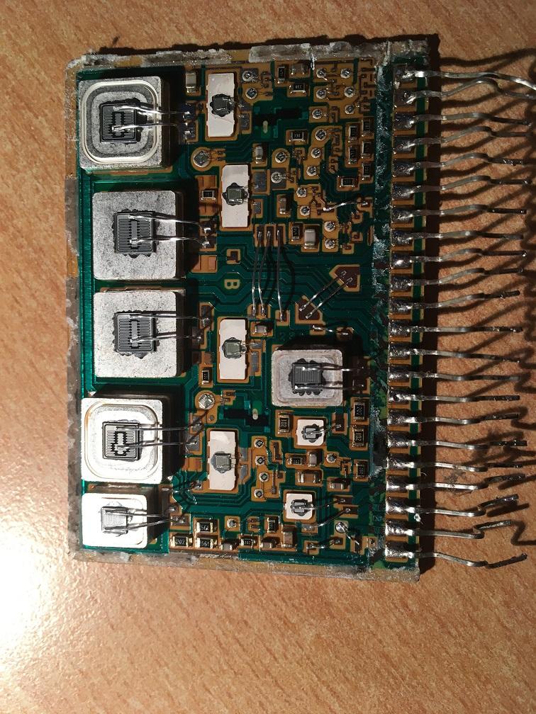

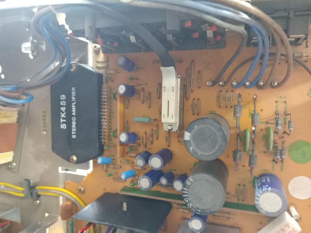

Posts: 10085
Posted: 04:55am 30 Oct 2024
Photos:
No relay, no speaker fuses.
Very nicely assembled.
Back from the days when things were DESIGNED to be easily accessible for service.
Those days are gone, unfortunately.

Nice old lady. How do the solder joints look on the solder side, all clean and no round star cracks?
Last year I bought an old Pioneer amplifier/receiver and I thought I could repair it. It had -21V at the output terminals. No, way. This had 2 of these hybrid amp modules. I disassembled the device and used only the remaining good parts. Now, I first get at the service manual (if present) and check if these "things" are inside and when it does I skip them. There are some repair man in the world who repair these devices with bjt devices soldered on them.
Edit: btj > bjt
Edited 2024-10-30 17:48 by Marcel27
Posts: 10085
Posted: 10:22pm 30 Oct 2024
I've never seen inside one of those STK modules - thanks for the photo - quite fascinating!
Yeah, on my one on the bench, the wooden side panels simply unscrew, revealing the chassis.  Rear wooden panel is the same - remove some screws, it just lifts off.  But the stellar design point I thought, was that you just take out a few screws on the bottom, and remove a sheild plate that covers the bottom of the PCB, so then access to the PCB is dead easy with the unit sitting on it's front on the workbench.  If only new designs would have access panels like this now....
Yes, examined the PCB solder joints carefully with a monicle thing, and the A/B speaker switch solder connections are all perfect - no dry joints.  The soldering on the amp module is also good, BUT it does show signs that things were getting hot there.  The amp module is just bolted to a bit of flat aluminium plate/chassis, and with no fins etc, I expect it probably overheated or developed a hot-spot(cos there are no fins and the plate is only about 2mm thick), and this has most likely cooked it.
That's my working theory at this point anyway.  The replacement modules are very affordable, so I plan to order and fit one and am reasonably confident that this will fix it and bring it back to life.
