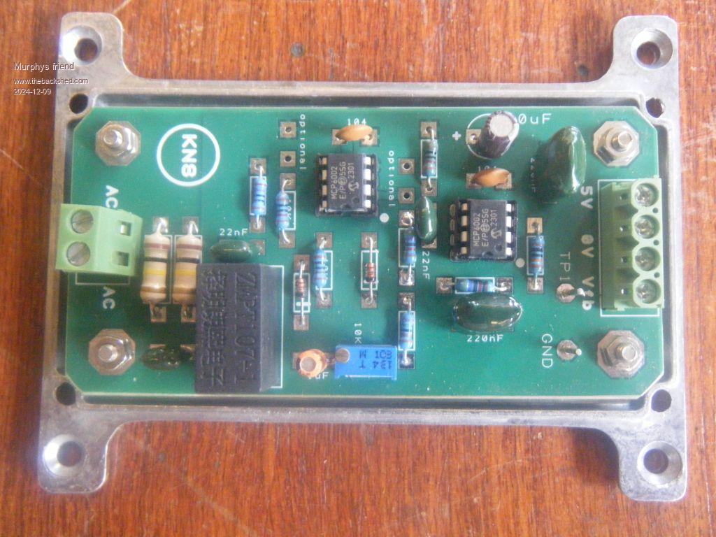

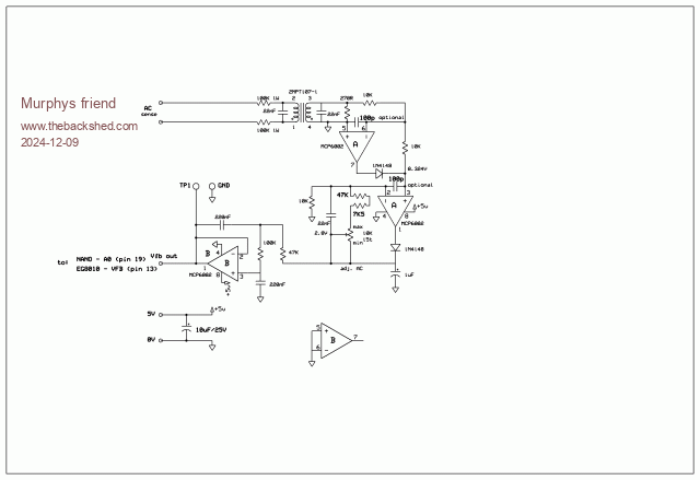

For those who would like to try wiseguy's clever Vfb method on their existing Ozinverter.
This board replaces the little 12v transformer and associated components used for Vfb in Ozinverters.
I found it to work much better, especially if the inverter is used with a GTI in a minigrid application.
The original Vfb method could rise the AC by 10V or more with a decent GTI feedback and little load. Wiseguy's Vfb method kept that rise to 2V or so in similar conditions.

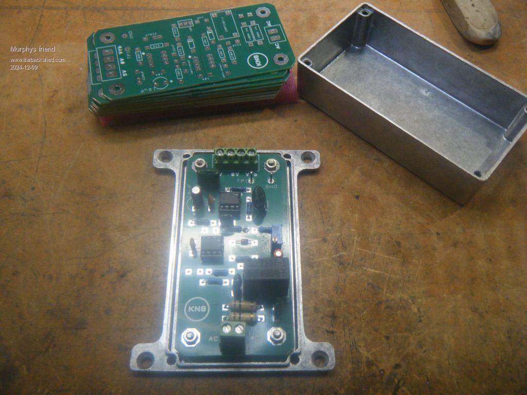

The board will fit into a little dicast box for complete shielding. This box is at DC ground potential so it must be mounted insulated from the inverter housing which usually is at AC ground potential.
I have 6 spare boards, free (including postage in Australia) to give away. Please let me know if you want one.

Nice, the box is a good idea, easy to fit in.

I don't know how the Oz inverter boards control voltage feedback but your boards look great, if they keep the voltage rise that low.

Pete, the EG8010 chips in the Ozinvereter (and possibly the EGS002 boards) use pin 13 for the Vfb input. As per EG8010 specs (worthwhile to download) this pin expects 3V DC which is the rectified output of that little transformer.
I too used EGS002 boards in my early inverter tinkering, have moved on from them long ago as they were prone to cause blow ups, especially if their Ifb circuit was not disabled.
If you were on the grid you'd notice the AC going up around lunchtime when everybody was dumping solar power into a grid that did not really need that much power input.
Your mini grid is no different which it is so important to shut down the GTI input once the batteries are fully charged and no other big load has use for the extra GTI power.

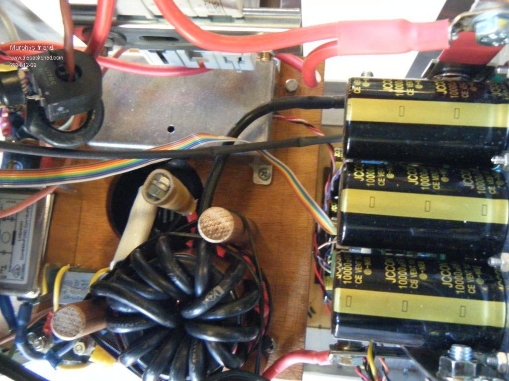

My inverter did not like my old abrasive chop saw, it tripped the AC current sense every time I tried to use it.
So, I connected my peak current sensor - KeepIS described it in a tread - and this shot up to 400A peak DC from my nominal 53V battery bank on startup. This would correspond to about 4.5 times less peak amps at the inverter's AC output.
The problem is my inverter's AC current sensing works on instantaneous values. It would have to be set way too high to cope with those loads.
Then I remembered that there was a 25A AC circuit breaker in my (6KW) inverter. These can cope with high instantaneous loads but trip reliably from an overload.
Now I have disconnected the inverters AC current sense, the AC C/B is good enough to protect it from overloads. But my inverter is a home made job, not a Chinese (usually way over rated) product .
