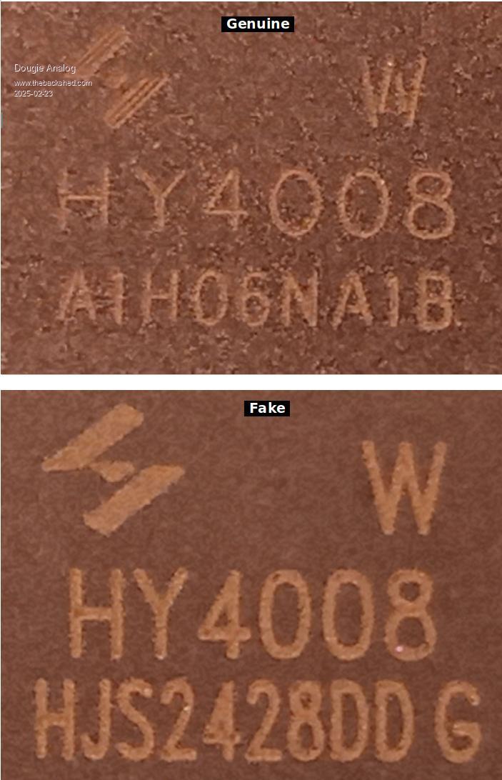

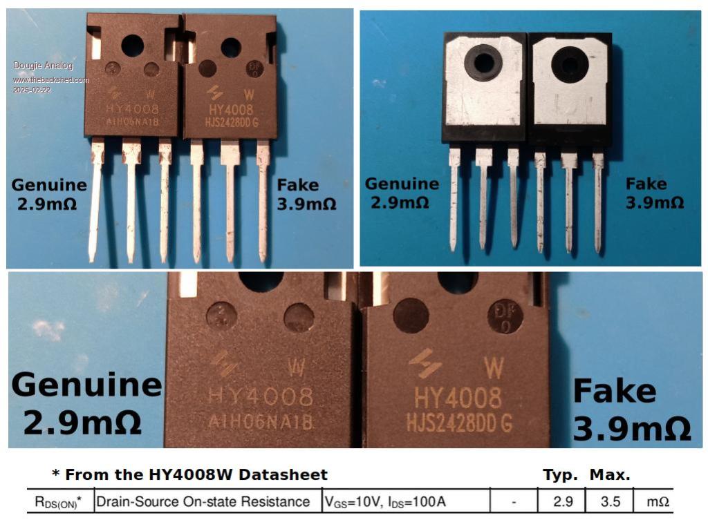

Early this month I ordered and received 30 x HY4008W MOSFETs form GSXDZ-ic Store  at AliExpress for $1.57AU each including shipping and tax.
These MOSFETs look similar to the genuine ones but have a higher RDSon.

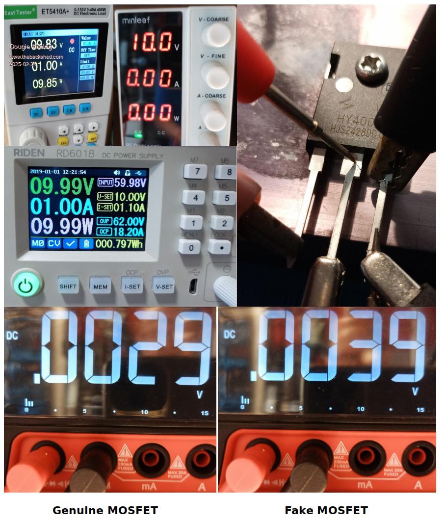

All of the Aoweziic ones tested at 2.9mΩ, which is bang on the typical datasheet figure. The GSXDZ-ic ones tested from 3.9mΩ to 4.1mΩ , which is higher than the datasheet maximum figure.
I won't use these new MOSFETs and will place a dispute on Ali and probably order some new ones from Aoweziic.
Having said all that, 3.9mΩ to 4.1mΩ are respectable numbers for these large MOSFETs, just not what I was expecting.
Looking at them closely, I can see the font and kerning is different and also slight differences in the case moulding and plastic case texture. The back and the pins look very similar.
I wonder if these are from the same factory and are binned as "out of spec"?
Maybe someone has acquired them for the right price and independently re-labelled them as spec devices?
They may work perfectly fine but perhaps slightly warmer, but I'm concerned that there may be other out of spec issues like turn on threshold, total capacitance etc.

A side by side...

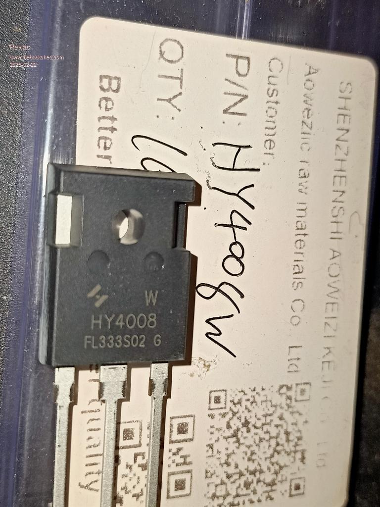

Here is a picture of a genuine one from Aoweziic a few years ago...... looks identical?

Here is a better close up of the 2 MOSFETs.

Revlac, thanks for sharing the picture. The font on yours looks more like the higher  RDSon (3.9mΩ) MOSFET that I have.
Could it be true that in fact the 3.9mΩ to 4.1mΩ devices are genuine and that hooyi are a bit loose with their devices conforming to their datasheet and a lack of conformity over different batch runs?

Could be, Murphy's friend did a lot of testing on these a long time back, for the most part people report these as all within spec as more were bought, there earlier purchases did require some testing though I don't remember if they were from the same supplier back then.....too long ago.

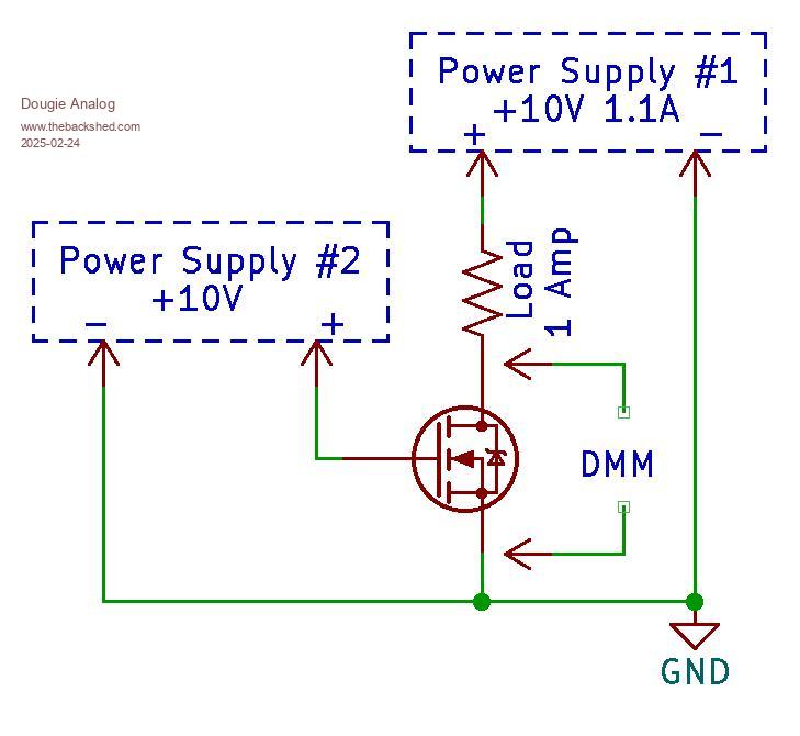

FWIW this is the RDSon test process I used. Pretty sure it was inspired by someone here years ago but sorry to that person, I can't recall now. May serve as a refresher for others.
Connections:
Heatsink the MOSFET under test
Power Supply #1 and Power Supply #2 Grounds and MOSFET Source joined
Power Supply #1 (+10V) to Electronic load Positive
Power Supply #2 (+10V) to MOSFET Gate
Electronic Load Negative to MOSFET Drain
DMM Positive to MOSFET Drain
Test Process:
Power Supply #1, Increase Voltage from Zero to 10V (1.1 Amps CC)
Power Supply #2, Increase Voltage from Zero to 10V
Initiate the Electronic Load (1 Amp)
Measure the voltage over Drain to Source (VDS)
Calculate the resistance:
Resistance = Volts / Current (RDSon = VDS / IDS)
Example:
If 0.01V is measured with a 1A load, then:
RDSon = 0.01/1 = 0.01Ω or 10mΩ

Fake devices are seldom just a little bit out of tolerance.
To know for sure that they do or don't meet the specification it may be necessary to replicate the manufacturers test method. Their procedure is often in the datasheet somewhere.
Using your own test that replicates what you are going to use them for allows you to pick the best ones for that project, regardless of who made them.

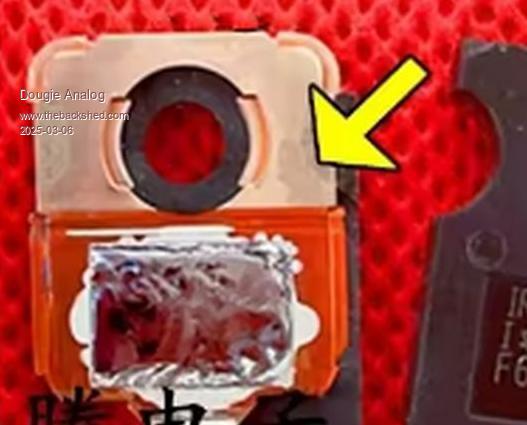

Does anybody have pictures of the inside to see the chip size.
I didn't think to keep my dead ones to split open.
I found this picture online but I can't verify that it is a HY4008W.
Here is a picture inside of a TO-247 MOSFET found online.
The chip in this unknown TO-247 is bigger than the one above but I have no reference for what the real one looks like.
I guess I could sacrifice a couple of working ones to find out but if the picture exist elsewhere than that would be good to see.
