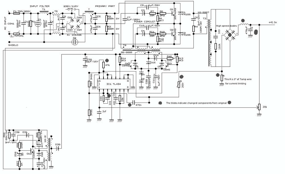

A. oscillator cap and resistor,
B. The two drive lines that drive the totem pole trannies and associated caps and resistors.
c. the power lines from the small flyback transformer that provides the power in standby mode.
All the rest can go, just leaving the pwm chip, it's output drive lines, and the diode and caps that provide startup power for the unit.
In fact, for battery charging, the batteries can provide the power for the 494, and you could do away with the flyback system as well.

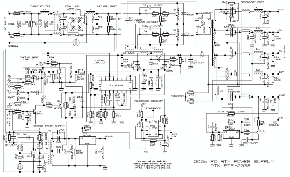

We then need to put in a current sense system, voltage sense and control system, feedback components, bridge rectifier, output inductor and a few caps and a bleed resistor.... maybe 10-15 components.
This schematic seems to be a good descrition of these types of supply. Try and get a feel for it from reading this:
Looking at yours, you have an opto isolator, which I assume communicates with the flyback. I haven't seen this in my generic supplies, but should pose no problem (if it does then you can still use the batteries to power the PWM.).
In the schematic, we are interested in keeping all the HV stuff, and only keeping the 494, it's oscillator cap and resistor, the totem pole trannies...and supporting gear.... ie the caps and diodes and resistors(follow pins 8 and 11) and then C21 and D30 in the LV side of the flyback supply for Vcc for the 494, and thats about it. All the rest is useless.
We replace that with a few other parts... that I had best scrawl out for you when you think your ready to have a go.

Looking at your circuit, i'll keep all the trannies. Would the tranny marked T2 in your circuit be the flyback supply, or T6; marked 'Second Power Supply'? (I've traced pin12 (VCC) of the 494 to the upmost tranny on my pcb.)
Edit:
Oh, you said keep D30 and C21. Then T6 are flyback. I guess i can keep that 78L05 also, for future 5V extensions?
I'm guessing the 'Power Good' circuit goes, and also the bit marked 'Overvoltage Circuit'? Am i right in assuming that the LM339 chip on my pcb does those two jobs? (i.e. be gone with it?)
How about everything right of T3 in your circuit marked 'Secondary part'? Remove all, and add some later?
For the 494 part, it would be easier if you said which parts to keep according to your circuit above. Edited by Cornelius 2009-06-25
oztules
Joined: 26/07/2007
Posts: 1686
Posted: 03:24pm 23 Jun 2009
I have spent some time fiddling that circuit. It is late here (1.20am), and I may have some mistakes, but I will check it out tomorrow. It should be very close to correct I think.
You should be able to use T3 as is. In it's current form I would expect 25-27v (with all regulating circuits disabled), when full wave rectified, probably in excess of 45.... so 41.3 should be no problem.
The regulator will not be terribly useful (5v) as very small current available really. T6 is the flyback (one of three side by side on your board....XF114A. More importantly, the 7805 takes up real estate on the heat sink... an you may want to use 4 dual diodes on that heat sink for the bridge.
Tell me how you find this version perhaps.:
...........oztules
Edit. Changed the feedback loop for the op amps to get rid of some small instability at very low load levels. Ditched the resistor on the pin 4 and go straight to ground. Changed the divider for the voltage, now the range is 1.5v to 29v.Edited by oztules 2009-06-26

Nice work on that schematic! With the original and the modified schematic, it should not be too much trouble translating it to my pcb.
The high speed diodes; any suggestion on what i can use? Any leftover from the downstrip of the pcb? Can i use those Schottky diodes? (i have some of those from another psu too...)
Edit2:
Uh, got to learn to read your post properly before asking i see... 4 doublediodes it is.

If you want some power for other things, you have a heap of taps to use on the main transformer as well, resistor and zener will get you your 12ma without too much problem from the 41.3v rail.
Usually, 25v or more is available at Vcc on the 494 from the flyback. I don't know how much current, but 12ma should be within it's grasp I should think.
Take a good look at how the two error amps in the 494 actually work, and most of the mystery of these things evaporates.
Pins one and two control the voltage, 15 and 16 control the current. I'll get back to this later.
...........oztules
