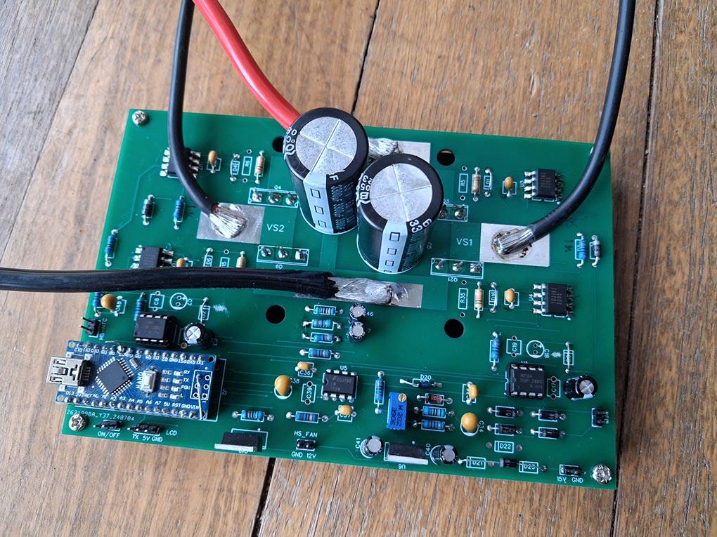

63 parts.
4 fets
2 bulk caps 63V 3300uF
5 v1 highside drive
5 v2 highside
4 v1 lowside
4 v2 lowside
5 Vdd signal contitioning
2 v1 pulse maker IR2184
2 v1 pulse maker
18 Vfb signal conditioning
3 Heat sink 10 NTC signal conditioning
3 underneath Nano
1 nano
3 15V -> 5V linear reg
some 0.1" pin headers
2 heat sink fan FET and gate pull down resistor
I use HY5608 FETs and when fed 50V, only need to switch about 40A  so I
think these FETs will be just fine.
idle current was 0.2A DC at 54V input for 239V AC output.
The toroid makes a huge difference in idle power and I am running
this one well below any hint of saturation.
I'm really quite happy with it.
Obviously I could build it with thicker V1 and V2 output cables but I
just could not be arsed, really.
It runs the picoverter code, which features low DC voltage shutdown
with auto restart, fan control for the heat sink and heat sink over temp shutdown.
The semiconductors are:
HY5608 80V 360A 1.5 mOhm Rds(on)
IR2186 gate drive IC
FOD3182 gate drive IC
LM358 dual opamp
LM7805 linear reg
any old logic level FET to drive the fan
it worked first time I applied power!
Edited 2026-01-25 15:50 by poida

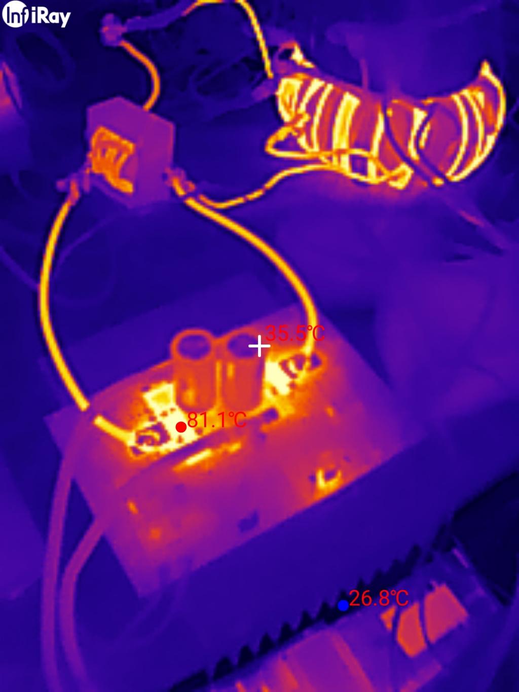

Posted: 02:56am 27 Jan 2026
it works well, only tested it to 1330W AC so far.
for the 1330W AC output (0.99 power factor), input is 54.7V at 29.1A
1590W in, 1330W out, it's 83.5 % efficient
Rather thin wire is used in the primary circuit, it's 4mm2 I think.
this wire is the primary winding and I need 3 meters of it.
I probably could pick up a few more % if thick stuff was used.
the DC resistance of the primary is 48 mOhm.
(I determined that by putting 5.8A DC through it and reading 281mV across it)
here is a thermal image of it running under this load.
the hottest part is where the low and high side FETs are soldered
sort of where "VS1" and "VS2" are located in the above image.
analog8484
Joined: 11/11/2021
Posts: 248
Posted: 06:57pm 27 Jan 2026
Nice little board.  Is it 1 oz copper?
Also, curious if you have observed false MOSFET gate turn-on transients like the ones in your past reports on larger inverters.

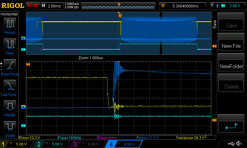

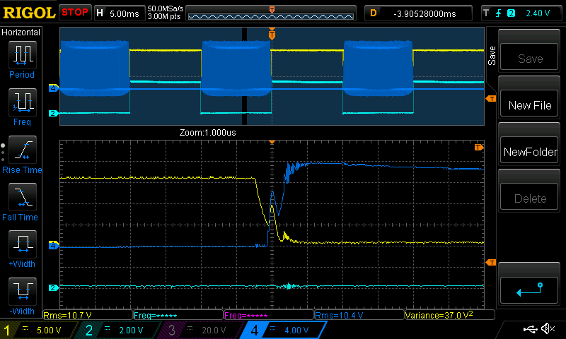

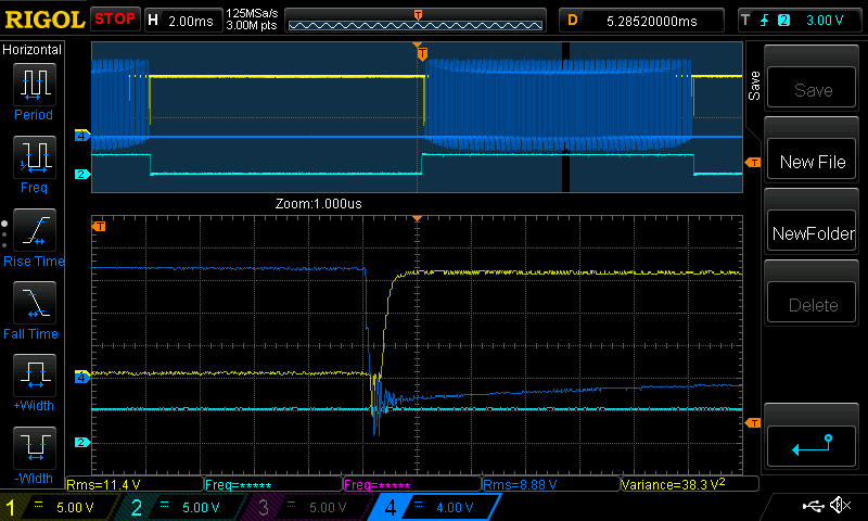

poida
Joined: 02/02/2017
Posts: 1507
Posted: 01:21am 09 Feb 2026

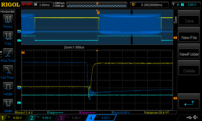

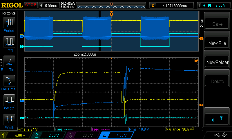

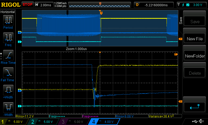

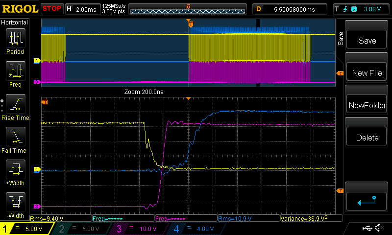

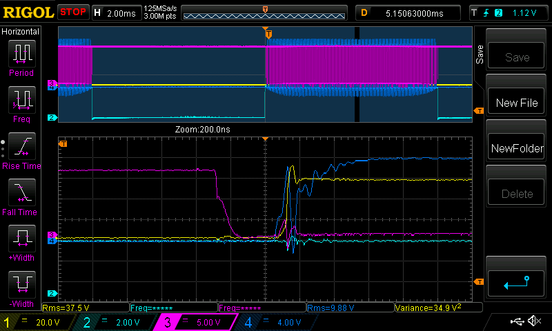

time to look at Gate voltages.
first is the switch on/off for the totem pole board, using a 10R current limit resistor and a 1N4148 diode for faster gate control when pulling it to ground (or source pin)
The drive current is supplied by a pair of TIP41 and TIP42 transistors.
test conditions are identical for both boards.
54V DC in, 200W out.
Yellow is low side gate voltage
Dark Blue is high side gate voltage
and
this is not too bad, not a lot of high frequency ringing.

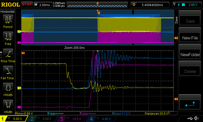

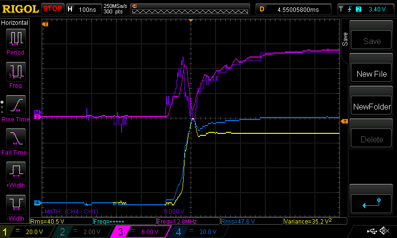

Now we see the new board, with no gate current limiting resistor, nor the diode.
I connect the gate direct to the FOD 3182 output pin.

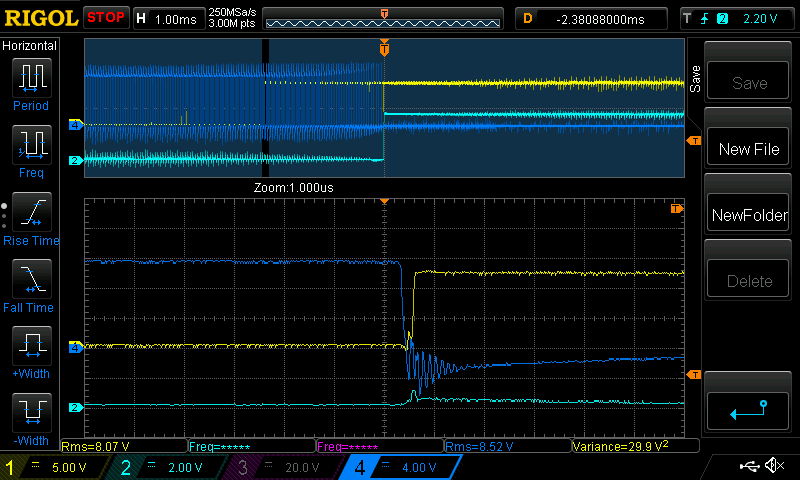

and
certainly we can see much faster switch on and off but there is now a lot
of Mhz or more ringing. This is seen in the Dark Blue trace when it goes from low voltage to about 15V, pulling the inverter output up to 54V.
I know that there should be a gate resistor according to just about all
power electrics design practice but I wanted to see what it looks like
without it.
One aim of this design is to have the smallest amount of "stuff" that makes up
the high side gate drive. I wanted to minimise the capacitance and inductance of this
by having just the drive side of the FOD3182, it's supply cap and 2 inches of thin PCB trace that follows the high side output as it switches from 0V DC to 54V DC at 20 kHz. I have got what I wanted.
time to see if a 4R7 gate resistor helps things. And after that I will add the 1N4148
for faster switch off.

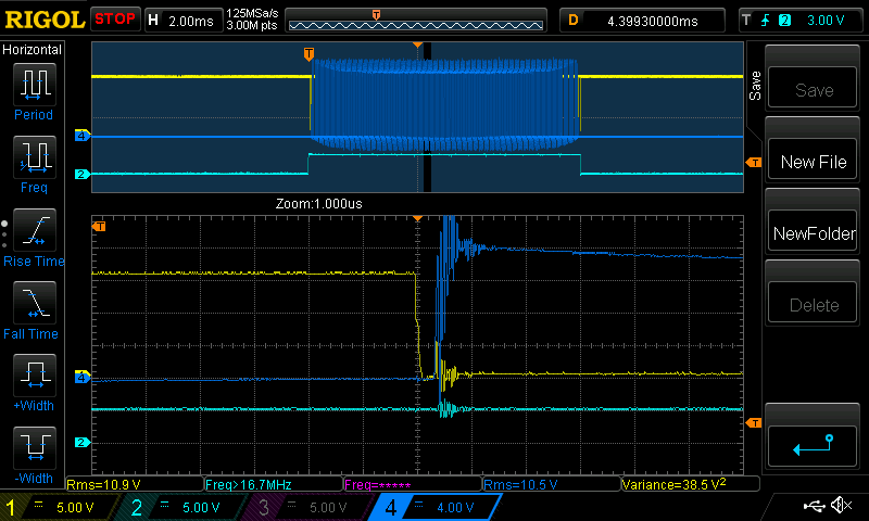

poida
Joined: 02/02/2017
Posts: 1507
Posted: 02:05am 09 Feb 2026

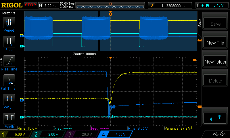

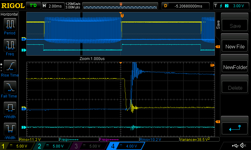

things have changed after fitting the 10R resistor (I had no 4R7)
first, just the resistor:
and
the high frequency ringing is gone. as are the fast gate voltage slopes.
This is to be expected, less current into the capacitance of the FET gate will
mean slower rise and fall times.
And look at the second peaks. this is new to me.
I think the diodes will help with those.

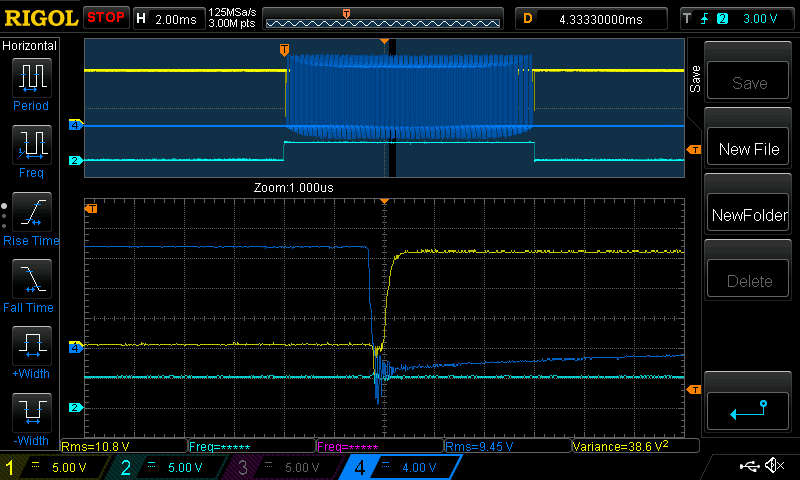

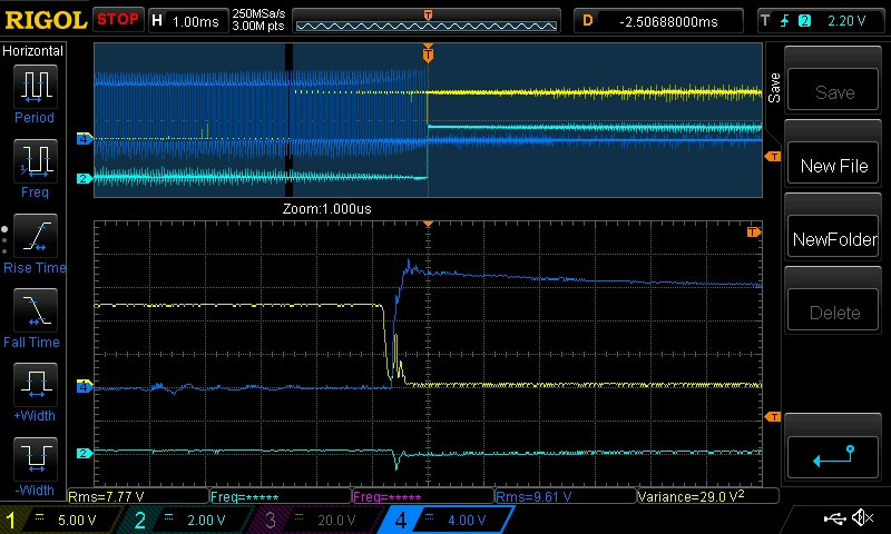

now I also add 1N5819 diodes. These are Schottky type and switch fast, and
a voltage drop of about 0.5V
and
now the gate voltages (and therefore the switching performance of the FETs)
are looking good. I see very low voltage on the LOW side FET gate after
the high side FET switches on, pulling the inverter output up to DC supply voltage.
This is when shoot through is most likely.
there still is some high frequency voltage on the high side gate and this is when we
start thinking about ferrite beads.

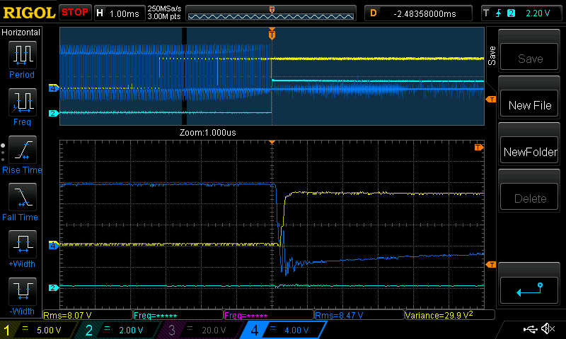

poida
Joined: 02/02/2017
Posts: 1507

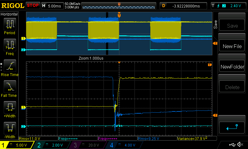

Posted: 02:13am 09 Feb 2026

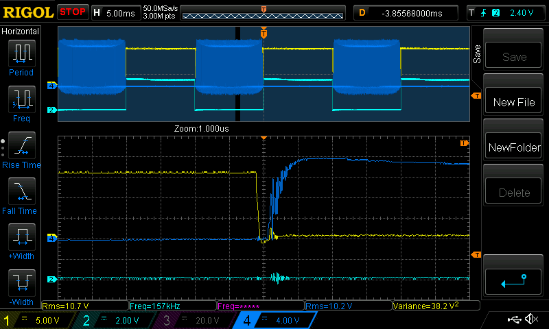

here are these waveforms when under 1300W AC output load.
they look not bad and I see they show almost identical features
as seen in the above low power testing.
I see the low side gate easily getting high enough to cause some
shoot through.
maybe it's time to review what I found with ferrite beads since I see
some scope for improvement.
poida
Joined: 02/02/2017
Posts: 1507
Posted: 03:20am 09 Feb 2026

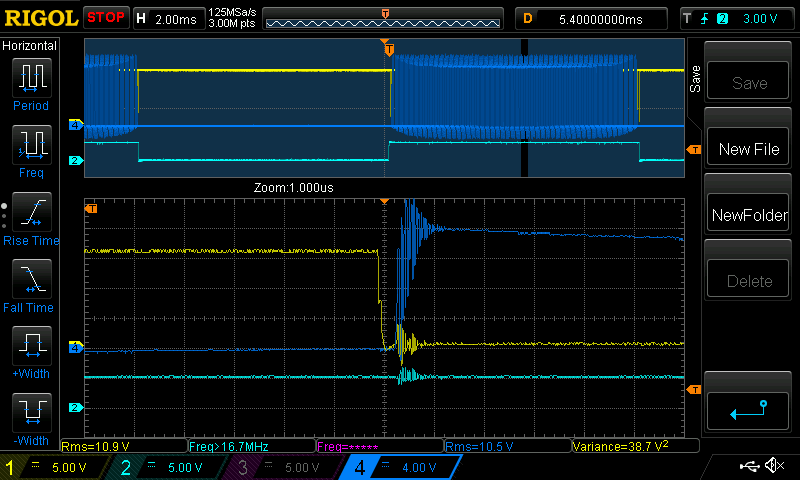

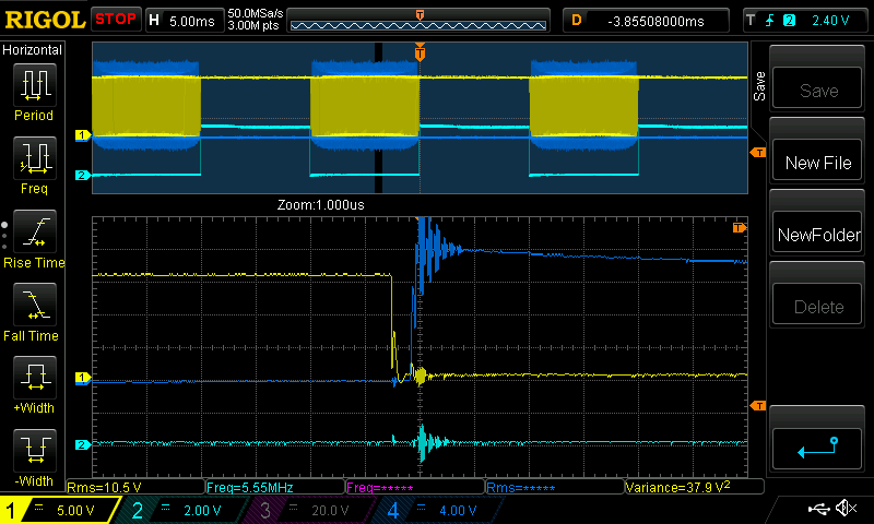

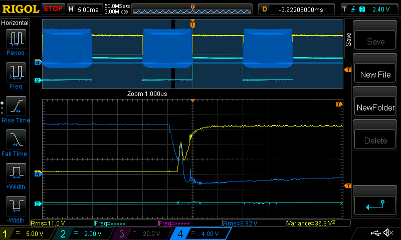

for reference, here is Wiseguy's gate voltages under the two tests
200 W and 1300 W AC output.
first is 200W:
and
I see the low side gate is being yanked up as the high side switches on.
not too much no doubt.
and for 1300 W output I saw this:
and
clearly the low side FET gate is being pulled high enough
to make it switch on while the high side FET is switching on.
this is shoot through.
overall the voltages seem better controlled than my 1 FET board as seen above.

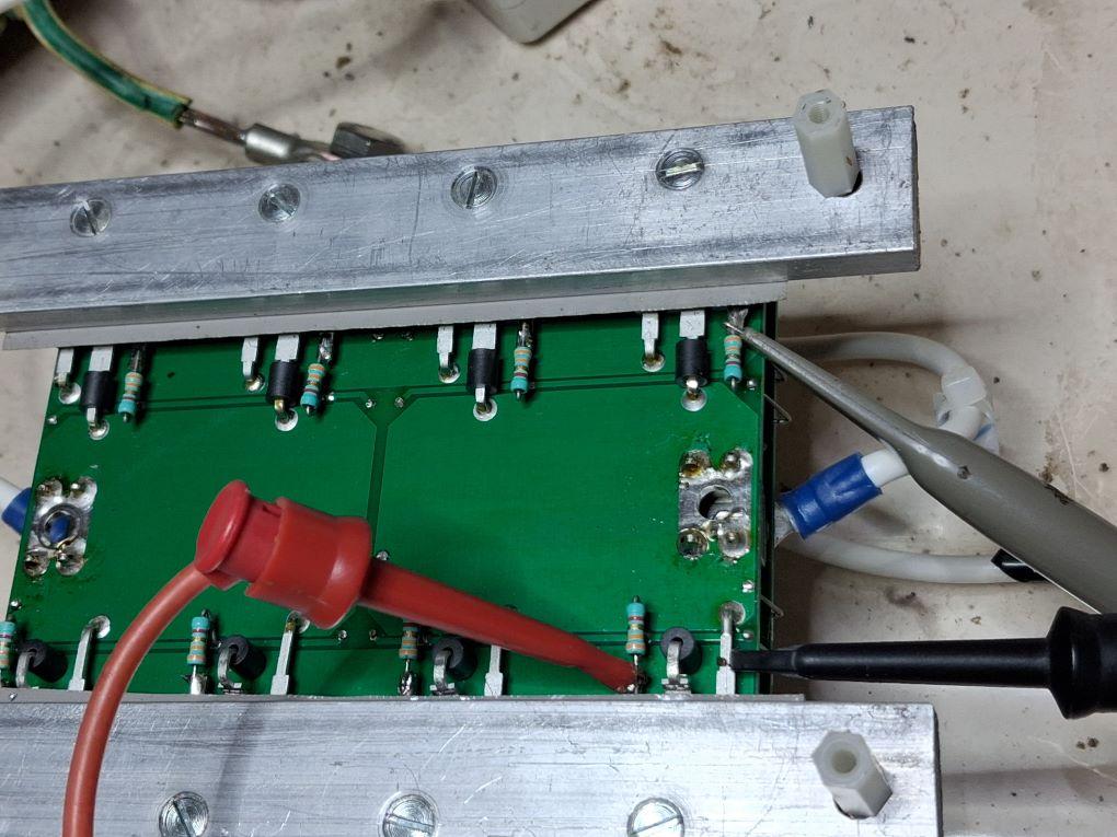

I probed the gate voltages using the isolated probe and one non-isolated probe
which was on the low side FET's gate.
Solar Mike
Joined: 08/02/2015
Posts: 1255
Posted: 05:35am 09 Feb 2026
The impedance presented to the gate of the low side mosfet when switched off determines to some degree how high its gate voltage will be pulled up as the high side device turns on.
You could try lowering the gate resistor to 3.5r and see how it performs, and again with the schottky diode in parallel with it.
Another thing to try is placing a small cap 470pf directly across the gate\source of the low side device, this may help with shoot through.
Mike
poida
Joined: 02/02/2017
Posts: 1507
Posted: 07:05am 09 Feb 2026
thanks for the tip
I do not have things like 3R5 resistors here at home.
it's probably worth a try tho.
I wanted to compare the old TIP41/42 thing with the new board so
I had to use 10R resistors.
I am curious about the idea of adding capacitance to the Gate.
when I add a cap to the gate pin, it still has to "operate" via the pin's lead
since this voltage jump is generated from the chip's internal capacitance that is coupled to the drain/source voltage difference.
I would guess there is a balance of this and that which could be found that might be just right.
I would love to get right in there and disable this coupling.
but it just is there.
Solar Mike
Joined: 08/02/2015
Posts: 1255
Posted: 08:08am 09 Feb 2026
That small cap (ceramic) is a very low impedance and can absorb some of the miller pulse getting back into the gate; too large and its going to stress out your driver chip...
AS an experiment: remove the gate drive resistor to one of the L0 mosfets, short the gate directly to its source pin via a similar resistor, this removes the inductance and any transmission line affect back to the driver IC.
Power it up, yeah the output wave form will be crap, but place your scope probe across the shorting resistor, see what gets reflected back by the miller effect as the H0 mosfet turns on; if the wave form is heaps better, then you know its circuit board layout dynamics affecting the gate drive, perhaps necessitating a better layout.
Aim to have the output of the mosfet driver 5-10mm or so from the gate pin, remember the gate circuit is a transmission line, the longer and thinner it is, the more time it takes for the driver transition to get to the gate, similarly a miller pulse getting into the gate from H0 mosfet turning on, takes longer to be negated by the impedance of the driver sitting at 0 volts.
Edited 2026-02-09 18:27 by Solar Mike
wiseguy
Joined: 21/06/2018
Posts: 1336
Posted: 08:12am 12 Feb 2026
The gate resistors for the HY5608's that I got very good results with are 1R2.
I did not get any noticeable improvement by adding diodes across the resistors.
I did use a 12V - 15V low side DC/DC module to provide the negative bias of ~ 3V there was no shoot through at all. The two capacitors across each of the inverse optocoupler LEDs is listed as 1nF, in the 16 FET Power board I used 1n5, maybe 1n is a bit on the small side. The capacitors are proportional to the "dead time" between upper and lower FETs.

Nice captures of the false turn-on waveforms.  The most interesting ones to me are the ones under low load conditions where most inverters spend their time when running. My theory is that frequent (PWM frequency) but short false turn-on's under low/no load conditions are pernicious and cause the thin MOSFET gate oxide layer to degrade over time and can eventually fail suddenly even without a significant load.
Looking at the 200W load low-side waveforms of the new board:
200W load, no gate resistor or diode:
  poida said
200W load, 10R gate resistor and diode:
  poida said
It looks like the false turn-on peaks (~2.5 to ~3V) are greater than the minimum HY4008/HY5608 gate turn-on threshold voltage (2V).  Adding a small gate cap should help reduce the false turn-on peak as it changes the overall Cgd/Cgs ratio.  However, it also has other side effects like increased switching loss.  Perhaps negative gate bias voltage would be the cleaner way to keep the false turn-on peaks well below the minimum MOSFET gate turn-on threshold voltage.

I took above suggestions and tried 1R2 and 2R2 gate resistors (in place of 10R)
and on the 2R2 side, I tried 270pF and 470pF caps, connecting Gate to Source with short leads.
more DSO captures again..
first is 2R2 with no caps
low side switches on (Yellow is low side gate voltage)
high side switches on (dare blue is high side gate voltage)
and this is where the trouble is located.
and then there are the 1R2 gate resistors. in both cases switching speeds seem a bit faster.
and
there is a lot of high freq activity on the gate voltages, indicating
wild oscillation of the state of the half bridge switching process.
I now put 270pf ceramic cap across the gate and source pins of both
low and high side. maybe less oscillations?
and
and now replaced with 470pF caps
and
not a lot of improvement, sadly.

here is a detailed look at high side switch on, this time
with 2 470pF parallel across gate and source. this is nearly 1nF.
Pink is half bridge output voltage (connected to primary winding)
125MSamp/sec means 25 sample points each 200ns so the voltages
are what the DSO saw (and not implied with interpolation)
The output is ringing like a bell and what is driving it?
we know output voltage couples into the low side gate voltage
probably there is some inter channel cross talk too.
I like how it rings hard, reduces some, then rings again, then settles down.
it seems to be 4 cycles per 200ns or 20Mhz
If I could target this with something tuned for 20 Mhz things
might start looking good.
the above tests were at 200W output load.
this is with no load at nearly the same place in the 50Hz cycle.
I can't believe how good it looks
to see what sort of difference in signal probing I connected
the isolated probe to the bridge output and it follows the Pink curve perfectly
is a little delayed. similar rise times and delayed by 8ns.
so that voltage on the output rises well before the high side FET switches on.
Edited 2026-02-15 11:50 by poida
Solar Mike
Joined: 08/02/2015
Posts: 1255
Posted: 03:24am 15 Feb 2026
So adding additional small input caps (gate-source) don't seem to do much; best to remove them.
Going back to your earlier High side scope output, those HF oscillations are there from the start, perhaps place snubber across the H0, H1 mosfets (Drain-Source) to try to reduce their intensity, try 2200pf 500v ceramic cap in series with 6.8R 1 watt resistor. The cap value is usually quite small and depends on the oscillation frequency.
Edited 2026-02-15 13:25 by Solar Mike
analog8484
Joined: 11/11/2021
Posts: 248
Posted: 07:16pm 15 Feb 2026
For clarification, were the gate resistor and cap changes made *with* the turn-off bypass diode?
If not, the results showing increased false turn-on peaks are not surprising.  From earlier tests, it's clear that the turn-off bypass diode is necessary but *not* sufficient to reduce the false turn-on peak level to below the gate turn-on threshold voltage.  This suggests the gate driver internal turn-off resistance is already relatively high.  Any external turn-off resistance will only increase the false turn-on voltage.  I would suggest adding the 470pF gate cap to the 10R/diode config from earlier tests.
As for failure mechanism, my high level understanding is that shoot-through generates tremendous heat rapidly that degrades the gate oxide layer.  Specifically, shoot-through during false turn-on's happens in the linear region of both high and low side FET's which is really bad.  This is very different from high load conditions in systems without shoot-through's where the FET's are mostly experiencing high current in the non-linear region.
Edited 2026-02-16 05:18 by analog8484
