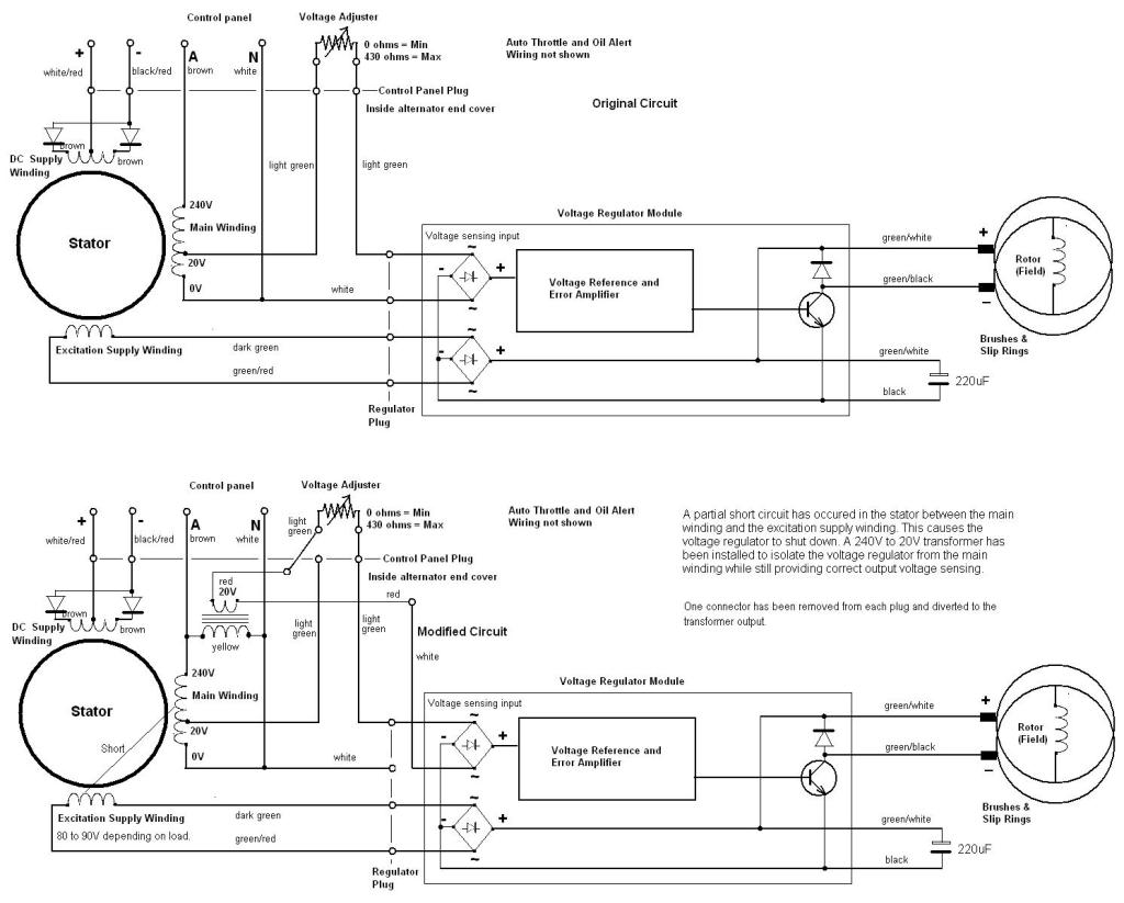

Posts: 3421
Posted: 08:41am 20 Jun 2026
Re the Honda, I have a very old one (3.6kW side valve engine, 1980ish model) that had similar symptoms a few decades ago. The very low output voltage turned out to be due to a partial short between the main winding and regulator/field supply winding.
This messed up the feedback voltage sensing, which is taken from a tap on the main winding.
The cure was a small isolating transformer to provide the feedback voltage.
Post the model number and I will try to find a circuit diagram. Perhaps a similar trick will work with yours.

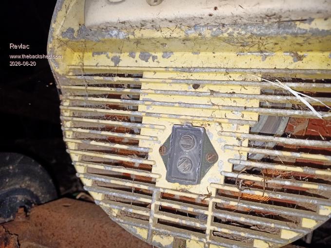

  Quote  The ancient dunlite generators have the brush gear accessible so that one can take the insulating caps off, and put a 9 volt battery straight onto the brushes to excite the alternator. And away they went.
Yep that reminds me of the old Dunlite (think its 4Kva) with 13Hp B&S motor,
We did replace the high speed diode on the Back of the Brush plate, last time I ran it on gas so no longer have issues with stale fuel....Haven't used it for years, for Honda there are LPG Carburettors around makes it very easy to start but was never impressed with the mixture when the governor opened up, regulator might have been too small.
Anyway we moved on to the old Lister genset....never fail.

Phill the 7.7KVA genset is a Paramount Browns model now all that genset did was supply 13 amps to the S&S battery charger and oneday it decided to stop working, now I did buy a new regulator for it and it didn't cure the problem. So as the engine is still good it will be a good exercise to convert the output to a V-pulley for my 6" Jaw Crusher.
That Honda 5KVA genset was bought in '05 and with it using a genuine Honda motor there are 3 things that stop it working usually. Air, fuel and spark as the auto start failed years ago and I did buy enough starter cord to redo the pull starter.
A few years ago it stopped working so bought that 7.7KVA and dragged the honda upto my shed, replaced the run cap and reflashed the stator and it served as my shed charger for years.
Now as that 4KVA was no good did a swap of gensets so I have a spare supply for the shed, now since that madboard is working it does everything I ask inculding keeping my tobacco seedlings warm.

Hi Bryan that Dunlite gene looks like it could do with a clean out and cleaning up the slip rings.
We used to repair lots of them, they are the ones that a 9 volt battery fits well onto the brush gear to excite them. The idea is to run the generator, put the 9 volt battery onto the brush terminals. ( I can't recall which is the positive one but I think it is the top one.)
Usually the generator will kick in and sound different when it starts to actually work. But the one in your photo looks like the slip rings are pretty filthy, I would clean them first. Maybe just taking the brushes out an using a piece of emery paper on a thin stick would work to clean them without disassembly.

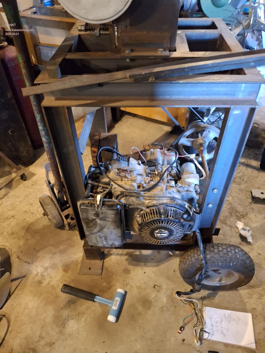

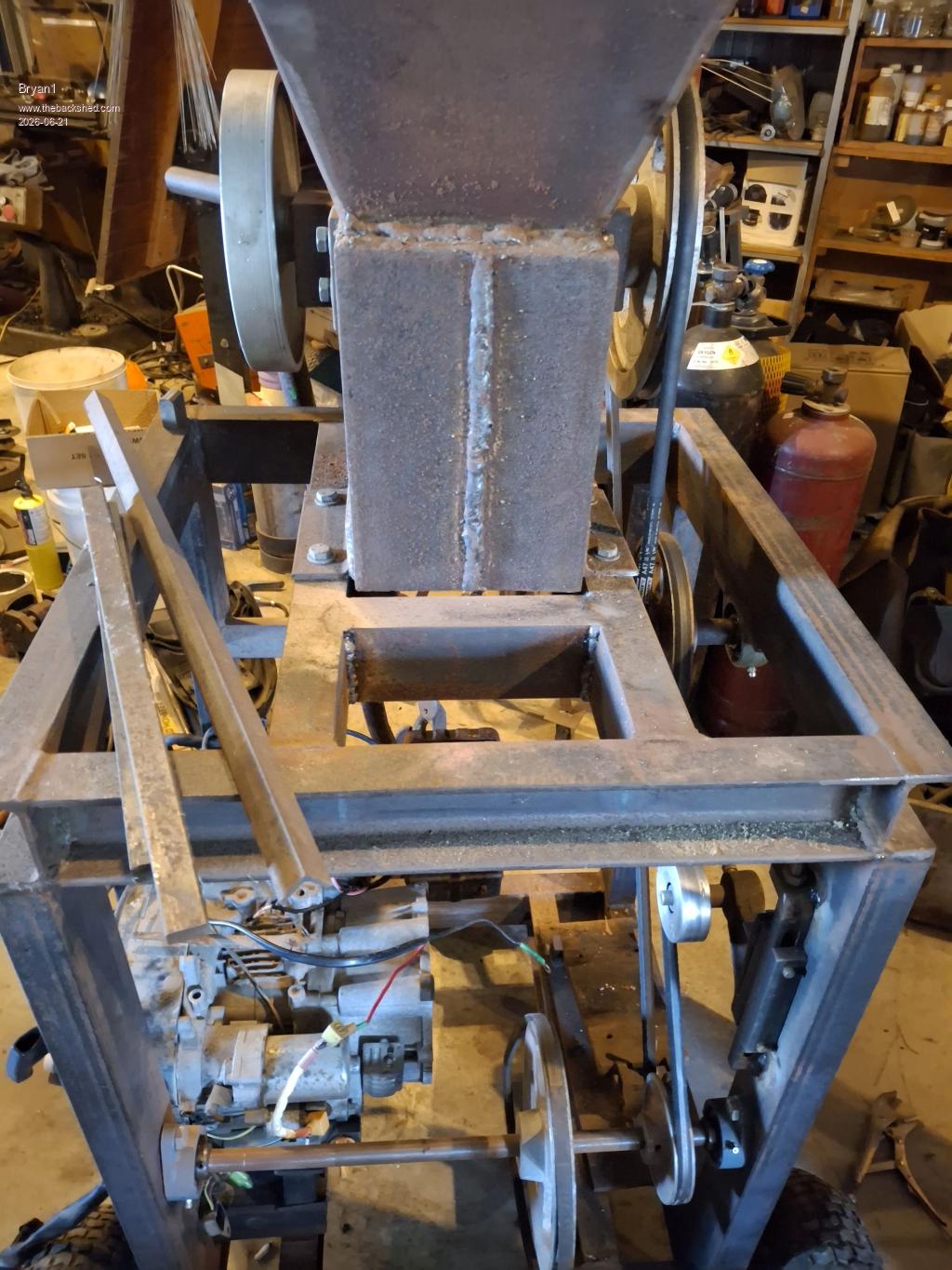

Pete that dunlite is Aarons not mine mate, anyway got the genset part off and dragged the genset frame with the engine on upto my shed and did a measure up on the Jaw Crusher and it's going to fit in nicely   now for mounting I do have 4 off flexible mounts and as the output shaft is tapered I will setup my toolroom lathe with the right angle and machine up a new mount so I can use a taperlock to mount the pulley.
Once I blue the taper and get 95% or better coverage when it's locked on it should drive nicely.
Now the motor is 16HP so plenty of power to crush rocks and the best part is spending the time getting this done as now I have my mig welder working off the inverter no more stick welding.
Pictures to come once I get the engine mounted in the frame as this project did start back in '06 so for it's 20 year birthday it can finally run as I intended all along.

Well I have found out what the problem was one of the brush's had over heated and was missing so looks like I'm going to rebuild it and as I have it apart I will put a new bearing on the stator and give the commutator a good clean so when the new brush set arrives the genset should be working again
Anyway got the engine mounted in the Jaw Crusher frame
and the side view
So while I thought this was a good idea the engine is just a tad too large but as they say if you don't try you will never know
