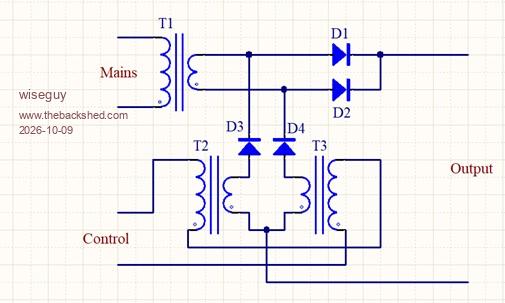

  Quote   So if a mains 4A half wave load causes the DC imbalance in the transformer, to counteract it you will need the equivalent of a mains load of ~4A on the undriven side to balance the flux offset issue or given the 1:8 turns ratio
No, not the whole 4 amps. If you look at my diagram the primary and secondary currents are the same but in opposite directions so most of the flux produced by the secondary current is cancelled by the flux produced by the primary current. It is only the small current difference produced by the slight voltage difference on the two half cycles that needs to be cancelled.
A few tens of watts from the DC current source should be enough.
It is similar to the self-saturating mag-amp I mentioned. A DC control power of just 2% of the maximum AC load power pulls the mag-amp cores completely out of saturation, giving maximum inductance and reducing the AC load current to a trickle.
Edit.
Silicon Chip did an article on mag-amps Jan. 2023, p68.
"Magnetic Amplification & Voltage Regulation by Fred Lever"
In that there is a low voltage example using two Jaycar MT2112 230:12V transformers to make the mag-amp.
Edited 2026-10-08 21:57 by phil99
Footnote added 2026-10-09 08:19 by phil99

In my view, the operation of the "magnetic amplifier" in the silicon chip article is a bit of a misnomer as I think it is more of a current amplifier using an external current to control saturation which is the actual control mechanism. In layman terms, with no control current the control transformers quickly achieve a level of saturation thanks to the DC steering diodes and passes high current to the load.
The trick is to feed some current during the 180 degrees of no current flow ie causing a net change in the control transformers inner flux that will alter the current passing to the load on the next half cycle - ie we can reduce or increase the final load current.
It appears to me that by varying the control flux level we can now control the point that saturation occur, ergo controlling output energy. So I guess it is a pseudo magnetic control but I don't concur with the simple term "magnetic amplifier".
I also don't concur that the circuit is in its simplest form as the two LHS diodes of the diode bridge could be opened and have the control flux transformer primaries in series with them (yes change the phase of one...) and save 2 diodes. Then the AC inputs to the bridge connect directly to the 20VAC from the main transformer with less diode losses overall.
To restate, it appears that the small milliamp control signal does its magic during the 180 degree off portion of the control transformer - it needs that off time to alter the existing flux with the small control current without having to fight the output current flow flux which it would otherwise need to overcome.
This is why I believe that a control current to fix our sine asymmetry would need to happen when it is not trying to overcome the low impedance drive from the H bridge ie during an off period.
I decided to check magnetic amplifiers in Wiki before I post the above as I wanted a second opinion, their definition is;
"A relatively small DC current on the control winding is able to control or switch large AC currents on the AC windings. This results in current amplification."
Simplified topology
From here I will concentrate on the code fix solution going forward. However I am also wondering if a solution which could add extra dead time (with external circuitry not affecting the code) to in effect reduce the drive only to the unloaded 180 degrees. I did some quick maths and a change of ~1% should be able to be achieved by adding up to a few hundred nano seconds of dead time to each of the HFPWM drive pulses...

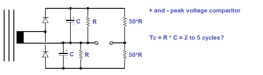

Posts: 3411
Posted: 07:07am 11 Oct 2026
Although the average voltage of your sensing secondary will always be 0V there might be some distortion of the positive or negative peak that is closest to the saturated side of the primary current. If this is the case comparing the positive and negative peak voltages may give a consistent indication of which way to adjust the PWM offset.
To test this idea vary the PWM offset** between +1% through 0% to -1% while monitoring the output of this circuit. Some experimenting with component values will be needed. This voltage may be quite small so amplification could be needed. Depending on the voltage of your sensing winding this circuit's + & - rails might be able to power an op-amp.
Edit.
Thinking about it a bit more, perhaps the time-constant should be 10 or more cycles (200mS).
If the caps. are 22µF then R = 10kΩ for 220mS
Use 1% resistors for the voltage divider.
** Or you could put a diode in series with your 200W load. Test with diode in both directions, and without it.
Edited 2026-10-11 20:33 by phil99

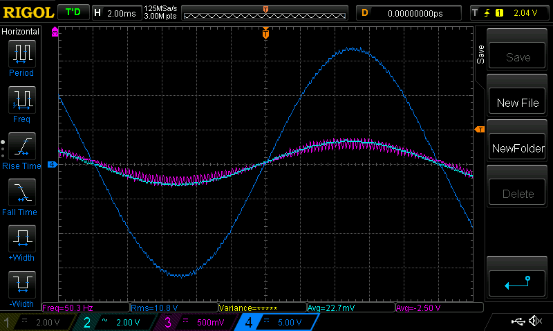

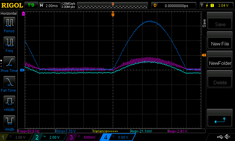

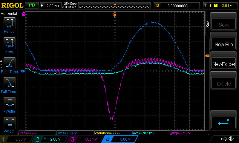

I have modified my inverter test bed.
I now have a 1600V 70A diode in series with the 240V AC output
which I have added a switch to short this diode.
this way I run it "normal" or "perverted" just by flicking a switch.
I run this supply against my 100 - 400W resistive AC load.
there is a current sensor, 0.0208 V/A on the primary winding.
Light Blue is DC volts, measured at the +DC bus location on the inverter board.
Dark Blue is AC volts, as supplied to the load.
Purple is smoothed DC current in the primary winding.
at 200W, with diode shorted is this:
and with the diode in circuit it is this:
notice the Purple average value, lower right in both images.
With the diode in circuit there is rather a lot of noise
from the toroid, as to expected.
My plan is to modify SPWM amplitude to make it not symmetric
and use as input the primary current.
I will go for a value above some small offset, say about 7mV from the
0.0208 V/A current sensor.
Depending on the sign of the offset, I will modify one or the other 1/2 cycles,
bring it's amplitude down a bit, until the current gets below some threshold.
but it's time for beer now so code changes will have to wait for an other day.
p.s. thanks Mike for the box of goodies you gave me. I used one of the VS70HF160 diodes you gave me. perfect for this.

A question;
The dark blue mains voltage seemed to collapse with the diode in circuit (second pic) something doesn't look right?

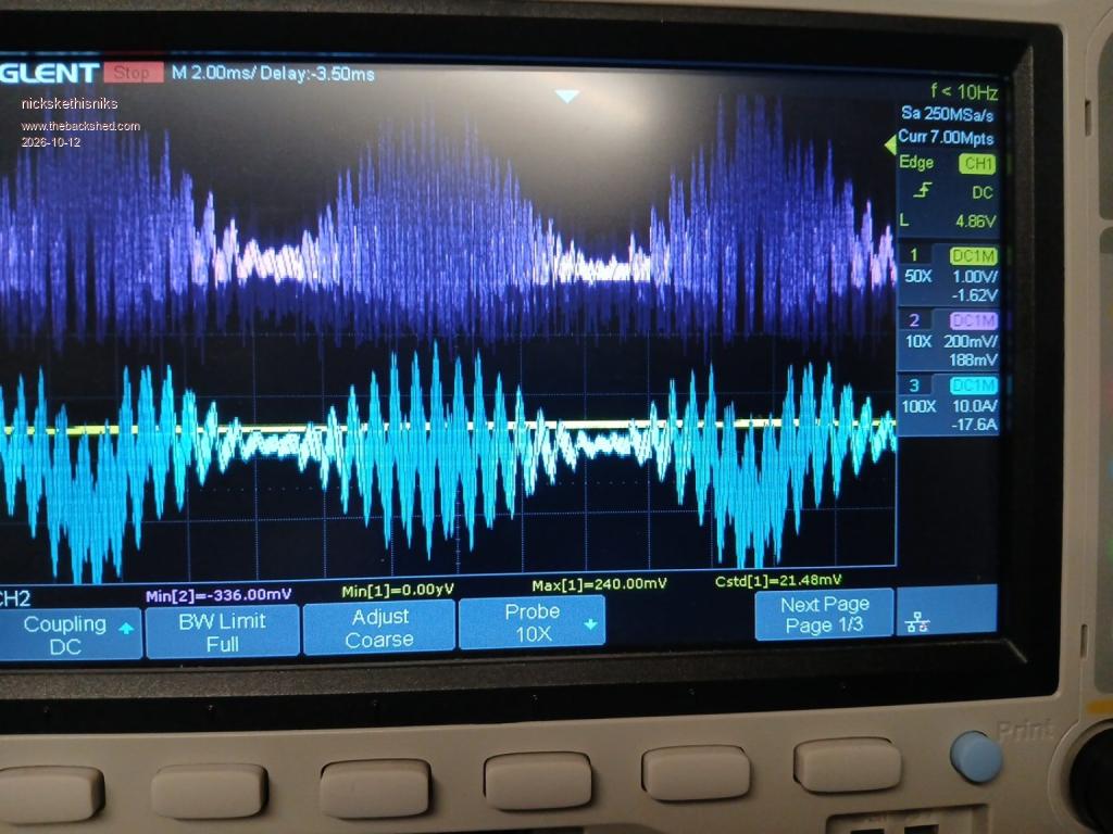

nickskethisniks
Joined: 17/10/2017
Location: Belgium
Posts: 497
Posted: 10:51am 12 Oct 2026

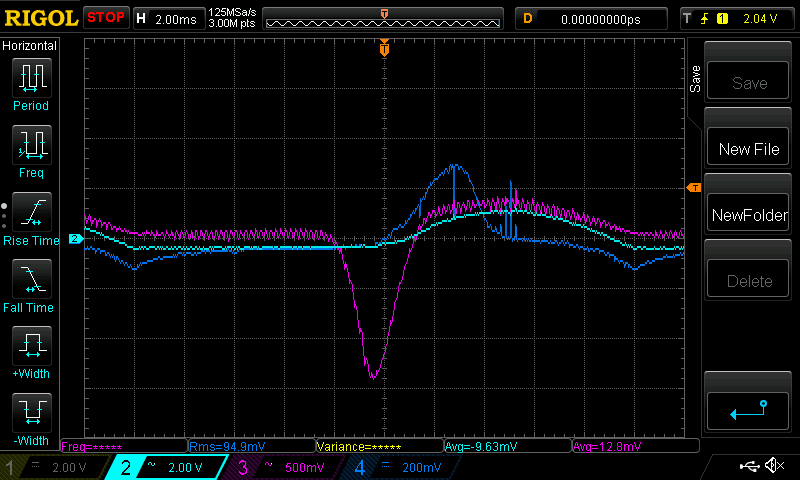

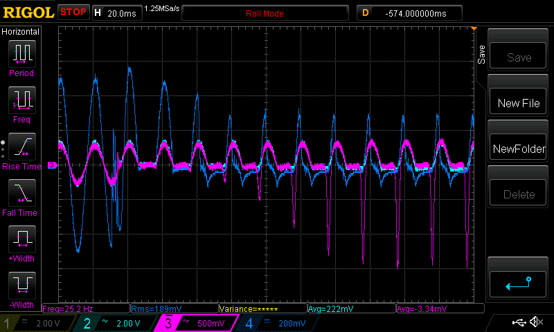

I do something like this:
I just calculate the error = setpoint - measured balance.
If:
error = negative then pos + 0.1 and neg -0.1
error = positive then pos -0.1 and neg +0.1
I can adjust the deadband so it's not reacting to fast.
But maybe the direction is wrong and that's why it drifts to the wrong way.
I do find that ultimatetly measuring current is the way to go, here you can see a no load situation with a current measurement: (but the transformer with a noticeable buz). When there is no buz the current is 100% symetric.
The blue is the primary current (between inductor and transformer) wave measured with a micsig CP2100B probe the other is random CT (2500T 70A rated) with a 100R burnden resistor after a full bridge rectifier (no rc, only adc as load).
You can clearly see a shifted current during a half period, so something is possible based on just the peak current alone. This is a no load situation so this could be even easier to spot with high currents.
(next time I will try to capture the scoop images over the ethernet instead of taken a gsm picture of it. )
Edited 2026-10-12 20:55 by nickskethisniks

Posted: 02:10am 13 Oct 2026
  wiseguy said
A question;
I sampled the AC voltage at the exact point where the load is applied,
that is, after the 1uF filter cap, tiny Vfb transformer etc.
It's fun switching the diode in and out of circuit while the inverter is
powering the load.
when in circuit, the lights dimmed a fair bit and we can see why in the AC waveform.
There are much lower voltages and in the case of one 1/2 wave, not a lot at all.
The lights are pure resistive incandescent lights so power is proportional to voltage.
I feel very confident the AC voltage trace is what is output.

I am using a LEM current sensor, where zero current is approx 2.50 V
I added a thick shunt, to permit measurements up to about 110 Amps
without saturating the sensor's output. I use the 4 wire version, that
includes the 2.5V offset voltage on one pin and the output relative to this
on another pin.
The average voltage of the current sensor channel is good enough for me to have a crack at the SPM modulation control idea.
But there is nothing stopping using the current sensor sampled at about 4kHz
to detect these large peaks. The nano code's main loop() is running at about 4kHz
and there is a large amount of spare time to do the peak detection and sampling
of the sensor output.
The sensor is 0.0208 V/Amp so this peak current is 1.5V or 72 Amps DC
The average value is over the displayed time range, or 1.2 complete AC cycles
and is about 1.75 Amps DC.
I think I will use the DC current sensor approach since it is simple to install
and remove, it's easy for me to understand and interface to the nano's ADC input
and the programming will be fun to explore. Also I will probably put a RC low pass filter on the current sensor output, to reduce the PWM components to about 1/10th
of the signal of interest.
No doubt we can work out better approaches which will have very compelling reasons
to build them. As usual I like your integrating of a differential output idea.
One of the next things I want to look at is how fast the toroid progresses into
the state where it's saturated for a portion of a cycle, once I flick the diode switch. This will give us some feel for how fast the control system needs to respond.
Questions such as how many cycles of how much saturation is tolerable need to be thought about too.
Thanks for getting the scope captures. Current sensing solutions should be more robust.  The CT primary current waveform makes the imbalance very clear.  Comparing the peaks is probably fine for no load but might be too simplistic for real loads.
