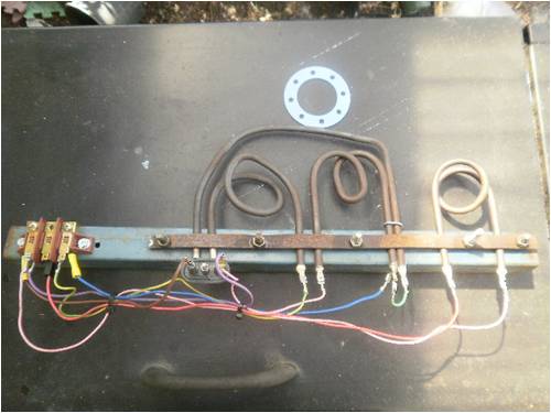

All I did for my dumpload was trip the nichrome wire off an old 240 volt water heating element and wound it over 2 bussbars to get the ohms down. For the fets I used a pair of 169 amp one from jaycar and its worked a dream ever since i put it in.
Cheers Bryan

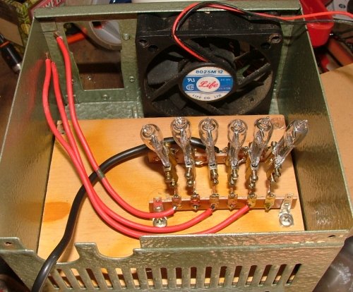

Gizmo (Glenn )
Have you thought of using quarts down lights, they are not effected by dust spots and are cheap. The only down side is there size. I use them on my dump and they work well. They come in a 55 watt size and bigger I think too.
Andy

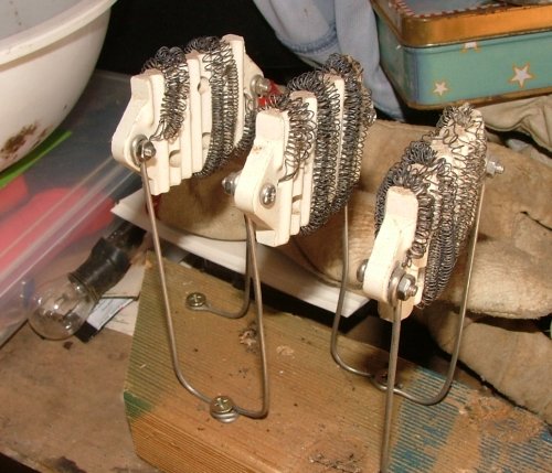

Posted: 11:06pm 12 Aug 2009
"then just 1 will do.... we unwind all the wire, and divide it into 9 lengths (for the old 1000w @ 110v type about 12 ohms), and wind 9 "mini" radiators... each of 1.3R. Each should drop about 9A... giving you about 81A @ 12v"
Is that what you were looking for?

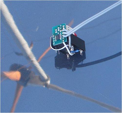

Here is a photo of the controller I put together for my new AxFx 48V alternator. This windmill is the mother of a design that fillm has posted pics of.
The unit just connects to a suitable mosfet. This one stops the windmill when the battery voltage exceeds 60V, and allows normal operation if the voltage has fallen back to 56V and the windmill has been turned OFF for at least 5 seconds. The micro PCB is stuck to the end of a nom 48VDC-reg5VDC converter. The scaling resistors are pretty simple. I have solar connected to these batteries as well and the gridfeed inverter is the nominated proportional loading, so a separate heater bank is not required.
Gordon.
