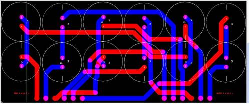

there may be many ways to wire the caps, but only this way seems to be effective.
My wiring arrangement appears to be novel and I have recently been confirmed of how well it works on my new mill.
For a 12V setup, leqave the alternator in delta, and make a cap voltage doubler using 100V bipolar audio caps. 50uF would be a good size to start, considering the single stator. You would only require 10A rectifiers as well.
A lot simpler than sensing and relays and the wiring loom needed at the alternator for a mechanical switching system.

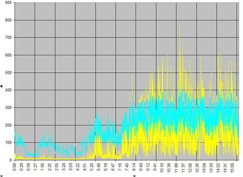

From the lack of informed responses to this question I will provide some good reasons why mechanical switching of a dynamic windmill system is likely to end with failure of mechanical components. You really have to ask ?? Is there a successful commercial implimentation of star delta switching?
Here is a graph of a typical windmill output in a 15hour operation window. There was about half the time with low winds, and the other half was variable/reasonable winds.
rotor RPM is the teal coloured graph, and output power is the yellow graph.
There were many wind gusts during this recording window. There are approximately 2000 RPM transitions through a set point of 180rpm.
Now, if I had a relay, star/delta switching system, it would be required to change the windmill wiring configuration 2000 times.
I will let the readers think about this a bit, and it will be obvious why I have chosen a switchless arrangement to achieve the optimum loading on my windmills.
Gordon.

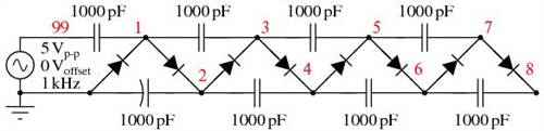

Take a look at www.allaboutcircuits.com you might find what you are looking for.

the charge pump cct you posted above is not suitable for a windmill. The series arrangement of components is the giveaway.
My 3phase parallel setup, linked to in my post above, has low impedance to deliver amps, not mA.
Gordon.

About the circuit AMACK showed - I agree with what Gordon said. The circuit AMACK mentions is a Cockroft-Walton multiplier. It's a simple and cheap way of generating very high voltages (I played around with them in the past and got up to 100 kV (estimated) using 3 multipliers from a colour TV) but only at small currents (less than a mA). Ideal to generate 25kV for a CRT in a TV set, or the high-voltage for a X-ray tube (ah... the foolishness of youth - good thing I didn't have internet back then, or I'd have probably succeeded in building and operating a X-ray machine; a few months ago I finally said goodbye to that part of my youth by throwing away the valves that would have been useful in such experiments. My offspring will thank me for that.... )
The circuit is not useful to increase the voltage of a windturbine though.

Wind the alternator if possible for cutin at half expected maximum rotor rpm. Connect Cap AC voltage doubler/triplers etc to extend the useful harvest rpm down to a level of probably 5-10W available wind energy for the rotor. The resulting alternator will load the windmill with a cubic power relationship without any sensors or microprocessors. The small amount of trialling with cap sizes is far easier than remaking and testing of any wiring combination of a stator.
Star/delta switching sounds like a simple solution, but at best is really gives 2 poor approximations of loading, and this depends still on the blade match, and load match etc.
As I have proven with my AxFx design, a stator that would be classified as suitable for 96V system only, heavily stalled on 48V[max output approx 30W into 48V battery], performs near optimum on 48V loading with AC coupling and effectively a cap voltage quadrupler and cap voltage doubler.
As long as Capacitors and rectifiers are available, they will work better than any star/delta switching arrangement.
