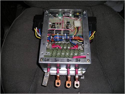

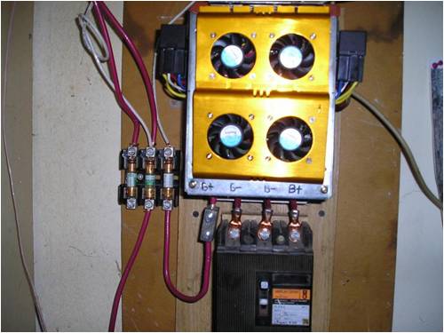

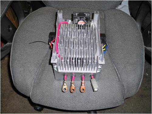

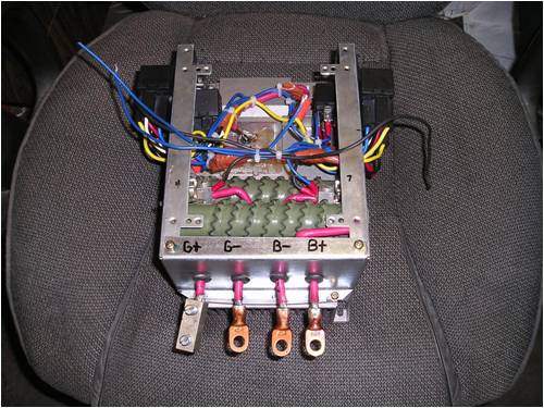

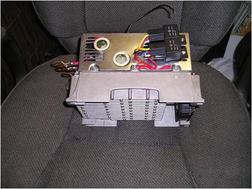

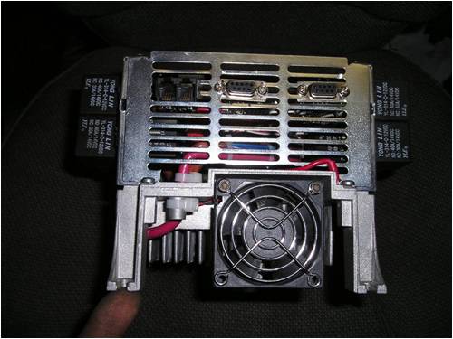

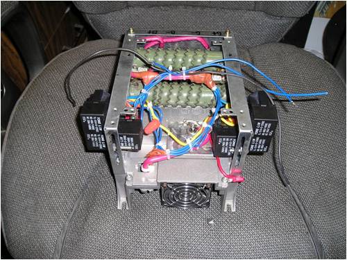

First i want to thank glen and anyone else who came up with the piclog.
I have just finished building mine with a few changes,
basically two piclogs on one board with diode turn around at coil curcuit.
1 piclog charger only and on same board 1 that will record all data only.
Also had to change PicAxe_1.2_Ver2 Logging program,
(Count 5, 1000, WSpeed )TO (Count 2, 1000, WSpeed)so i could get all data RPMs And WSpeed.
I also added in two phone jacks for the rpm and wspeed wiring.
now i can record data.
instead of video tapeing
YouTube Vid Edited by windman1000 2009-09-04

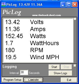

Had a little wind for a very short time today and was able to get a screen shot.
This Is mounted of the hitch of my truck while im doing blade testing.and no im not driving it around.
Posted: 12:31am 04 Sep 2009
Thats a pretty good result there Windman, be interesting to see how it goes when you get some more wind.
The Piclog build is very well put together, looks cool.

I think this piclogger is the best thing i have seen ever.
I beleave october is when we start getting our real winds for a few months, so i will be posting more data with the graph.

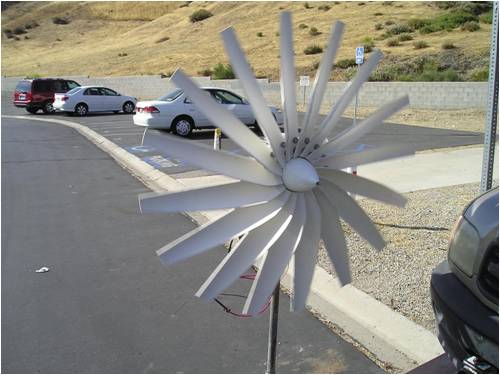

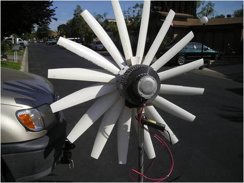

i think il have my new wind generator and 16 pvc pipe blades up tomorrow, 16 blades for low wind high torque.
and as soon as its up i know there will be no more wind

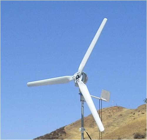

I did get my up today and while I was re running 0/2 wire from wind generator and the wires for rpm and wind speed , i could see the gen turning aprox 120-160 rpms in a nice low breeze.
But as soon As I Was Ready To Record, The Wind Went Away.
Il get pictures of the gen up in place this week , But here is the 16 Blade on a test stand With gen im running.
Edited by windman1000 2009-09-22

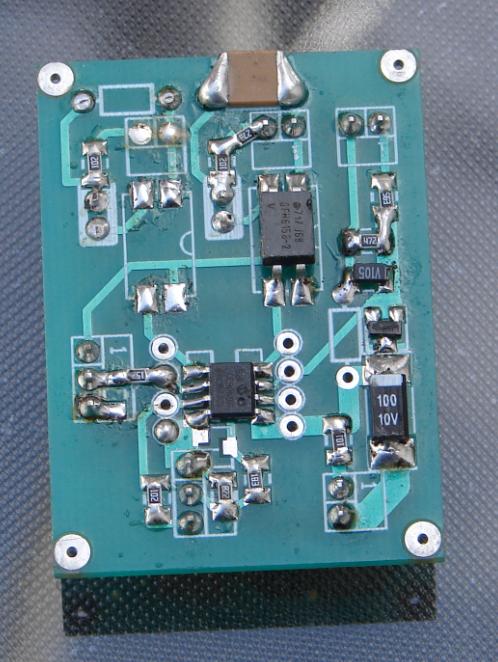

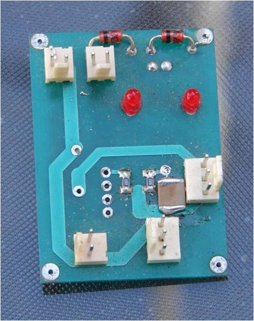

Here are some pics of my piclog. I use plugs and headers for connections, and a 5V supply from whatever is convenient- plugpac, DC-DC converter etc. The 3pin prog port is towards the bottom end of the board, and the 3pin header for the current sensor is towards the side. There are 2pin headers for windspeed, rpm, and DC volts and 5V power. This unit is scaled for 24/48V system and is connnected to a 48V system. I have removed an optocoupler, as I don't record windspeed yet. There is LED visual indication of windmill rotation and anemometer rotation.
These are my own cct interpretation of the piclog. I have added the additional analogue filtering to the rpm and current sensing. There is additional digital filtering in the micro code, and the output is the same [XML]format.
I am still revising the piclog app, to filter corrupt data that can occur when using a USB converter and half rail zero current sensors.

Gordon that piclog Look Nice and simple and small.
