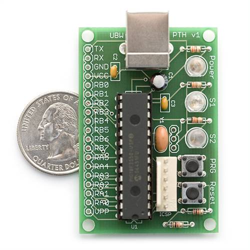

I finally found an easy and efficient solution for having a CNC Router connected to USB without spending a fortune.
I found recently UBW boards, based on PIC18F2550 (and USB-CDC - virtual comm. port) with a very efficient firmware. The C version of (older) firmware receive a byte from USB and then "post" it to port B of microcontroller, simulating the Parallel port.
All you have to do is to make a program in Basic which interpret G-Code and send bytes on serial port. Or better, download CNCPro from here and look for the routine where bytes are send to parallel port and make it serial.
I advice you to have only one USB device on your computer and that being your board (or don't move your mouse ) to let USB bus free.
In time, you can switch at D version of the firmware, which have a command system implemented and a back response (OK) from your board when received your string without errors. Or, we can advance at a version where G-Code is interpreted inside microcontroller.
The firmware can be used also on my board, via a shield. And important for me, the firmware can be also in JAL language. Both boards use a bootloader for easy updates on firmware.
Playing with such a system (or idea), can be fun.
Edit:
Sparkfun have a very nice UBW board but at $24,95 can be expensive. You decide. It come with firmware D version but once you buy it, you can upload any kind of program you want. Is suitable also for loggers.

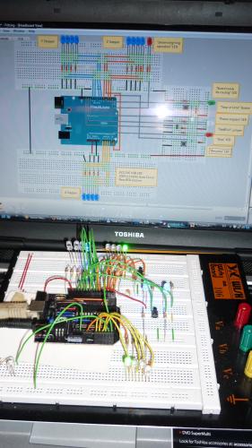

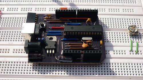

Well, unipolar steppers, so connection will be simple...
This is the development board:
And this is a montage for testing the firmware (step by step):
This time I connected all three "stepers", the switch for stop/limit, the switch for resume, led for signaling "cnc under movement", led for signaling the emergency, led simulating the relay for powering the steppers, the jumper for selecting the type of step(half/full), led for signaling "board ready to receive strings via USB" - this was needed because of delay introduced by bootloader but can be eliminated if no USB bootloader is used.

Yes Bryan, I would like to have this board:
http://eflightworks.net/ - the first from their page
or this:
USB 32-bit Whacker - PIC32MX460 Development Board
But only as a hobby. I can't imagine yet such a complex application requiring one of these boards:
# PIC32MX460F512L
# 32KBytes of RAM
# 512KBytes of Flash
# 78 usable I/O pins
# CPU runs at 80MHz
# USB Bootloader
For me, starting from 18F2550 is enough. If not (regarding to memory space), then 18F4620 and then, 18F4685.
Vasi
