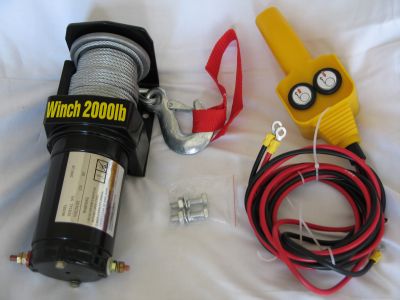

i,m waiting on a small cheap ebay 12v winch to come..it should have a fairly high ratio ..so hopefully i can play with it a bit as the basis for a yaw motor ,im not sure how suitable it,ll be .....(the yaw motion should,nt be a very big load maybe an amp or 2...i think..which might help..)
the supply battery however is 48v...(the mill system voltage )
would a pwm speed controll cct allow me to step down the the 48v and not ultimately fry something ?

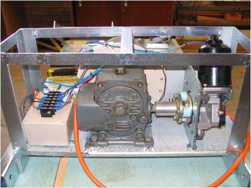

Perhaps you could try a windscreen wiper motor? The one I use on my 2x 210W panel solar tracker has a 55:1 worm drive, it draws about 2A on 12V. Edited by Tinker 2009-10-04

Hi Niall, actually I was not telling the whole story, the wiper motor drives a worm gearbox so its a 55:1 reduction driving another 50:1 . Nice and slow for what I wanted, about 3 seconds to turn the panels 15 degrees.
Oztules has a good point, the wiper motor has a plastic gear and would not be up to the yawing load directly. But for driving another gear box its great. I'll attach a picture how I connected mine - it was a bit fiddly due having to modify the wiper arm on the motor shaft.

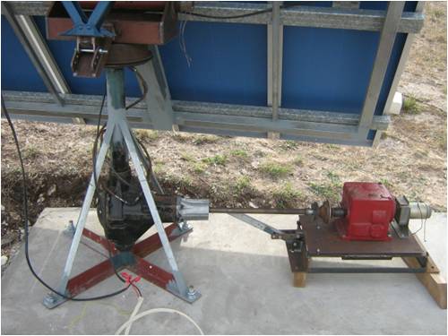

Hi niall1
On a different thought that i have toyed with, is to mount the whole tower on top of a car diff or a drive shaft up the centre of the tower and rotate it from the ground.
The diff ratio is not great enough without a second gearbox between the diff and the motor.
A car diff is strong and easy to adapt.
I built a solar tracker from a car diff standing vertical with a axle and its housing removed from one side.
The spider gears was welded to create a locker diff.
Some time soon i will post an article on the building of the diff solar tracker.
There is some back lash in the diff but this might work to ones advantage and allow for a little floating of the mill head (2-4 degrees floating)
The motor driving the solar tracker is no bigger than a wiper motor (1-2amp)driving through a 200:1 gearbox with a further @ 4:1 diff ratio.
The location of this is in a very high wind area and with stands gail force winds.
The panels create a large sail area of over 5m2 and do not track the wind but the sun and can cop a lot of wind forces.
I only have a poor photo at present but here is a photo of the drive basics.
One advantage in using something like a diff is its strong and it reduces the force applied to 1/4 before it reaches the gearbox.
Food for thought?

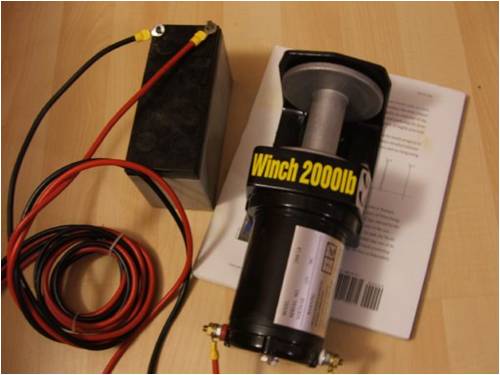

Posted: 09:20pm 12 Oct 2009
well the winch arrived
the aluminum (or something similar) drum (i took it apart) dosent seem to have a very tight fit to the main drive ,the mesh is only half an inch long,...any yawing wiggle would make short work of the aluminum ...
the main drive seems pretty good though , i should be able to remove the drum and add a permanent sprocket instead and take it from there
it pulls about 1 amp at idle , but seems to need a bigger kick to get started , driving a separate gearbox (its pretty compact) seems doable..
they have a bit of grunt, but are noisy inefficient things alright
