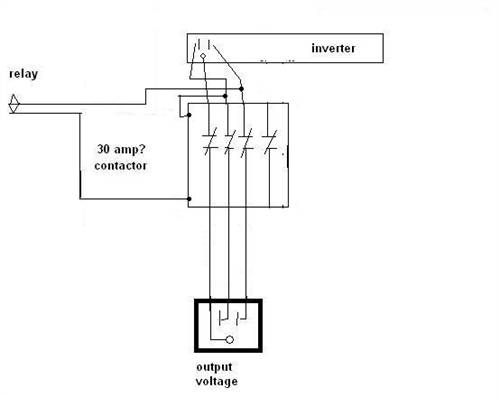

I am looking for a device that will monitor my battery bank and trip my inverter on/off when the battery bank reaches a specific charge capacity. For instance, when my battery bank is full, the inverter turns on, and when the bank is 40% depleted, it trips the inverter off to recharge.
Of course, this device should be adjustable and after it trips to the off position, it should not turn back on till the batteries are fully charged. I do not want to set it at 60% and have my inverter teetering between the on and off position every time it raises 1%.
Is there such a device or system for doing this? Besides manual monitoring, how do solar/wind systems auto control battery discharge?

Hi Floodrod
The op-amp based charge controller...
http://www.thebackshed.com/windmill/articles/TL084-Controlle r.asp
could be used for this job.
The problem is how to turn off the inverter. You could just disconnect its power, but that would mean a relay or mosfet drive switching many many amps. Some inverters have a remote on/off switch input, which would make life much easier. How big is your inverter ( watts ) and does it have a remote on/off switch?

Hmm... My inverter is a 2000 watt continuous / 4000 watt peak 12V one. It does Not have a remote switch.. I purchased the cheapest one I could for now.. I plan on upgrading to 24V when my turbine goes up, so I don't want to waste much on the 12V one that I will be using now..
I also have the Colemanair 160 amp diversion load/controller http://www.colemanair.us/vp_asp/scripts/shopexd.asp?bc=no&cc ode=C160
I don't trust my abilities to build circuitry yet.. So I'd rather buy off the shelf..
See, I have 100% electric heat in my home. No oil/gas etc.. Needless to say, this skyrockets my electric bill 9 months out of the year.. The best and easiest use for my alternative power would be to run a small heater when the batteries are charged.. But a heater would drain batteries pretty fast. It would be wonderful if I had a system to take care of the job without worry of over exhausting my batteries..

I have the same charge controller , it can be adjusted to what you want to do , or buy a nother one to do the inverter on/off, and get a reversing contactor to handle the voltage you need.just dont use the on/off switch part sence your inverter doesnt have one.
or
just one contactor to turn off output voltage

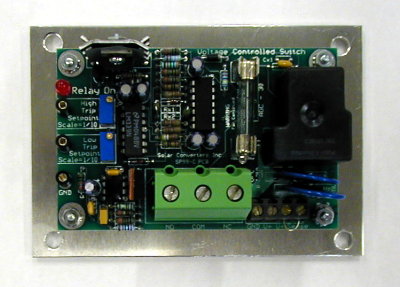

funnily enough jimmy at eirbyte sent me this link this evening , he got one to test out
http://www.solarconverters.com/ss-1.htm
niall

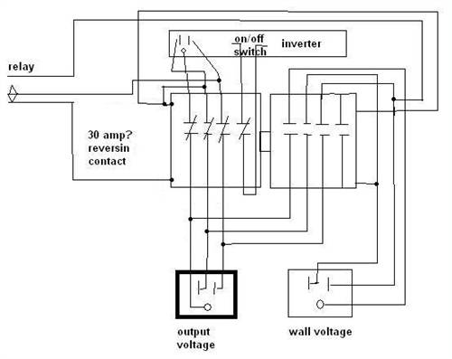

Windman, your ideas are way over my head. I'm looking at the drawings and my head is spinning..
Naill, I called that place up and asked about the controller, but it's only rated for 30 amps. He said I could probably use that relay to switch other relays, but again, over my head..

You know this would make a good project.
What I'm thinking is a battery monitor with a couple of contactors, set to switch at different battery voltages.
One contactor could be set for 12v, the other at 11.8v
The contactors are part of the ac power distribution, one could be for lights, the other for most of the power outlets.
When the battery drops below 12v, one contactor opens and disconnects all the power to the power outlets. So you loose power to the appliances, but still have lights, time to go to bed. If the battery voltage drops below 11.8, the lights go out too, saving the battery.
The inverter is still running, but with no load it will draw minimal power from the batteries.
When the batteries start to charge, the lights will come back on first, and then the power outlets.

If this is still the objective, then a micro would still be the simplest controller. voltage settings and timing are easy to set, and the hysterysis is no problem.
I would switch the AC output from the inverter only. The multi stage could be 3stages, GPO1,GPO2, lights.
The switch box would be powered from the inverter, with an AC connected plugpack. There would only be battery voltage sensing. The unit would plug into the inverter AC outlet and have up to 3 relays. The program would be a loop, with some simple comparison tests that turned ON the relays when a preset voltage was reached. As the voltage dropped, to say 12.5V, relay 1 would turn OFF, and then at 12V relay 2 would turn OFF. at 11.5V relay 3 would turn OFF. All the relays would be reset ON at say 14.5V. If relay 3 was still ON and the voltage started to rise, then this would stay on. Whatever state the relays were in as the voltage started to rise would remain, until the battery was fully charged, when all relays would turn ON, or the battery voltage fell to turn all the relays OFF.
This system would work, but requires a decent battery capacity to reduce the battery cycling rate. This simplified loading control will not be optimum for battery charging, and unless a battery maintenance reigime is in place as well, the battery will suffer reduced capacity over time.
I had a similar system in place and my RE battery suffered reduced capacity. I now use a 4stage battery maintenance reigime, including Boost setting, absorbtion time, and float setting, as well as periodic equalization setting and time.

One thought that comes to mind is a “universal voltage switch” kit put out by Jaycar (cat # KC5377) for AU$32.95
It is a very simple kit with few components.
It allows for a upper voltage limit and a lower voltage limit to be set, and also has adjustable hysteresis. ( the difference between triggering on and off voltage )
I have used this kit in a simular project and works well and by memory the instructions detail the component changes needed to operate for 24v if required.
The output from the on board relay could be wired to switch a heavier duty relay that would switch on a AC mains heater or a low voltage dump load (see making encapsulated resistors on the front page for dump load heating elements)
If a Mains heater was used, I would keep this on a separate line off the inverter output or the relay between the wall socket and the heater so when the heater was off all other appliances like lights etc will still operate as normal.
In this way the batterys could be drawn down to a preset voltage and the heater would switch off and remain off till the preset upper voltage was reached then the heater would switch back on again.
I do like the use of micros but this circuit is reliable and simple with no need for programming abilities to operate or to adjust the upper or lower limits.
Just need a screw drive to adjust the trimpots and a multi meter to read the voltages.
