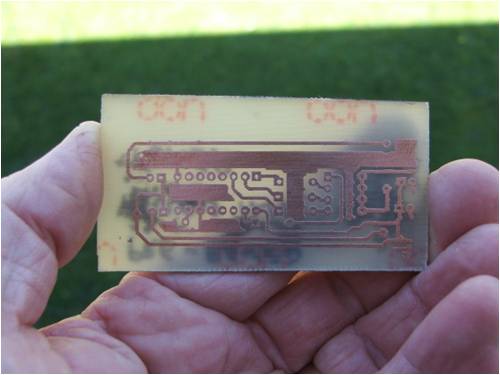

I have been playing around with a modded Epson C63 making direct print PC boards with reasonable success and wonder if anyone has any advice to offer on improving the process.
So far, I have been able to get the best results using the yellow Dura Brite ink and sprinkling it with photocopy black toner while the ink is still wet. This is then fused in an electric frypan.
I have found that pre-baking the cleaned board and allowing it to cool before printing greatly improves the way the wet ink sits on the board.
The latest of the test boards I have made shows little undercutting and good detail but has a small area of etch through on the larger copper areas. I have been etching with warm ferric chloride by rocking in a shallow dish.
The direct printing technique would have to be the quickest and most convenient for making one-off boards. In the past I have experimented with photographic negatives and UV photo resist, resist pens in plotters and toner transfer.

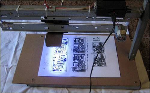

As for that old Epson printer you have, the best thing to do is gutter it and save the carriage mechanism as that is what I used to build a uv light scanner to expose the boards with.

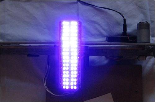

About 20 ultra bright UV leds ( from China ) supply the uv light and the leds chug up and back several passes over the print to expose it then switch off.
This is the second one of these scanners i built and this one i used uv led clusters instead of single leds as it worked out cheaper and was easier but either will work fine.
The first one had only 2 rows of leds and works just as well.
You can use sunlight or fluros at a close distance but they tend to be slow and give a lesser result (10-20 mins with fluros)

I like the idea of using the UV LEDs Pete - might have to adapt one of the old scanners I have. Don't know about 'guttering' the Epson though - paid a whole $5 for it!!!

The photo shows a section of test board straight off KiCad - it's certainly useable.
One thing I have noticed with KiCad is the 'notches' it produces at the corners of the tracks on the printout - does anyone have a 'fix' for this?

Can you provide some more detail (where from/how much/ what wave length) re the UV Led clusters you used. I made up a UV strip using invidual UV Leds and a couple of UV Led clusters (no jokes) would make life easier for the next UV Led scanner.
Thanks,
Darcy
Downwind
Joined: 09/09/2009
Posts: 2333
Posted: 05:22am 26 Oct 2009
Hi Darcy
The leds and clusters were off eBay from Sureelectronics out of China.
I have had no problems with purchases from these guys and it takes 7-10 days to arrive.
All products are good.
The clusters i bought were 24 leds but i needed to take them apart and use in 8 led clusters or it allowed big gaps between the leds.
I would buy the single 8 led clusters next time.
The standard ultra bright uv leds (5mm singles) i used i dont remember the mcd ratting for, but it was high and more than likely from sureelectronics as well, i think they were AU$7.00 for a 100 or there abouts.
I have the leds about 100mm above the board for exposure.
with the leds stationary it takes about 30 seconds to expose through paper but travelling it takes a couple of minutes depending on the distance of travel required.
