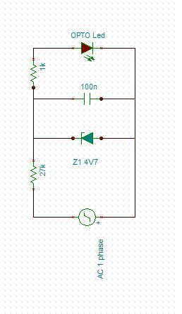

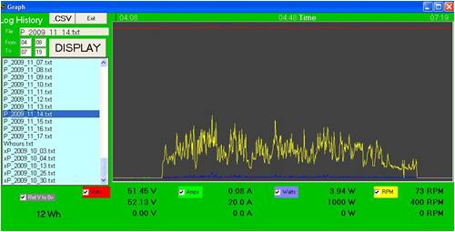

Posted: 10:03am 17 Nov 2009
I measure frequency directly from the AC. I use a cct similar to the simple CCT that Gizmo used. I use a zener across the opto coupler and use some additional filtering. RPM works down to 30rpm, for a 12 magnet rotor. Good enough for me, and works with the caps as well. I have not been too concerned at rpm below 30, as there is no power to record.
Here is a low wind portion of my windmill logging. The RPM is yellow.
You can see that the blue lines [power] drop out before the rpm.
Gordon.

GWatPE
Joined: 01/09/2006
Posts: 2127
Posted: 10:07am 17 Nov 2009
Here is a zoom of the first set of peaks above. The 10sec logging interval does not miss too much.
Gordon.
