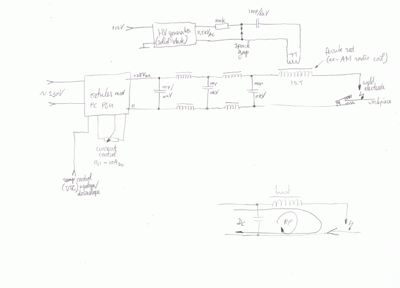

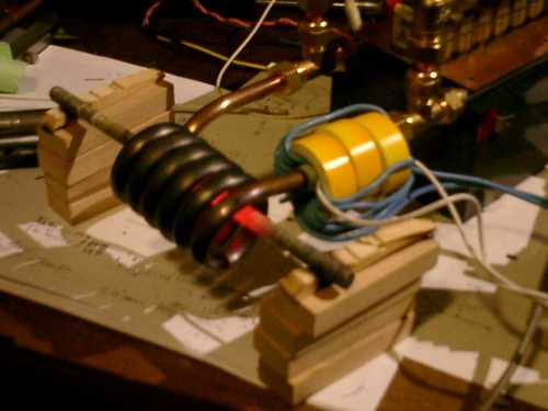

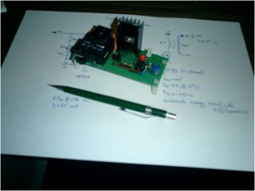

Better start up a proper thread instead of messing up other's posts....

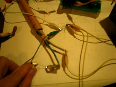

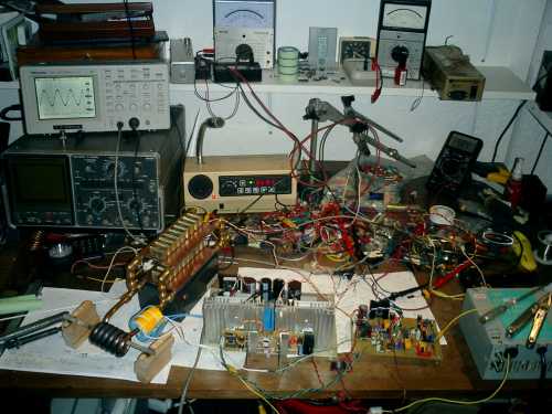

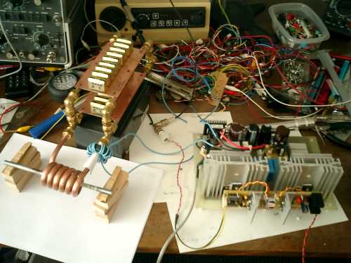

Just did some experimenting, not with the PC PSU but with the arc starting part, the high-voltage generator that superposes a RF high-voltage on the welding current. The trick is to add this HV without blowing up the PC PSU....
Below is the schematic, quickly thrown on a piece of paper. No fancy design, just using some components that were handy. The arcstarter with transformer works, the filter has yet to be built.
Below an image of the gadget, with arcs (one in the spark gap, the other one the actual starting arc):
The nice thing is that it is RF high voltage, so you can't shock yourself with it; same idea as with a Tesla coil. In fact, the arc starter has a lot in common with a Tesla coil.
Now, the trick is to superpose that HV on the welding power supply without blowing it up. By adding the HV in series, rather than parallel to the low-voltage welding current, the problem becomes a lot more manageable.
Also, there's less that can go wrong with transformers than switchmode PSUs, in that respect, but will try the PC PSU as welding current supply first, with proper filtering. I think the filter as I've drawn it is overkill, compared to what I've seen in some commercial designs, but better safe than sorry. I bet a few kV will be one of the few ways to permanently disable one of those PC PSUs....
Lot more experiments to be done, but so far I'm pretty happy with the arc starter, which was basically thrown together on a whim - the HV generator (12Vdc in, 2.5kVac out) was just sitting in a corner of the desk, as I had built it a few weeks ago just for fun, with no particular intention of using it for anything useful:
It uses a flyback transformer from either a laserprinter or copier. Forgot which.
Quickly grabbed a ferrite tuning rod (ex AM radio/SW receiver), wound a transformer, got a spark gap out of one of the drawers (they used to be pretty common in older television sets) and a HV capacitor and threw something together with a few crocodile wires. And it even worked. And kept working after an hour of drawing sparks (HV is fun...)
Drawing arcs from a finger doesn't hurt - no electrical shock, despite the high voltage, but after a few seconds the skin burns due to the heat of the arc. So proves that the arc starter is safe to use in that respect.
Peter. (<-- keeping the electrons flowing)

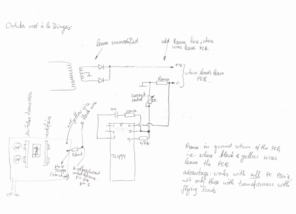

Oztules,
Just did another test on that PSU - without any extra sense resistor apart from the original PCB trace, and with the 2k pot set to zero, it current-limits to 4.4A.
So, if you can live with that (i.e. if you only want to protect the PSU from short circuits), there's no need to add sense resistors to the transformer. This means you can use also those PSUs that do not have one of those flying leads (the ones without flying leads are hard to reliably mechanically fix a sense resistor to).
For my purpose though, I want to be able to reduce current to, say, 100mA, so some added resistance will be needed. Oh - most likely the microTIG will not be made with a PC PSU, but a few transformers and a resistance bank, switched by relais via BCD switches. Neanderthal technology, but less that can go defect in the presence of RF high voltages generated by spark gaps....
Peter. (<-- UGH!)
(that's Neanderthal for 'I just got a RF burn on my index finger and it hurts!')Edited by Dinges 2009-12-13

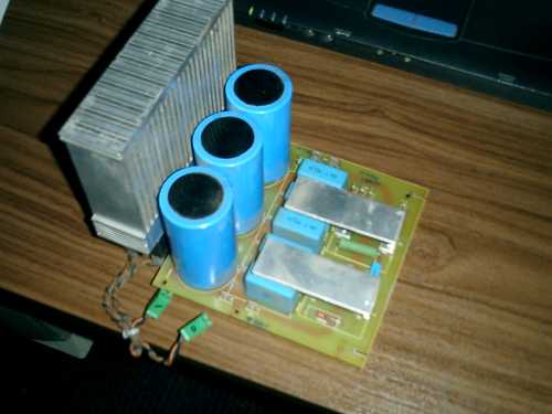

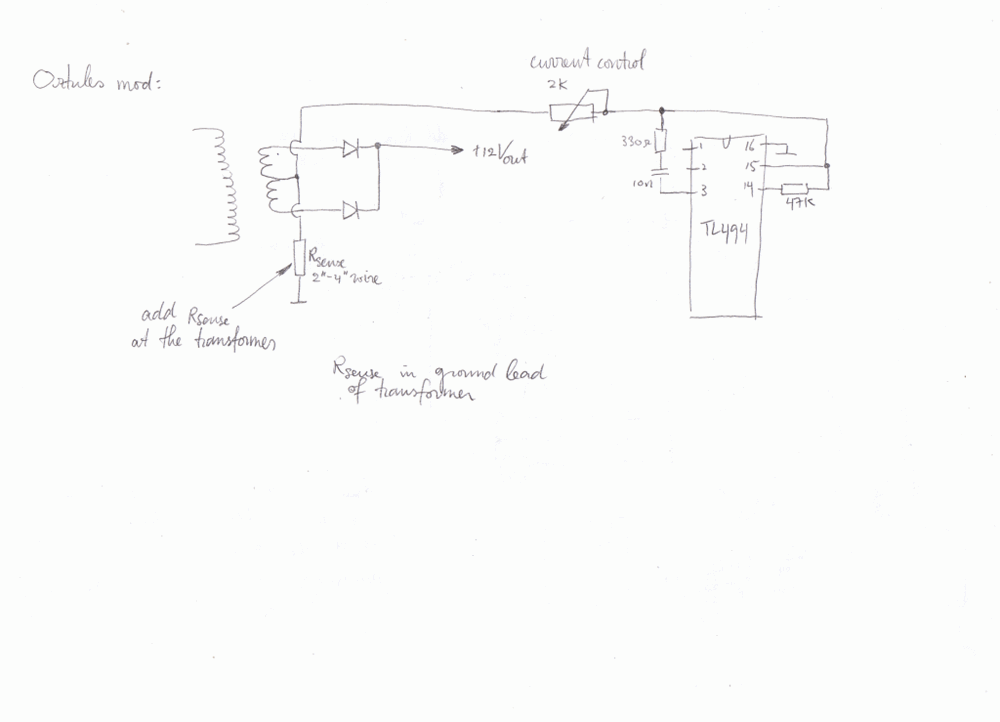

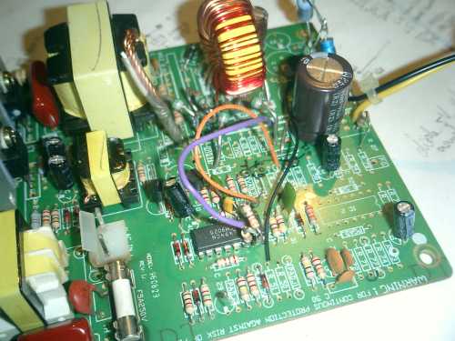

Have drawn a few schematics to make the difference more clear. And the advantage, if I may say so.
The original modification:
Peter's modification of the modification:
The difference is clear: the sense resistor is added in a different place. That's basically all there is to it, but it makes the difference between being able to (easily) convert all PC PSUs for current control, or only those with flying leads.

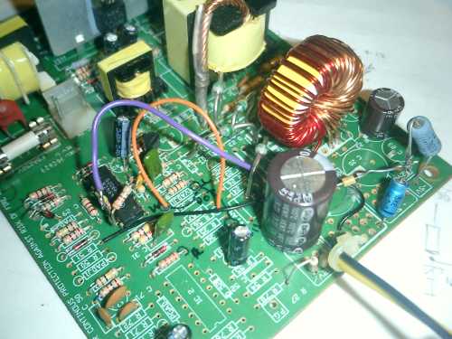

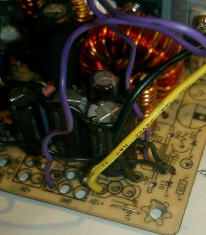

It's possible to install the new Rsense on the PCB, not leaving it floating - when the no longer needed components at the output are removed (+5, -5, -12V), several completely unconnected PCB traces will appear. These can be used to re-route the ground lead, add a shunt resistor (just a bit of wire) and connect the sense wire to the TL494.
In the picture, the purple wire is the sense resistor, which connects from the original ground point of the PCB to a free pad; to that free pad is also soldered the thick black ground wire that leaves the PCB, and the ground for the voltage control potmeter. That's all there is to it - but it allows 100% of PC PSUs to be converted (as long as they have an unused 2nd opamp in the TL494)
Peter.

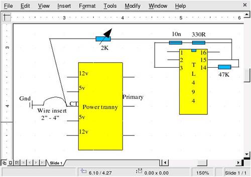

Joined: 26/07/2007
Posts: 1686
Posted: 08:23pm 12 Dec 2009
Dinges,
Looks a good way to modify the non-flying lead types... I have yet to see this type here.... but it must be somewhere I guess.
About these royalties.... I have a sinking feeling I may not see the second half of that candy bar, and you will probably find some fiendish way of seeing off the string... so I guess I will have to wait till next time...wanders off mumbling .......
Interesting project you have there, will it ever do more than boring a hole in your finger you think? (oztules did feel better hearing of your HF/HV injuries )
Well, got another regulator to fix/build so I'm off.
..........oztulesEdited by oztules 2009-12-14

Oztules, about half of my 15 or so PSUs were of the non-flying lead type - wish I had thought of this method before....
It's 1:30 AM now... wasted another perfectly good evening messing with a PC PSU....
After I had performed the finishing touches on the PSU, permanently wiring up the voltage and current control potmeters, adding dabs of hotglue to make things a bit more permanent, etc., I proceeded to 'reliablity test' the supply. Some would say I was just messing about, drawing sparks, but honestly, it was a reliability test....
And the PSU failed. I let the magic smoke out, but only a little.
When the PSU is unloaded and I turn up the voltage all goes fine up till about 7V (on the previous 12V line), after which the PSU becomes unstable. If I turn it up a bit more, it shuts down - the TL494 stops oscillating (no sawtooth on pin 5 (CT) any more), no more output pulses on pin 8 and 11 (outputs of the transistors). Basically, the TL494 stops working - but, power on pin 12 remains a rocksteady 19.09 V, and pin4 (DTC) remains nice and low - which it couldn't be anything else, as both diodes that go to another control IC (LS 16802... doesn't ring a bell for me) are disconnected. Then, I noticed a tiny trace from the Feedback pin (3) of the TL494 to that LS16802, so I disconnected that one too, thinking that maybe it controlled output of the TL494 via pin3 - which it didn't, as the behaviour remained the same - turn up the voltage and, above a certain level, it stops, whilst the TL494 remains powered. Voltage on pin 3 (FB) then drops to zero, which probably makes sense since the oscillator is stopped.
When the PSU is then unplugged and plugged in again after waiting for a few seconds, it can be powered up again (voltage slowly turned up until it becomes unstable again). So looks like there is still some latching going on that disappears at power-off, even though the associate IC (LS16802) is out of the loop, and I don't see any other ways to control the TL494 - how could the *oscillator* stop, fer crying out loud?!
I'm actually beginning to suspect the TL494 now, may replace it tomorrow, as I don't see any other control signals going into the TL494: it remains powered on its pin 12, yet the oscillator stops, even though there's only a R and C on pin 5 and 6 to ground; no extra transistors that could disable the oscillator. Strange. Very strange.
Peter.

oztules
Joined: 26/07/2007
Posts: 1686
Posted: 01:26am 13 Dec 2009
............odd
Try a scope on vcc, and see if there are any spikes>40v making up the 19v rms.. the only thing I can think of that will stop the oscillator would be over voltage cut out. Even though you see 19v, there may be imposed spikes that the chip picks up.... particularly with no loads.
Is it an atx or xt. If XT, then the spurious oscillations may get through from the boot strapping circuit.... and this may be what keeps it alive while shut down is achieved.... long shot.
If not, is there any other chips that could self oscillate and cause spikes into the supply ???
Makes little sense I reckon.
However, I don't know of any other status where the oscillator won't oscillate
.............oztules

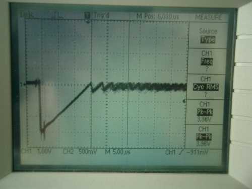

Posted: 01:50pm 14 Dec 2009

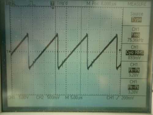

Managed to put the magic smoke back into the little PSU.
Turned out it was the TL494 that was defect. Below an image of the signal on the oscillator pin CT (pin 5) before replacement:
As can be seen, doesn't look healthy.
After exchanging the TL494 for another one the PSU works again, and this is how the oscillator signal looks now:
A few other things that changed about the PSU just by replacing TL494s, and which surprize me:
1). Previously, with the old TL494, the PSU ran unloaded fine. Now, it needs about 250-300mA load to remain stable; without that load, I can turn the voltage up to 29.5V, but when slowly turning it down again, it doesn't respond to the potmeter until well below the set value; in fact, have to turn the potmeter down to 3V before the output voltage drops suddenly from 29.5 to 3.0 V. Adding 110 ohm load cures this.
Now, it's generally good practice to never run a switchmode PSU unloaded. However, I had not expected that this behaviour depended so much on an individual TL494; I was expecting it was more related to other design issues of the power supply.
2). maximum output voltage has increased, from 28.5V originally to 29.3V; again, wouldn't have expected an individual TL494 to have so much impact on this. Probably enough variation in properties to cause this difference (perhaps a fraction of a percent less dead-time?)

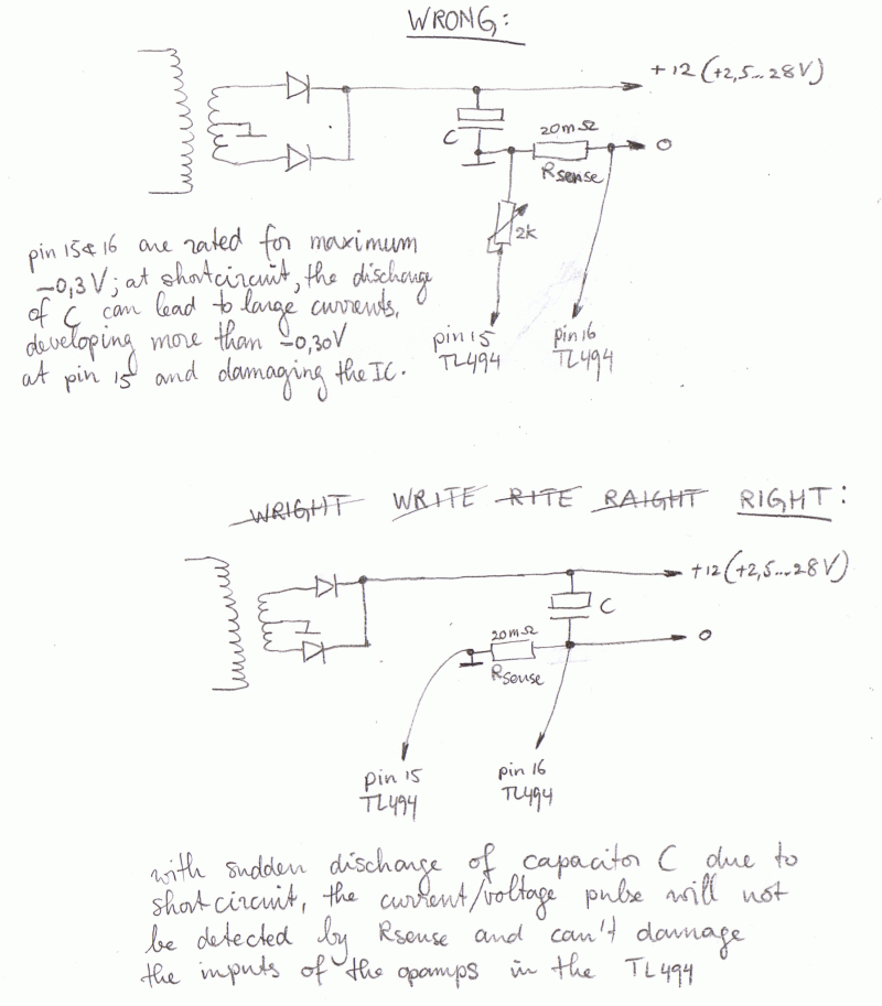

Finally, a circuit diagram to explain what I think went wrong with my implementation of Oztules' modification:
Above is an explanation of what I think caused the TL494 to go defect. In my modification, a short-circuit would discharge the capacitor and could easily draw a current spike of much more than 15A; this would develop more than -0.3V over the sense resistor, which could damage the inputs of the opamps of the TL494, which can't take more than -0.3V (abs.maximum rating).
This current/voltage spike was never an issue with Oztules' original modification, as the sense resistor won't see current spikes of the output capacitor. I haven't tried it yet, but placing the sense resistor in front of the output capacitor ought to solve this problem.

Edit: just ran a test, discharging an identical capacitor (560u/35V charged till 10.7V) over the original shunt resistor (19.6 milli-ohm). It results in a voltage developed over the shunt resistor of slightly over 1V, so a discharge current spike of 50A. Now, this was at 10.7V. At nearly 30V, that spike may be about 3 times as large, yielding a negative voltage of -3.0 V on the opamp inputs. Definitely far above its maximum rating.Edited by Dinges 2009-12-16

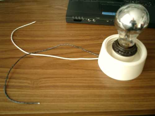

Plugging the PC powersupply in without a voltage present on the Vcc (pin 12) of the TL494 causes loud bangs and magic smoke to escape. See image below for those components who valiantly offered their life for the benefit of the advancement of science:
(and here's the noble, undervalued incandescent lightbulb that now offers its services for the protection of the replacement semiconductors:)
So, in short, the question is: how did you go about this business of powering the TL494, if you've done a 5-55V modification yourself yet?
