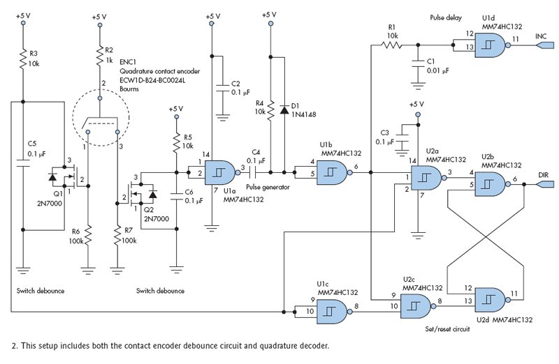

About two weeks ago I looked into using a rotary encoder to control something. Decided in the end not to go through with it but use BCD switches, but I did find this simple schematic, that decodes the 2 signals from a quadrature encoder into a direction signal and a pulse/clock signal:
taken from here: http://electronicdesign.com/Articles/Index.cfm?ArticleID=214 22
All with discrete electronics, no microcontrollers, PICs, Atmels, 68XX, etc.etc.
In your case it looks like the debouncing part will not be required.
What you have is not really a quadrature-encoded signal (phases are not 90 deg off, but 120 deg), but perhaps the circuit can still be useful by using only two phases? Shouldn't take too long to make a test setup on some breadboard and try it out.
Keep in mind that if you use it for a direction sensor, it may lose track over time (there's a discussion in that thread on this very topic; see the reader comments). I think that for the direction sensor you'd be better off with some kind of absolute encoder, such as Gray code, unless you find a way to periodically re-synchronize the 'rotary encoder' (harddisk motor).

Peter,
Think i will give it a go in Picaxe as need the signal to be translated further in program after decoding anyways.
I do have a picaxe program written for decoding a rotary encoder (standard off shelf 3 pin encoder) should you need to use a encoder in picaxe.
Give me a pm and i will send it to you. It could save a few hours of messing around.
Useless if you dont have an application for it.
Yes its a good point on loosing position.
You just made me realize that on start up it will need to be indexed to some point each time. Bugger!
With that being the case it would be just as easy to stick with photo interrupters and run 2 to get positioning.
The last hdd i drilled holes in the disc and it works well plus easy to drill. (only 1 sensor)
Just need 2 holes to line up with the 2 sensors together in the ring of holes, to be use as a set refferance point.
All other holes will be spaced to only allow 1 sensor to be active at a time.
If the sensors were faced due North in mounting, every time the 2 sensors were active together it would reset the direction to north in the micro.
Be also easy logic to decode for direction.
The number of sectors per 360 deg is also selectable.
Bugger Peter, its now do-able, so back out the too hard basket and onto the project list.
Thanks for the circuit input, its always good to see little circuit ideas.
