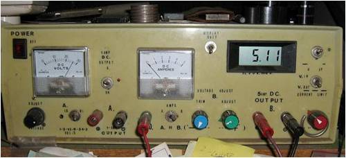

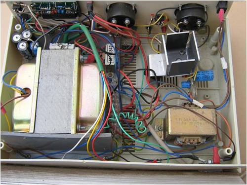

In response to another thread on this power supply i will add some photos of the original one i built over 2 decades ago and still use today.
It was constructed back when my electronic skills and abilitys were a lot less than they are today and upon opening the enclosure for the first time in over 15 years it was a trip down memory lane of what was inside.
When it was constructed i used 2 seperate power supplies and seperate voltage regulators 1 being the LM-723 as per detailed above and the other a LM-317 for lighter applications where i needed two different voltages.
Over time the LM-317 has died (or more like been killed) and had never really found a use for the need for 2 supplies, so would not recommend the need for the LM-317.
The heat sink was salvaged from some other appliance but i dont remember what it was.
Although the supply will go to 10 amp the amp meter is only 5 amp and has spent some time at FSD but rearly there is a use for more than 5 amp.
A 3rd small (tiny) transformer was also used to power the LCD display as it could not use a common supply to the voltage being monitored.

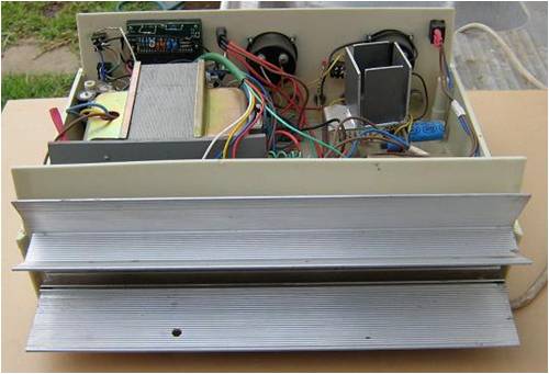

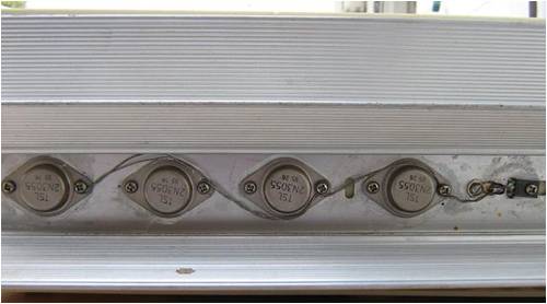

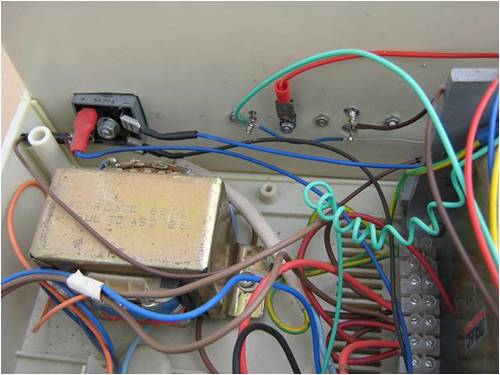

Heres a view of the rats nest inside
The heat sink is rather large but it was what i found when constructing the supply
The transistors are all mounted on the outside with their legs protruding into the box.
The bridge rectifier is also mounted through the back panel onto the heatsink.

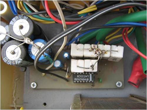

The main circuit with the LM-723 was crammed onto a small pcb with the 5 watt resistors and capacitor filtering mounted vertically.
Not the neatest work i have done.

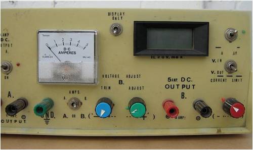

This is the 1/2 of the front panel that relates to the 10 amp power supply.
I have used 2 pots in series for voltage ajustment (blue and green) as one acts as the main full scale adjustment and the second as a trim adjustment for fine tuning applications like setting up a voltage controller.
The red knob is for setting the maximum amps output and for most test work it pays to set it low so if a circuit problem is evident the current is limited and often the magic smoke is retained in the circuit.
There is switches for reading voltage in to the display from a circuit, but never used it and is a waste of time adding it.
The binding posts for the banana plugs is for power out and are handy to be able to attach a multimeter probe to from time to time.
The green binding post is connected to the mains earth for a ground point but never really used.
A greed led shows when the output is switched on and is a very handy indicator. This is fed by a seperate supply used for the lcd meter and switched with the second half of a DPDT toggle switch used to control the DC output.
A power cable with aligator clips on the end make up the power out cable.
Thats it!!

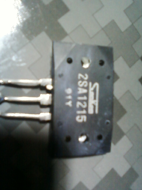

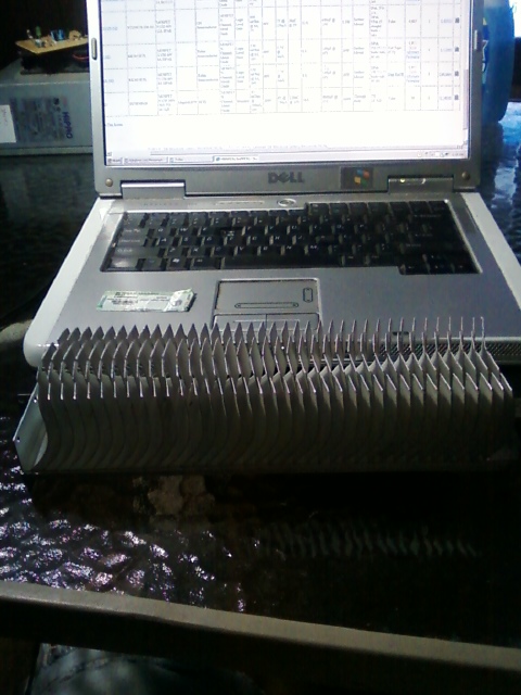

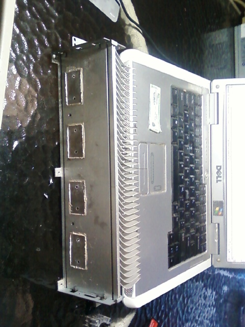

Hey Dw, do they make those 3055's in a flat style? The HS I got is not a very good type for that package. I will try to post some pics of it as well as the amps that were in that kenwood
the are 2sa1215 looks like they were made by a company called sanken???
Anyways I will try to get a few pics of some of the ones I have.

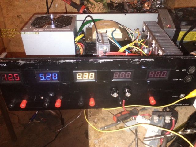

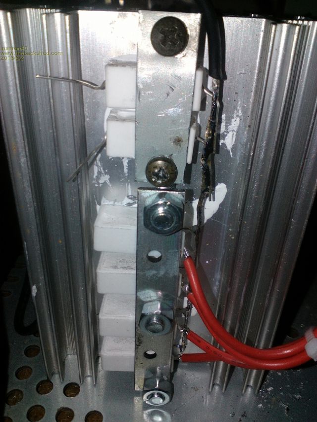

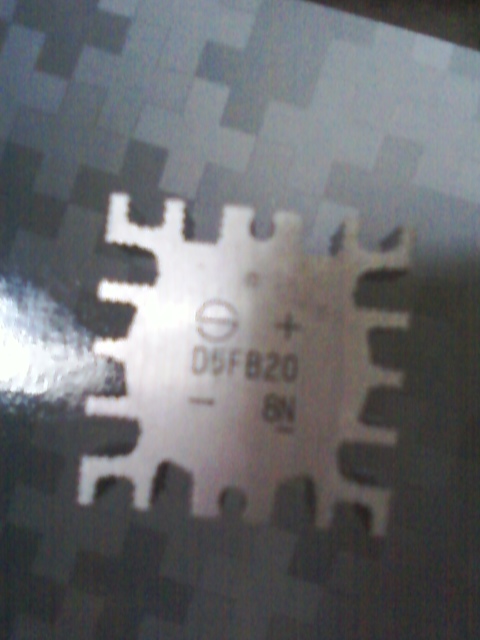

This is an image of the power amps out of that box. There ae 4 of them.
This is a pic of the bridge rectifier out of it. It has the heatsink built into it. The 50v 25a ones I have don't. I wonder how many amp this one can handle.
Here is 2 views of the Heatsink. This is why I asked about different power amps. Notice the 3055's can't be installed to this without major modding to the heatsink.

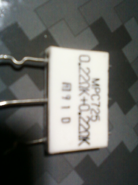

And lastly what the heck is this thing?
It looks like some sort of double resistor? I haven't thrown a dmm on it yet, but am going to after I look at this xformer from one of the pieces to see the output voltage.
Don't you think Free/Renewable energy should be mandatory in new buildings?

Hi Ready,
Yes they do make a transistor in a flat pack and one part number is MJE-3055T its in a TO-220 package.
The What the heck?? question ....is a double 0.22 ohm ceramic resistor (proberly about 5 watt) with the centre leg common to both resistors.
Try using Datasheetcatalog.com to look up the part numbers
It is free to use and a very good site for finding data on stuff.
http://www.datasheetcatalog.com/
If there is dashes and spaces in a part number leave them out when you enter the number in the search window.....enter all digits in one string.
I had a look and did not find the rectifier with the number shown in the photo.
The heat sink looks more than enough and could be under half that size, but like me we use what we have as its cheap.
The transistor you pictured is a PnP type and not much good for this build.
Heres the data sheet on it.
http://www.datasheetcatalog.org/datasheet/mospec/2SA1215.pdf
Pete.Edited by Downwind 2010-05-29
