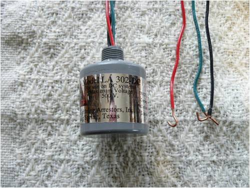

Interested in lighting protection. I have an extra lighting arrestor for one of my PV arrays that I would like to use for my mill. The wiring is relatively easy for a PV system red postive, black negative, green ground. Normally this arrestor would be mounted at or near the PV array, just wondering if I can use it on my mill. I do charge a 48 volt battery system.
Pictures are not that great,
Specs are
Delta LA 302-DC Max voltage 500v.
Cant help thinking that if I wire the arrestor at the battery end of things by the time a lighting strike hits any and every thing from the mill to the battery will be gone.
In case your wondering no I haven't grounded my mill with a ground rod at the base of the tower. Ground is frozen at this time of year.

I have a three-phase arrestor from Delta. I have spoken with the company in the past, and each lead is connected to a variant of a MOV (metal oxide varistor) which conducts once a critical voltage is reached. Each lead is connected to each phase, with the ground going to an 8' copper rod. I have two of my four tower guys connected to an 8' grounding rod. My tower pole is connected to an 8' grounding rod.
You can see here that I put a faraday cage around my rotor. This was the old way I did it. My current turbine has the cage completely surrounding the rotor and wiring on top. My hope is lightning will hit the cage and go to ground before hitting the wiring. I don't know if it will work, but it will at least serve as a safety net in case one of the magnets gets loose and tries to fly off.Edited by imsmooth 2010-01-22
