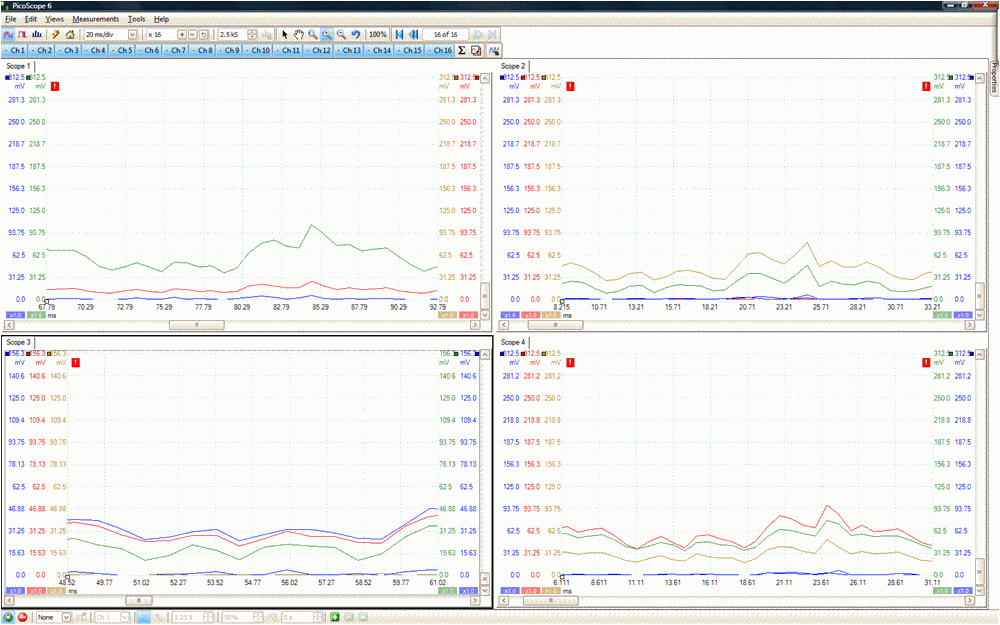

Here is a sample graph.
This is viewing/logging 16 channels. Window 1 is channels 1-4. window2 is channel1 and channels 5-8. window3 is channel1 and channels 9-12. Window4 is channel1 and channels 13-16.
The unit can do all of this and measure at 200uS/div.
I have just modified a clamp meter for AC current. I intend to convert this to a linear DC output. So far it gives 1.2VAC for 9.3ACA. This will easily give 0-20A with <10mA resolution.
have a bit of work yet with scaling and signal conditioning, to bring the signals down to 2.5V levels, to suite the ADC input max.
I still have to set up with a test signal, to confirm the timebase is the same across all inputs.
