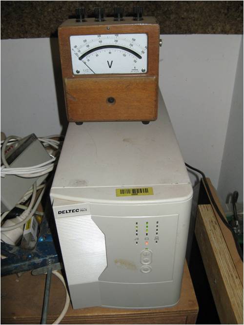

Hi,
Switching on my UPS means closing the blade switch to the battery and only then switching on the mains. I have been told to do it the other way around will blow the UPS.
Switching the battery in is frightening enough and makes me wonder if I can do that repeatedly without smoke escaping.
Why would the UPS blow if mains are switched in first followed by the battery?

Hi Dom,
the UPS electronics needs a stable DC supply. There may be battery recharging circuitry that attempts to fill the main 50Hz bypass caps, that is a poor substitute for a battery. There will be AC ripple, that would probably confuse the UPS. Better to provide the right battery. UPS become problamatic as the battery ages, and I had a UPS die when the battery dryed out. Was OK until that point, so no battery, no go.

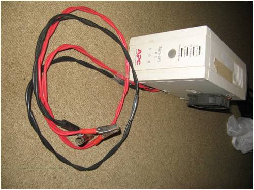

Actually UPS make quite good inverters:
We've had a couple of the desktop APC unit fail in such a way that the battery charging part of the UPS stops working but the inverter bit still works fine...
So i've extended the battery leads, chucked an 80mm PC fan on the side of the case to keep it cool and i have 200w of power on tap where ever there is 12v available!!
These small UPS's have a square wave output, but it can still power heaps of stuff: incandesacent lights, CFL's phone chargers, laptop's ect
Used it when we went camping on kangaroo island earier this year, (used the car battery as 12v power)
Even used it to run a small cheast freezer when the wife's uncle moved house and the twits at ETSA couldn't put the power on for a day or two...

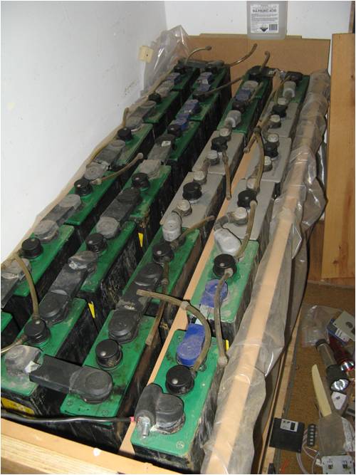

I have a 48V 2.2KVA UPS that will form part of the main RE system at home:
The power that comes out of it is more sinusoidal than what comes out of the grid.
It will easily start and run our 1HP induction motor water pumps, run the washing machine, breezeair evaporative A/C, fridge
Down side is it does use about 30W (720Wh/day) with no AC loads connected. but i'm planning to replace some of the linear regs 7824, 7812 inside the unit to get this down abit.
I have it hooked up to a 48V 620Ah battery bank that i got 2nd hand from the electric forklift at work.
The bottle at the end of the bank is just water, NOT sulfuric acid
Just waiting till winter so i can get a F&P smart drive micro hydro generator running and actually make the whole rig work to offset our grid useage

Those batteries look like 2V lead/acids and may not be SLAs. If so, I noticed the charging voltage of any UPS would be lower or too low for lead/acids as they normally meant to charge SLAs and SLAs appear to get charged to a lower voltage.
How did you get around that problem or is it not a problem anyway, as the batts are really SLAs??
Winston Churchill
SSW_squall
Joined: 20/03/2010
Posts: 111
Posted: 01:48pm 29 Mar 2010
HI Dom,
The batteries i have are the flooded or wet cell type, not SLA's. As you may be able to see in the photo there is plastic sheeting under and around the bank to preavent any acid spills from damaging anything.
At the moment the UPS keeps the battery on float at approx 55.4v with out any problems (13.85v refered to 12v battery).
This is a normal float voltage for both SLA and wet cell types at nominal temp of 20deg C.
The battery bank is inside downstairs such that the temperature is more stable, as batteries perform best when kept at a stable temperature.
I have a rectifier/filter caps that i can connect to my GMC stick welder to push 10A or more into the bank.
This allows the voltage to be increased to 57.6v (14.4v refered to a 12v batery) absorb voltage or even higher 60v which is the equalization level.
The bank really starts fizz at these voltages, not a bad thing to do once in a while: de stratifies the acid, reduces suphation...

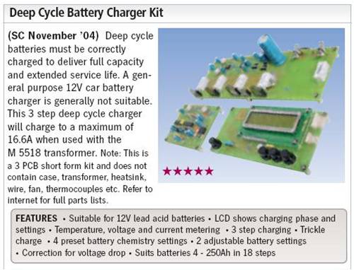

the lack of a battery maintenance reigime, as indicated by your explanation of how these APC units recharge the battery is a good indication of why so many suffer battery failure. What you describe is a current limited voltage regulated supply, and this will result in a reduction of battery capacity, each tiome the battery is discharged. This includes mini cycles. The standby current of UPS's, for their capacity negates them from typical RE use. As a mains operated appliance they consume approx 15-20W. This is approx 0.4kWhr/day. In an RE system, this is approx the power from an 75W solar panel, and this is before any useful work is done.
I have 2 UPS, not connected, and no battery installed, just an anderson connector that can connect to my main battery. These are purely spares, in case my real inverter needs service.
BTW compare the power in standby of an RE inverter of 50mA @ 24V, to the 15-20W of a typical UPS, that cannot offer a standby feature.
Gordon.
PS edit:
For a little suport to my comments above, this should help.
