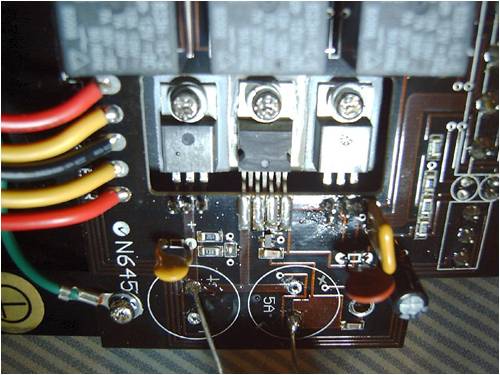

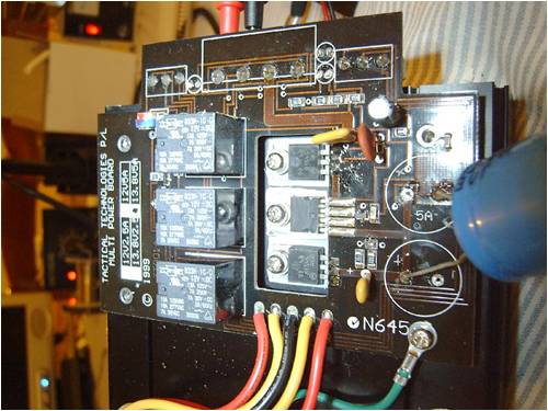

G'day all,
we use this particular species of 13.8Vdc 5Amp power supply a lot in the security industry. The brand has a very good reputation and is usually only killed by abuse. Normally we just replace a faulty unit with a new one and charge accordingly, but I thought I'd open one up and see what makes it tick.
This one has a faulty regulator as it outputs full rectified voltage. I have tested everything else and compared it to another unit.
However, the regulator is a TO-220 7-pin package and the markings have been deliberately scrubbed off. I searched for a few hours on Google for anything that would fit the bill, but alas only switching regulators come close. This PSU is not designed as a switching regulator as it lacks the necessary inductor, rectifier and output caps etc... it’s just an ultra low drop out series reg.
Anyone got a clue as to what it is?
A new one of these is ~$400
sPuDd..

Thanks Gizmo,
I'm thinking I might mod the unit and fit an LM338T which is rated for 5amps continuous and 7amps peak in a TO-220 package.
sPuDd..

What is the 2 components either side of the vreg.
I am guessing they might be bypass transistors.
Pete.

sPuDd
Joined: 10/07/2007
Posts: 251
Posted: 02:11am 04 Apr 2010
Bryan,
no inductor - its a series regulator.
Pete,
the side devices are twin schottky packs that form two half wave rectifiers.
Russ,
that was one of the devices I found during my search, but its a switch mode device which will not do.
I'll trace out the circuit then mod it for an LM338T. I've got several of them laying about. Just thought someone may have seen a 7-pin TO-220 series reg used somewhere else.
