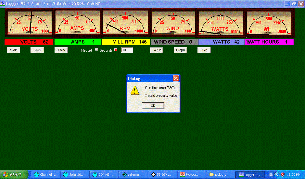

I modified Glenn's Piclog software and added in analog meters i have two versions of it
You can download both here, unzip and put both exe files in your Piclog Folder

Hi windman,
I have been unable to run your program. It seems that the underlying bugs are still there.
The analogue meters are good, but take up a lot of space on the screen. I hardly ever use the real time window, as most of the time I minimize the app to the task bar. I have 6 other logging systems running when I tried to run this new prog.
You may have seen the error in this pic as well.
Gordon.

Yes I Have Seen That Error with the old Piclog and this New one all i do is Close It wait a few seconds And reopen It, It has something to do with the Timers in the Program i think , But It All Work Ok So I ignored the message and restated it some time a few restarts, i did get less errors if i had VSrcoll under timer 2 but i didnt like the way it would reset to 0 every few minutes.
Il look into this at a later time, as it does work now.

ok i spent alot of time on this last night going threw the code and i could not see anything to cause that error 308 that some of you seem to be getting.
I remember that same error when i first used the orginal Piclog but after a few restarts it went away and the only error i would get after that was a runtime error now and then.
after i mod the picloc for the analog meters and debug all the problems out I did get the error 308 1 time only, but never got it again.
so I Loaded this in 5 diff computers all xp diff versions and put the MSCOMM in the system32 and then open the new logger, 3 computers no problem at all 1 computer gave me the 308 error 1 time and never again, the 5th computer i restarted the logger a bunch of time but it would not run with out erroring out (308) error, Ok i have 4 computers that the new logger has no problem running and 1 computer i cant get it to run with out erroring out,
Ran a Registry Cleaner And now The 5th computer runs the new analog logger with no problem, but i dont have any of the 5 computers hook up to com port for data.

opps i ment 380 error in above post
I would like to know how many are having the 380 error problem, and how many are not having any problems and if you are but you can get it to run then try , unclick. startup auto in programs and unclick html ,excel,rpm,wind.

Windman you could try using this updated routine in the Main.frm. Just delete the old MSComm1_OnCom() routine and paste this one in.

It has better data validity checking.
You program works OK on my PC's. I dug up my old PicLog this morning and connected it to a variable power supply and a old WinXP pc.

Hi Glenn,
IT WORKS !!!!!!
Who you calling and ...Old slow computer????
I also had a checksum in the string i tested it with, this did not effect to operation.
Hopefully thats 1 dead bug.
Pete.

Ok tested Glenns revised piclog on a 12v computer i have that is from the 98 series now running XP.
Its a Sloooow computer with the brains of an ant.
It work well for data logging and simple workshop monitoring.
The revised edition of piclog loaded and works well, where previous unmodfied versions of piclog would crash.
Although i have had several versions of piclog that would work but throught a 24 hour period they would generate a runtime error and crash.
This is regardless of the computer used....fast or slow.
Gordons latest developments in logging software has none of these problems, and has not crashed or recorded a data error in the weeks its been running.
Then he has started from scratch and no longer uses piclog in the software.
It will be good to have the choices of several viewing platforms that will all work with a standard picaxe data string as used in piclog.
I think it is good to retain this data format by all who develops a version of logging software.
This enables us to chop and change between sofware packages without the need to program the picaxe to suit different software.
Pete.
