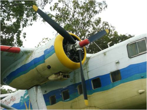

Wooden blades are nice and efficient but worry me as the expansion and contraction of the blade at the attachment can stress the retaining bolts or leave them rattling loose
We have this problem all the time with wood props on aircraft. Even when fitted with breville washers and doweled retainer plates I have seen them come loose, where they are on the ground and inspected all the time its not a big problem but when they are meters in the air and come down once a year for a service it isn't so ideal.
This propeller turns at Max 2200 rpm and weighs 240 Kg and absorbs 650 HP but being strong enough thats no problem, it's just under 4 meters in diameter so my point is that if things are strong enough all will be OK.

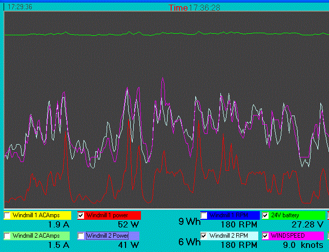

The latest testing has confirmed the windmill is tracking the wind energy very closely in the lower windspeed region. The upper windspeed loading is not quite right yet, and can only be configured when the windspeeds allow.
Here is a plot of the rpm and power and windspeed for some low windspeeds. The data is approx 4data points averaged, and logged every 2 secs. There are more data points at higher windspeeds. I have had to modify my windmill analyzer to dispay time periods down to second intervals. This is a 60fold increase in graph timing resolution.
The light blue and pink graphs, are windspeed and rpm. The windmill rpm is closely tracking the windspeed for most of the test. This means the tsr is being maintained at close to optimum. There is a slight variation in the measured current, affecting the power. The filter on the current sensor has a time constant, that slows the response of the hall current sensor. This creates a hysterisis that retards the rising true current for increasing current giving a lower measured reading, and for decreasing current, gives a higher measured reading. I have seen this effect in real time on the power v rpm graph. The windmill is actually tracking the wind energy better than the measurements can show.
I have to be patient and wait for some stronger winds so the high windspeed power curve can be optimized.
