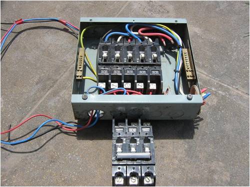

The other nice thing with these switches is they have large wire terminals and are all able to be mounted neatly on a din rail within an enclosure.
My lot costed $10.00 with the enclosure included. (several not shown)

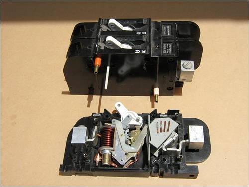

First you need to drill the head off one end of the 2 brass rivets holding the block together and remove the pin ganging the 3 switch levers together.
(that is if you have a 3 phase circuit breaker module)
Separate each of the 3 breakers so they are 3 single breakers.
Drill the heads off the 4 brass rivets holding each of the 2 switch halves together.
Press the rivets out slightly and then drill the bakelite housing a fraction deeper to allow for the rivet to be reused and re-riveted again.
Part the 2 halves of the switch gently.

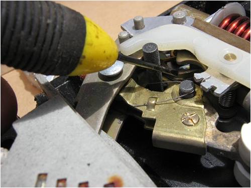

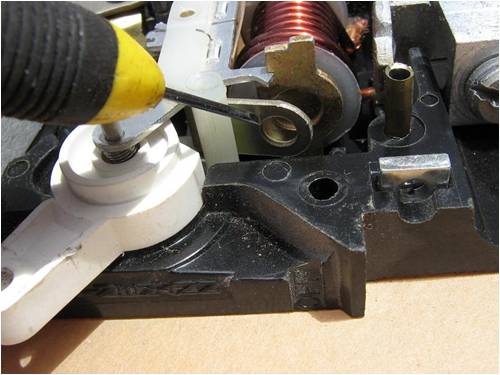

Move the switch to the closed position and then press down on the plate over the end of the coil, while watching the trip mechanism within the switch.
Magnet plate over coil.
Trip Mechanism lever in switch

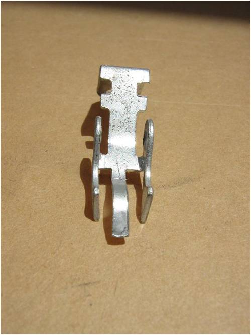

This is what the mechanism looks like, and it’s the little curved lever at the bottom than needs to be bent back.
With a screwdriver gently bend the mechanism back within the switch without removing it, then closed the switch again and try pressing down the plate over the coil, this time the switch should stay latched and not trip as it did previous
