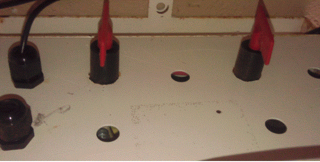

What I did - and which I'm perfectly happy with - was to get some heavy duty battery isolators as used in boats, RVs etc, and use them. I have 3 strings, each of 500AH 48V, and used 3 of these switches. It allows me to connect 1, 2 or 3 banks (or potentially isolate everything, but I've never wanted that) - and the flexability to use any combination of banks.
I normally leave all 3 banks connected now, I'd only isolate one for testing or if working on it, but when I used to switch between banks, the relatively short period of time from closing one switch and opening another while changing banks, was only a few seconds (long enough to use the clamp meter to be sure the new bank was taking load).
The switches I have are rated for 500 amps - I think thats generous - but each has a 200 amp HRC fuse immediately adjacent to it (and in series with it) - so the switch should be pretty safe even in the unlikely event of very large voltage differences between banks causing lots of current to flow.
(click on images for larger view)
The switches were about $20 each.

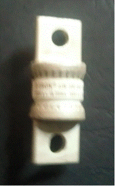

I have 100A Fuses like these inline as well.
My batteries are connected in parallel, and the isolates are only used when servicing the batteries.
The problem with SSRelay isolates is that the mosfet outputs normally used for DC is the diode that is part of the mosfert. The relay only blocks current one way.
I would not opt for electronic switching for reasons similar to those that Ross has given. Most quality inverters have a specific shutdown procedure, and should not be just turned OFF AdHok.
