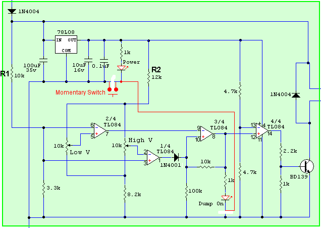

I am a new user of wind/solar power and I love DIY projects. I have been 'lurking' around this site for a while, and decided to build thet TL084 charge controller. It works great! However, since I have the controller in a one room cabin and the LED's are quite bright at night in this remote location, I was wondering if anyone could tell me if there is a way to change the wiring so that the LEDs operate on a push button.
That is, have the charge controller work per normal, but allow me to push a button to check the status via the LED (dump vs. charge). [In this case the LED's are off, until a pushbottun is pressed).

Fair enough request. I recently used one of Petes circuit boards with a very bright blue LED that flashed every couple of seconds. At night, the LED lit up the whole house! I swapped it for a old weak green LED.
The circuit below should work. Basically, break the -ve side ( cathode ) of each LED and run them together through a single momentary push button switch. New connections shown in red.
My only concern is switching the dump load LED in and out may have a small effect on how the circuit operates, only testing will show for sure, but chances are it will work perfectly. I havn't tested this.

I assume that I can return both legs of the LEDs to a single common spot on the board?
I am not sure if there is a veroboard convention for naming places, so I'll describe what I am about to try. Looking at the veroboard layout on the web (very similar to mine), I'm going to call the common vertical column that both LEDs are in as "B". Following this, POWER LED is in B6-B7 and DUMP LED is in B17-B18. Correct me if I am wrong, but I should be able to unsolder B6 and B17 and wire them to a momentary switch. Then return the output from the momentary switch to either B6 or B17.
Yet another newbie question:
So the switch is now on the "inflow" side of electrons? The general *current* convention for the flow of electricity is to reference the frame of "moving" positive charge, true?

Posted: 01:17am 19 Jan 2011
if your talking about this image:
then its b5-b6 (instead of b6-b7). But apart from that yes, what you've proposed will work.
The way I think about it is the switch is interupting the flow of current from the + of the power source to the - of the power source. Once you press the switch, current can then flow, completing the circuit. dunno if that helps, its just what works for me.

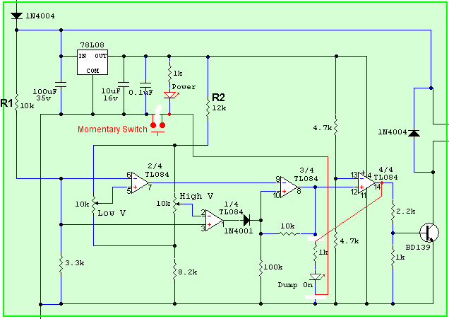

  Gizmo said  .............My only concern is switching the dump load LED in and out may have a small effect on how the circuit operates, only testing will show for sure, but chances are it will work perfectly. I havn't tested this.
Just move the anode resistor of the dump led to TL084 4/4 pin 14.

Posted: 12:19pm 19 Jan 2011
Powderednut,
Thanks! I will try this soon (by friday) and report.

Robb,
Ok ... I'm new to electronics. I assume you are refering to the 1k resistor, but I am not sure I follow what you are suggesting I do with it. Sorry.
Kindly,
Matt
Posted: 01:13pm 19 Jan 2011
Yeah thanks Rob, that should work too.
Posted: 01:17pm 19 Jan 2011
This is what Rob means. The circuit is starting to look messy, but you should get the drift.
