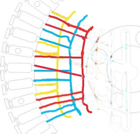

Again I'm uncertain of what I think is right, so I'm asking for help again.
Is this how to wire a 1 pole 3 phase delta?
If so is this the right choice for a petrol gen using a 3.5 hp motor?
I would love to use a 100 but I only have 80 stators.

Well yes, you could do it that way if you connected the yellow bus with the pink bus, the red with the voilot, and the blue with the grey. Your arrangment could also be changed to star by connecting pink voilot and grey buss together. More versitile yet more wires.
A simpler dedicated Delta could look like this: .
As to the motor, I'm not sure what your trying to do. If it's to turn the 3phase_single pole_delta, I guess it's ok, adjusting your gearing up til you run out of power. I've no experience here to know what ratio suits.

Well, bugger me. Thanks Gill for saving me the extra wiring. Bloody legend.
It works a treat. The ammeter I put on there goes to 50 amps and at half throttle it went off the scale. It idles at 8a, and effortlessly does 30 amps at slightly above idle. I wish the mill did that.
The volts on the batteries was a little high 16+ so I ran the inverter with a 1000 watt load and it brings it down to around 14.5-16v depending on speed of the honda.
Is there any other way to keep the amps up and lower the volts?

The way I see it, your single pole Delta gives you lowest voltage with highest current. The only other thing is, to do that with a series100 stator. Is this genny for your monthly equalization charge? My battery manufacturer suggests 7% of the amp hour rating for 3 hours after reaching full charge (temp allowing). So for me that's 70amps, and where do you get a 70amp battery charger cheep? I had a couple of 150amp diodes in the junk box so rewired the secondry of an arc welder. Works like a charm with variable amp output too. Trouble is i'm a bit slack and skip the monthly equalization so my battery is sulphating.

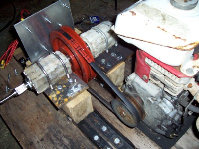

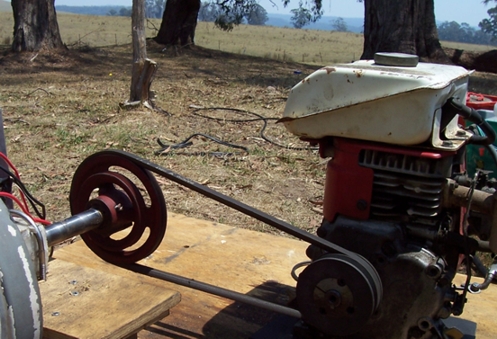

From a mechanical point of view, its best to keep the pulleys as close to the generator (and engine)as possible, otherwise you may find the drive shaft will fall off through stress. Where the pulley is currently mounted on the end of the shaft of the genny, this allows the shaft to flex (even the minute amount is eventually harmful) so will slowly fracture the shaft. Alternatively mount a bearing by the pulley.
May possibly also help to have a bigger pulley on the motor than on the generator, thus gearing it up. This will avoid over revving the engine and possibly save fuel.

G'day Steve, thanks for that.
I knocked that up out of bits lying around. The end of the shaft has a star with a smaller od, which happened to fit the pulley I had.
I agree placing the pulley closer to the gen would be better, but haven't got around to it yet.
I think the gearing is about right, it makes 80+ amps so with that load it creates quite a strain on the motor, it's petrol not diesel so it may not have the torque if it's geared up any higher.
Dunno still works well though.
It looks a bit different now, the stator is on rails to adjust the tension, a work in progress.

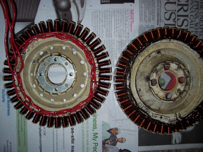

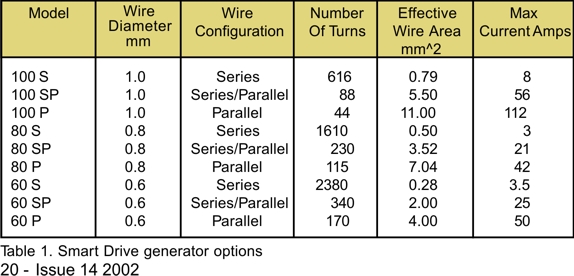

The problem I have is the new 1mm stator I rewired exactly the same as the .8mm has dropped away in power dramatically. I revved it way harder than before and got a max of 60 amps. The old .8mm gave me well over 80 amps with much lower revs.
This is a table from ecoinnovation
The 100p, is that 1 pole delta?

G'day highlander,
Something seems wrong with those figures from ecoinnovation.
I would have expected the current to be progressive as it dropped in wire size. The number of turns seem right.
I guess you have checked for rubbing wires in your modification so got me wondering too.

G'day Gill,
Just went over it again fo 1/2 hour, looks fine.
When it runs on the gen nothing is getting overly warm so that also indicates no short, also with the belt off, it spins fine.
I just noticed that ecoinnovation table has the highest output of an 80, which is the 80p is listed at 42 amps.
But I was getting well over 80amps.
One other thing, the 1mm has much, much lower voltage.
At the rev's I would normally get 10amps from the .8mm the 1mm wasn't even making 14v.
The only thing I can think of is it needs to be revved way over 1000rpm.
I'll just put the 80 back on. Edited by Highlander 2007-06-26

Posted: 08:14am 29 Jun 2007
Well this really had me stumped, so I emailed ecoinn.
Q: The table I got off your site shows a 100p as 112 amps is that 12 or 24v?
A: "It is the maximum possible, voltage does not matter. You just have to spin it twice as fast, too fast and you kill the unit
At 1500 rpm 40 amps at 24vdc or 80 amps at 12vdc is possible."
End of quote.
So you can theoretically get 112 amps but you have to spin it so fast, it will probably self destruct.
It appears that the 80 is actually better as I was getting 80+ amps at way lower rev's.
