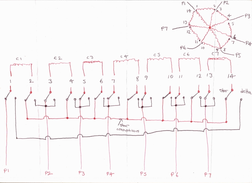

hi all worked out a circuit using 14 car relays or 7 dpdt with low pull in current, i got 268 watts with it on my petrol engined test bench and dropped 2 amps on low revs using a 7p 2p 80 series stator wired in star. ill get highlander to post the circuit once ive tested it

Why that many relays, one car horn relay can handle 30 or so Amps?

Well, I don't have the diagrams or pics yet but if the 3 phase needs 6 wires for a star delta, then a 7 phase would need 14 wires for a star delta, I think.
Is that what you've done Matt?

hi all   tried 7 phase 8o series 7p 2p wiring in star and got 11 amps @ 25.6 volts great it works took it of the 5hp test bench undid the star connections on the wires for star and rewired for delta,back on the rig and no output in 24v mode tried 12 v still nothing open circuit 3v soo do you still want the circuit for 7 phase star/delta switching? will check with a sparky mate and see if ive done something wrong,i wired it as 7 coils in a circle with the ends of the coils joining from one to another and took the phases out at each join is that right?and can 7 phase delta work like 3 phase delta [good for top end power like a big cam in a car]?why so many relays cause we are dealing with 4 more phases,some 3 phase s/d switches use 3 some 6

hi all posted the circuit to hilander today so he should get it by weeks end,i included a circuit for the way i wired up the straight delta to test the gain maybe someone get work out what ive done wrong. will have a go at a 100 series and see what that does. rechecked 80 series wiring and done a ohms test and it came out fine,showed it to a sparky mate and he couldnt fine any faults,on the test bench theres no load on the motor even when the battery leads are shorted together and no heat in the stator,the stator was wired in halves for testing on my exersize bike might test one half at a time and see.

Highlander
Joined: 03/10/2006
Posts: 266
Posted: 08:39am 22 Jan 2007
This is something Matt mailed me and I scanned for him.

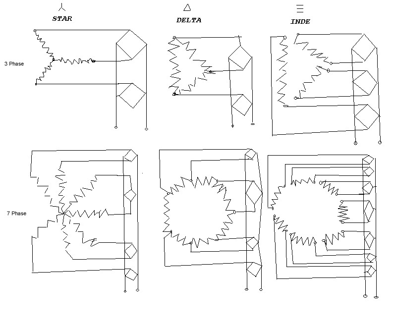

Gill
Joined: 11/11/2006
Posts: 669
Posted: 01:13pm 22 Jan 2007
Matt
Thanks for the circuit.
It will suit my solution .
Sorry I havn't had time to draw this up earlier.
We all know of Star and Delta, but there is a third. I am going to call it Inde (Independant). Now I'm sure it's been thought of before but I reckon it's never used because it needs more wires (same as Star/Delta)and twice as many diodes. I also believe Inde will give the same characteristics as Delta in spite of the extra diodes. If an F&P is made for Inde it can easily be connected/switched to Star or Delta.
Sorry I can't do the beautiful graphics but at least the idea is out there. I have a Inde wireing diagram for the stator too, but sorry the scanner is on the fritz.
Edited by Gill 2007-01-26
Cheers Gill _Cairns, FNQ

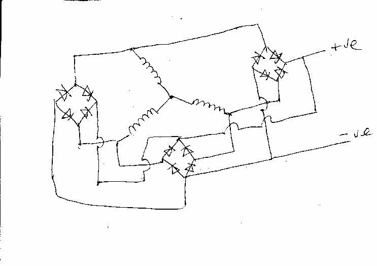

Robert_VK2BBR
Joined: 31/12/2006
Posts: 67
Posted: 02:30am 23 Jan 2007
Hi Gill
Thanks for the drawings. regards robert
ps I saw another system for conecting 3 phase alternators that i think used an extra diode at the 'neutral point (star conection i think. I will se if I can find it again.Edited by Robert_VK2BBR 2007-01-24

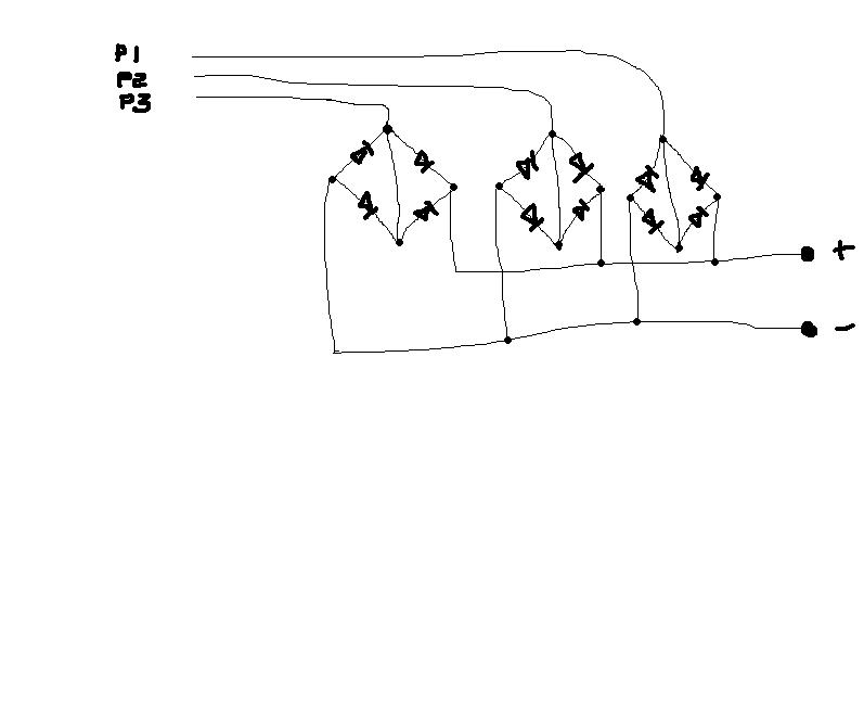

Robert_VK2BBR
Joined: 31/12/2006
Posts: 67
Posted: 10:48am 23 Jan 2007
an alternative is two phases in series per diode bridge, twice the voltage twice the fun?

Gill
Joined: 11/11/2006
Posts: 669
Posted: 11:10am 23 Jan 2007
Sorrry Robert,
I disagree with your proposed circuit, or at least that it puts two phases in series and doubles the voltage. What I see is each phase going through 2 diodes in parallel to double the current carrying capacity of the rectifier. The rectifier supplied with some ecnovision kits are like this. The diference is only in wireing. On your circuit your parallel diodes are on seperate bridge rect, whilst econivision is very neat paralleling diodes on the same bridge.
But still fun for sure.Edited by Gill 2007-01-24

Chipboy
Joined: 13/12/2006
Posts: 16
Posted: 11:43am 24 Jan 2007
Hey Rob, you know full well I told you its only 1.73 (sqrt3) times the single phase voltage not twice!
Might well be lots ie > 2 of fun though!
