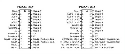

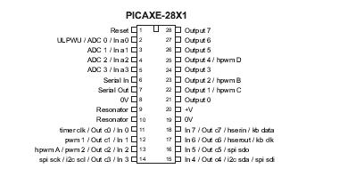

GWatPE
Joined: 01/09/2006
Posts: 2127
Posted: 07:27am 16 Dec 2008
Hi Dom,
Most of the info you need is in the picaxe programming application in the help section.
These are the pin connections for the 28A,28X,28X1.
Gordon.
PS. I see PWM is available on all the X-series, but not the A-series. I will be waiting for the 28X2.

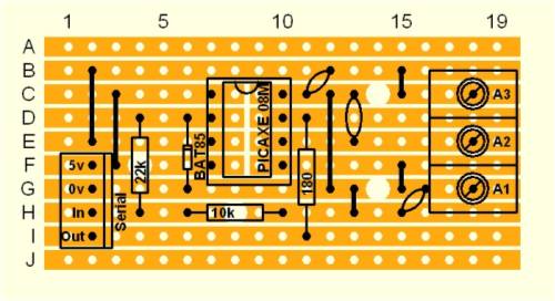

Posted: 10:02am 16 Dec 2008
what software do you use to design the veroboard pcb's looks like it makes a nice job

greigy,
I use StripBoard Designer 1.01
It's free but it does have some quirks but I know my way around them now. Should you get it, I can give you my component library which is much more than the basic ones supplied.
The free download may state it will take 1,000,000 minutes before saving your work, accept that, then 'OPEN' the same file. A window appears that overrides the nag setting, file saved.
There are other free strip board (veroboard) designers out there. Some are too basic and restrictive but do a google and see what you come up with.
Cheers Gill _Cairns, FNQ
domwild
Joined: 16/12/2005
Posts: 873
Posted: 08:29am 17 Dec 2008
Gordon and Gill,
Thanks for answers. Notice the pins have additional functionality from a 28X to a 28X1.

Hi Gill,
You still use Stripboard Designer? I found a better one here. Is free and no limitations and is looking great. It have also a version for Win98 if someone is still using it for electronics and CNC ...
It have three modes:
- stripboard
- perfboard
- pcbEdited by vasi 2009-03-05
