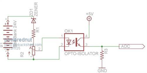

I've been trying to figure out a way to measure a voltage on a solar panel (or battery or whatever) using the ADC on a microcontroller that does not share a common ground with the voltage being measured.
I've been thinking about using an optoisolator and feeding the output of that directly into the ADC. I'm thinking that the brightness of the led will vary with the voltage input to the optoisolator which will (hopefully) vary the output as well.
However I'm not sure it'll work. Any of you electronics gurus care to comment on if you think it'll work/any gotchas etc? I'll post a proposed schematic when I get a chance to knock one together.

okay, here is a rough concept of what I'm thinking about. The battery on the left is a substitute for whatever voltage source is going to be monitored by the adc.

I doubt that would be even remotely linear. There are special optos to do this, they have feedback to the isolated side but a standard opto would not work IMO. it will also load the source a lot which may or may not matter.
The best way I think it to use serial of some type to transfer the data across the isolation barrier.
For example a VCO powered by the source, or an 8-pin uC sending serial data from its ADC.
What level of Vs are you expecting?

I got around to testing the concept over the weekend with an old opto-isolator. If anybody else cares, Rob was right: its completely non-linear and pretty much non-workable.
Oh well, live and learn.

I have had a mate email me to say he's got a similar circuit working with a standard opto, but I think it was very dependent on getting the components just right and matched and only linear in a reduced range.
So I guess it can be made to work if you really know your analogue, but I'm 90% digital and always go for converting analogue to digital once as close to the source as possible.
