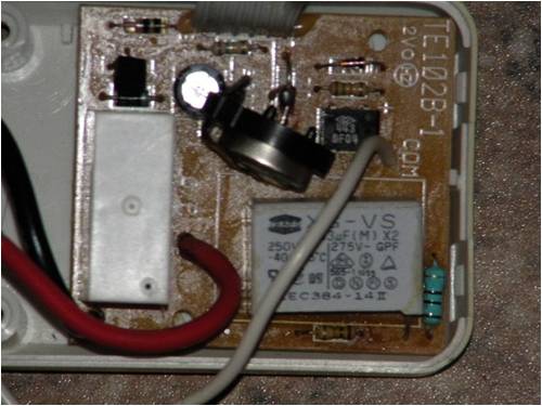

Secondly, here is the internals of an Arlec PC787 timer (If I uploaded it correctly!). Please excuse the camera flash, it makes the actual pcb look dull & sketchy. It is actually a very clean board for its age, but the flash makes it look a bit cruddy...
The battery clip in the pic I soldered in. originally Arlec jam the battery between 2 bits of metal and its held in place by a sticker. Once you lift the sticker its fiddly, next to almost impossible to get it to sit back in a sturdy manner. When I replaced the battery I added the clip. But will rip this out again & replace with a rechargable AA for convenience. Can you think of any issues I may have with this? That battery & 1 X AA are both 1.2volts. Only issue I forcast is posible issues charging the AA internally from the timer... but thats for you lot to answer as I am unsure on that!
Edited by Lapsy 2012-02-02

Posted: 01:00pm 01 Feb 2012
Lapsy, I think I see what you mean but there appears to be a misconception of the timer function in your thinking.
A timer is just an electronically operated switch. The switch part (a relay actually) can switch any voltage and it does not have to be the same as the one the timer requires to run.
All you need to do is isolate the contacts of the relay from the rest of the circuit and use the contacts to switch 12V if that is what you want to do. Since the contacts in the original timer configuration are meant to switch 240V AC, removing the 240V parts already isolates the circuit.
BTW, my timer does not look like yours at all but I do recognize some key components.
The relay is that rectangular white box to the left of the thick red wire. Have a close look at the housing to see if you can find the relay coil voltage. If it says 24V/ 10A then its like my timer and you can run it on 24V.
You need to remove that big white capacitor(under the white wire) and the small resistor that's connected in parallel to the cap. Also remove the big resistor to the right of the cap. There should be 4 diodes (it may be a bridge rectifier - black box under battery holder with 4 legs)that also needs removing. That should be all.
The battery does nothing unless you disconnect the timer from its 24V power source in which case the battery takes over until it runs out or the 24V are restored.
So, to sum up, use the relay contacts to switch your 12V (black & red wire?).
Connect 24V - if its a 24V relay - to run the timer from. The timer takes very little running power, just a few milliamps but there must be a reasonable source of that for the extra 'kick' to turn on the relay when the timing setting(s) demands.
Where to connect the 24V? Try the + and - where the bridge rectifier was and solder appropriate wires in there. After all, you replaced what came out of the bridge rectifier with an external source.
Take care, keep the magic smoke under control
