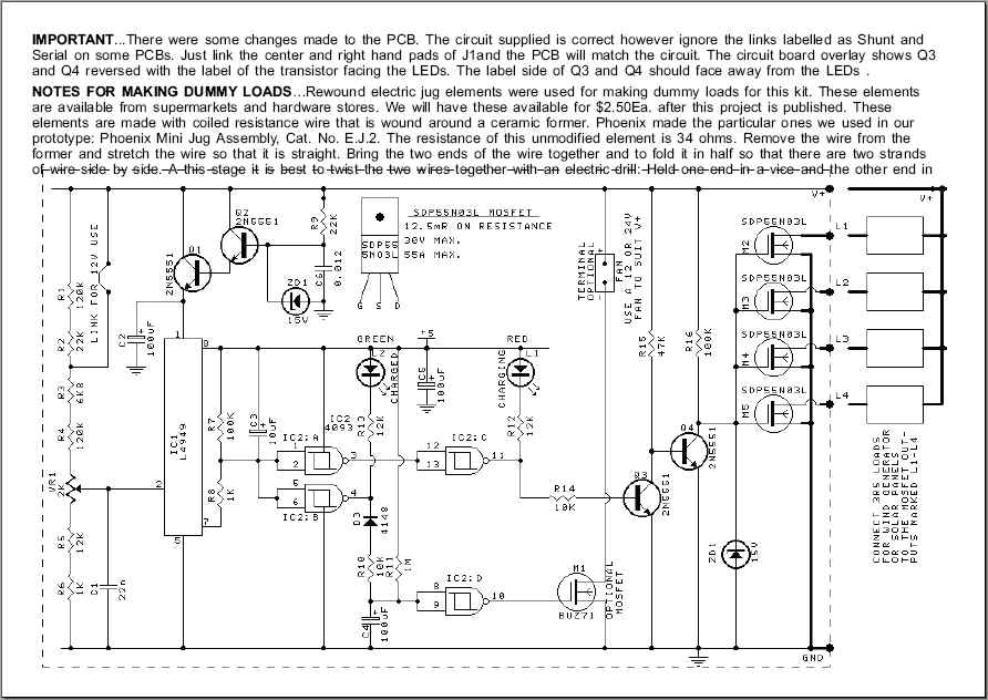

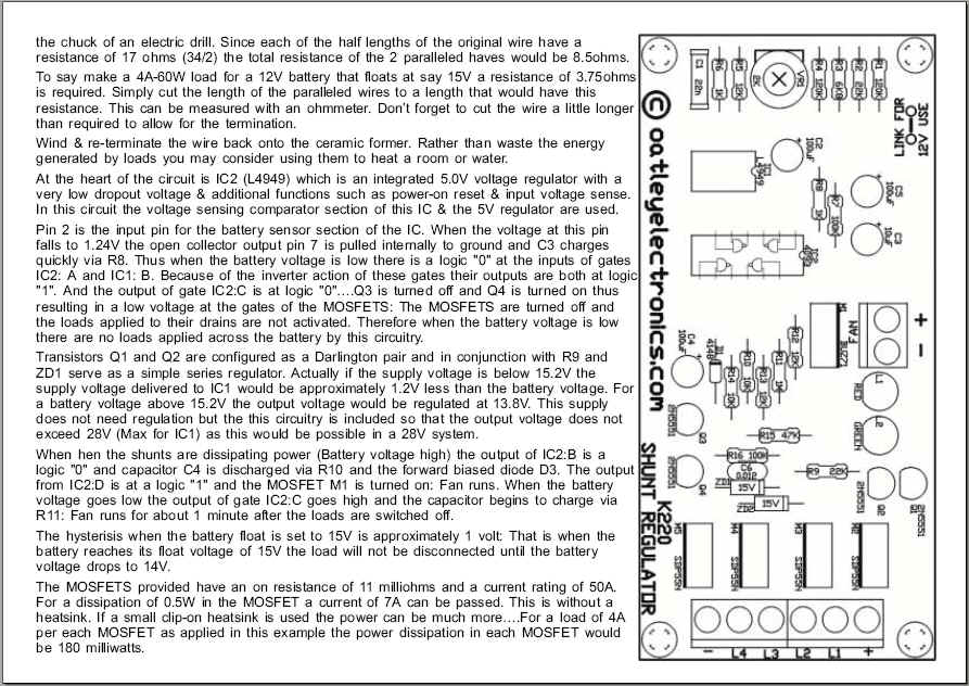

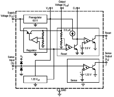

I'm having trouble with my Oatley K220 shunt regulator.
There is suppose to be 1v hysterisis between divert and charge but there is none, such that my load (lights) are on an off like a bloody Christmas tree.
The circuit description does not detail what provides the hysterisis, and I see no positive feedback circuit that I can identify.
Any thoughts? Can anyone help?

Hi Gill
The more I look at that circuit, the less it makes sense. I dont understand why they have designed it the way they did. Q1, Q2 and ZD1 could be replaced with a simple 7815 reg for a start. And the L4949 is only used as a 5v regulator and op amp, waste of an IC.
And no, I cant find any hysterisis either. There would be some in the op amp within the L4949, but only a little and you have no control over that. There is a small delay, thanks to C3. This circuit looks like someone had a few extra components they wanted to use for the sake of it, but it could have been designed with a lot less.
I would try a 10k pot with 22k series resistor between pins 2 and 7 of the L4949. The will provide some feedback, you may have to play around with the values a bit.
It is possible that this circuit runs more as pulse width modulation into the dump load, so its will switch the dummy load off and on quickly to pull down the battery voltage, and this would flash your lamps like a christmass tree

  Gizmo said   Hi Gill
Can say that for most of the controllers I've seen!
  Quote  Q1, Q2 and ZD1 could be replaced with a simple 7815 reg for a start.
Well, not really. It would be ok for a 12V system, but a 24V would go very close to exceeding the max input of those 78xx series regulators, and 36 or 48V systems would be right out.
  Quote   And the L4949 is only used as a 5v regulator and op amp, waste of an IC.
Indeed.

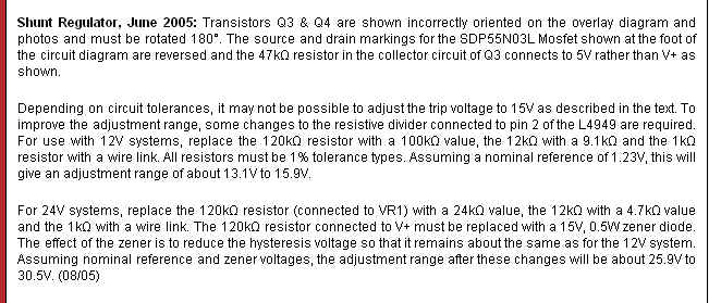

hi Gill check out s/chip august 05 for 220 mods, lots of resistor changes

Your suggestion of adding a feedback circuit was what i was thinking of too, and as it is the simplest/quickest to impliment, I'll give it a go first. Ta.

Have downloaded those Notes & Errata you refered to and have started to modify mine as the lack of adjustment range applied to mine. Thanks
As a further frustration the Notes & Errata cite reducing hysterisis voltage(on 24V)by adding a zenner to the voltage devider. If anyone can explain this to me, please do. I just don't get it.

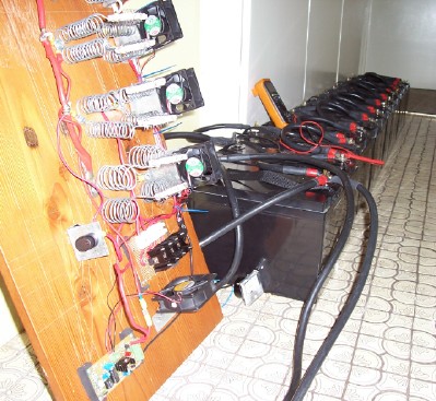

I run rewound elements on mine. I watched them closely and with 35.3 amp dump on 1760ah bank, the voltage dropped .2V before starting to charge again.

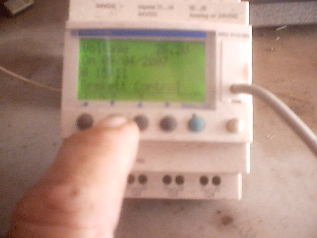

by the way do you know what this part is? It's off a small charger.
I had a 240ac gen going for something else and I hooked it up but it crapped out, it looks like a resistor but with no bands, just grey (240ac).
I think I'll stick to the 12v gen next time.

Glad to hear one of us is making some headway. That mod has had to take a much lower priority rating, though did do a little more.
I'm running a 330k resistor for feedback (pin7 to pin2) but still not 1v. I get .6v and as I get so much variation what with the dump load plus all the other loads from goodies as required, I've resigned to accept an amount of on/off with the load dump lights.
Do intend trying again soon(got right range of resistors now).

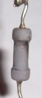

Bit of a ring-in that resistor.    It makes me think of one I had to replace in a battery drill charger the other day. All blackened it was guess work reading the colour bands. Very low resistance it was current limiting. Ended up cheating, -borrowed a second charger that worked and looked inside when no one was watching.

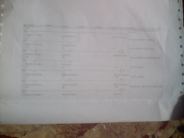

Hi Something to throw in the melting pot Re load dumps.
I have given up on regulators particuarly the type that attempt to balance the incomming to maintain battery condition. Nowdays I use a dump on the AC side of the inverter that is a standard hot water element in the cylinder usually only 1500 or 1000 watts though. this is controlled via a smart relay that is sensing the battery voltage I use a relay but solid state ie triac's could be used. Doing this allows me to program all sort clever features via my computer ie three stage charging,adjustable on time for dump, twin battery change over, alarms to my cellphone,etc even then on the cheapest unit i have 3 outputs 8 inputs for future use. The idea hits the battery hard for say 10 sec usually lowering voltage signifigantly then after 10sec stays of until they recover, much better for all connections rather than small currents that corrode connections including those internal in the battery.
I have used Zeilo brand but many others on marked and as mass produced usually much cheaper than conventional regulators. I do have a emergancy shut down senser on DC side that is triggered with a simple cct for over voltage never needed to this day about 5 years now.
Cheers Herb

    Thanks for that. It's an idea I suppose all of us have toyed with, that is, rather than Dump the excess into some wasteful load, to use it for a more practical purpose.
Most practical purposes being 240ac based? I don't know about that.
In any case you are still sensing the battery voltage and turning on a switch/s when it exceeds a certain point/s.
So it's still a regulator. Though a smart one by what you say.
Are you controlling it through the computer directly, or is the computer programming a chip like a Picaxe?
The 3 stage load dump is interesting. Rather than me ask questions, perhaps you could give us more details. Perhaps a circuit and a pic of that Zeilo device would be great too.
My origional idea was to use three Oatley_K220 regulators in parallel with each turning on a smallish load dump. Each regulator set at progressively higher voltages thus achieving a dumb-mans taper off or stepping regulator. 3 in parallel also served as a fail safe should one fail. But as this thread indicates, performance was not as predicted.
So I'm stuck with a "bang-bang" regulator (BANG it's all ON - BANG it's all OFF). Not the best for an expensive battery bank that I expect to last.
I'm waiting for the smart bunnies to come up with a PICAXE stepping regulator as I have only just discovered the chip myself. So many possabilities......

The smart relays are same as pixaxe but built up units outputs inputs etc. I have tried to include a couple photos one of unit one of type prog u use this is a three stage dump gives 10sec bursts into my water heater. I see large bursts are much better on batteries than pussy footing around, small currents corrode connections. Gasing of baterries must occur at anything above 85% charge. I have no fear of damaging batteries with this style charging quite the converse. The time I have damaged batteries is the use of smart drive at high rpm on my hydro the high frequency ripple removes all sulphating but then shakes them to destruction. I always use a filter now with smart drives.
Back subject if any interest in the smart relays i will try to get better copy of my program but most ppl can work something out must be 101 ways doing it.
