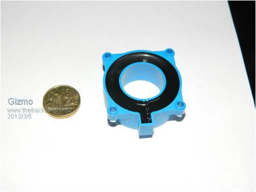

Recently I've been looking for a current sensor that I can use with a microcontroller, and measure a few hundred amps, accurately. I've used the Alegro current sensors before, but these need to be wired into circuit, and my situation means I may need to draw spikes at over 400 amps for a short time, which I feel is a bit much to ask of the Alegro connection leads, even though they are rated for that sort of current.
What I wanted was a inductive current transducer, these have a hole that you feed the current carying wire through. No terminals or connection to worry about. Most of these transducers need a +- votage supply, typically +15 to -15. They can also have a couple of trimpots to adjust offset and gain. They are also expensive.
But I found one that I think might be the ducks nuts. The HTFS 200-P, from LEM. Its about $34.oo AU, and measures up to 300 amps. They also make a 600amp and 1200amp version. The hole is 22mm in diameter, meaning you can feed a pretty big battery cable through. Supply is +5V, no negative supply needed, ideal for microcontrollers. And best of all, it has a Vref pin.
The Vref pin means we can accurately measure the 0 amps reference voltage. Feed this into a microcontroller, along with the Vout signal, and we can offset any flutuations in power supply voltage, one of the problems with the Alegro ( or most 3 pin current sensors ). If you connect a digital multimeter or panel meter between Vref and Vout, it will accurately display zero, plus and minus amps unaffected by the power supply variations.
I ordered a HTFS200P from RS Components http://australia.rs-online.com/web/p/current-transducers/532 9205/
Next to a $2 coin for size comparison.

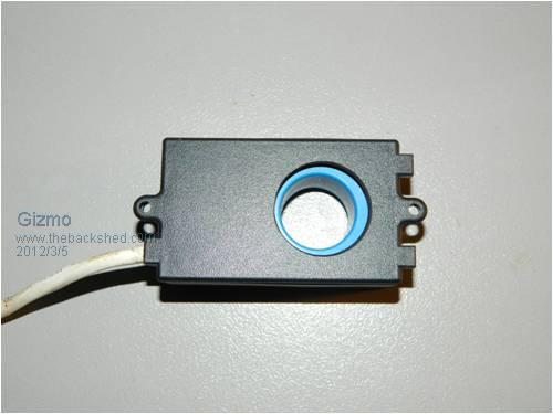

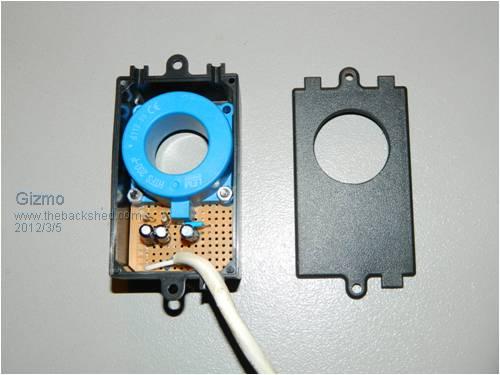

Fitted neatly into a plastic case, with circuit board attached. The case has holes to suit the power cable I want to measure. The circuit board contains a few filter caps and series resistors, nothing special.
Tomorrow I'll connect it up to a Maximite and see how it performs.

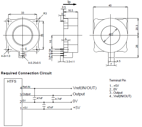

what's the difference between the P & PS2 model?
Also, don't quite understand the use of the Vref.
Its an identical copy of Vout?
It should work ...in theory
Posted: 01:54pm 21 Mar 2012
Hi Spud
Been meaning to get back to this.
I think the PS model has a larger operating heat range, for industrial applications.
The Vref is the mid point between 0 and 5v. When there is no current flowing, the Vout should be the same as Vref, but I found its slightly off by a few milli volts. Vout will go above or below Vref, depending on current and current direction.

The P version has a fixing via 4 holes
The P/SP2 version has a fixing via 4 solder pins
