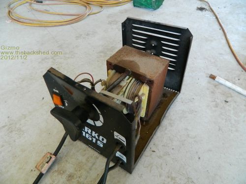

I've picked up a 2nd hand welder, little one, maybe 140 amps max. The plan is to convert it into a high current battery charger, so I can charge my battery bank with my petrol generator when the sun dont shine and the wind dont blow.
My generator can supply 6kw, but I dont expect the charger to deliver that sort of power into my battery bank, I'm thinking more along the lines of 1.5 to 2kw, about 30 to 40 amps, into a 50 volt battery bank.
If I get a few days of poor weather, I can connect up the generator to this charger, as well as the hot water system ( about 3.5kw ) for a hour or two to give everything a boost.
The welder has a variable core, which might be handy for adjusting the charging current.
So before I start on this project, I was wondering if anyone else has any experience with something like this?
I was thinking of using several low current windings and bridge rectifiers in parallel instead of sourcing heavy copper wire and a dirty great bridge rectifier.

Might have had a real bit of luck with the welder. Just measured the AC output voltage and its 43 volts. Never measured a arc welders output before so dont know if thats typical, but if I bridge rectify that, I get 60 volts DC, perfect for charging a 48 volt battery bank.
It also means I dont need to wreak a perfectly good little welder to make a charger, I can leave it as is, just add a bridge and a amp gauge.

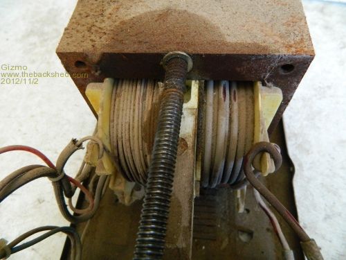

I have one of those Australian made Goodwell 140 amp stick welders, bought it new about forty years ago.
They must have made millions of these, and they are more or less readily available secondhand in full working condition for typically fifty to a hundred dollars from Gray's and E-bay.
http://res0.graysonline.com/handlers/imagehandlerxt=l&id=620 1337&s=n&index=0&ts=634364449592630000
The magnetic core and primary winding will supply 3Kw continuously, that is 240 volts/13 mains amps. It will run hot, but not dangerously so.
The primary has exactly 240 turns.
You can force 5Kw load for intermittent duty such as welding, but it will handle 3Kw all day continuously loaded.
You can use the sliding shunt magnetic gap to limit the current, but that has a bad effect on the output voltage regulation. The shunt gap also buzzes annoyingly, removing it produces a silent transformer.
If you remove the shunt magnetic gap completely, then you will have a very low cost 3Kw transformer primary plus core that will produce 1 volt rms per turn on the secondary with excellent voltage regulation.
That translates to around 28 volts at a genuine 100+ continuous amps, not bad for fifty dollars.

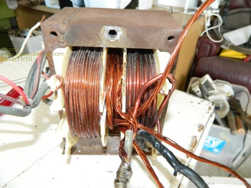

Did some testing with a bridge rectifier and my battery bank. The output is too low. With the battery bank floating at 56 volts, the welder was only supplying 1 amp. I shut down the solar charge controller and loaded the bank a little, then at 52 volts the welder was supplying 6 amps. So assuming a battery bank in need of charging, at around 48 volts, I would get about 10 to 15 amps. Thats OK if I could leave the welder/charger connected for several hours, but I need a fast charger, with 30 or so amps.
So I'll have to modify the transformer.
There is approx 200 to 250 turns on the primary, and 35-45 on the secondary, so I'm going to guess this is a coil per volt transformer. I can remove a few turns from the primary to increase primary current, but not good practice, and will mean more heat to get rid of. Or I can add a few turns to the secondary, say to bring it up to 50vac, maybe. That would only be about 7 turns, which will fit easily. I dont have any wire thats the same size as the exiting secondary turns, so I'll have to see what I can dig up in the junk pile and wire several in hand to get the current capacity. These extra coils can also serve to provide a 10-12vdc supply for a cooling fan.

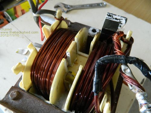

Posted: 10:45pm 01 Nov 2012
Thanks for the offer Bryan but I jumped in already and wound on a few extra coils. The wire in the secondary is 4mm diameter, about 12mm square, aluminium wire. I had some 1.2mm enameled copper wire, thats 1.1mm square. I made a bundle of 8 wires, any more and it would have got to tight in the transformer. 8 wires gives 8.8mm square, which is probably as good as 12mm alu wire, at a guess.
I could fit on 8 extra turns. Applied power and I was reading 52 volts AC. Thats it for tonight, tomorrow I'll test in on the battery bank and see how it goes.

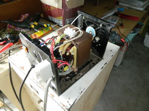

Posted: 06:29pm 09 Nov 2012
OK, tested the transformer with the extra turns and it was only good for about 500 watts at 50 volts. I needed to get more windings onto the secondary.
So I made the decision to dedicate this thing to being a charger only, not a welder. I removed the variable core mechanism and unwound the 8 turns from earlier. This gives me a lot of extra space in the core for winding in additional turns.
I glued in a piece of plastic to make sure the primary and secondary are well isolated from eachother, and some cardboard to the laminations to protect the coils. Then wound on 14 turns.
Put it all together. Added a fan to keep things cool, the bridge rectifiers, and a 30amp fuse.
Tested the output again, and it was supplying 1050 watts into the battery bank, which was already in a good state of charge, sitting at about 53 volts.
I would expect this to rise to 1200 or more watts for a discharged battery.
Now I feel I could get a lot more out of this transformer, I have space for more windings, but this will do for now. It is afterall just a backup to give a tired battery bank a bit of a boost while I'm heating the hot water tank.
