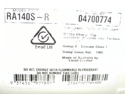

For the record so far from the model numner all I know is it's a Westinghouse Bar fridge/Freezer, about 10 years old (Don't know what you mean about frost free, but this thing ices over like the north pole, forever having to defrost it, it works too well to be honest!).
Rated at 2.5 Stars in the energy rating department. Energy consumption is 376W. Fridge is in good condition, well looked after. Been in storage for approx 5 of the 10 years I have had it. Recently been used on mains and running as it should.

Think you will find that it is 376 Kwh/annum. The same as my full sized 430 Litre Westinghouse fridge. You need to know the running watts.
Power companies love beer fridges. $100 a year per beer fridge...easy money Edited by yahoo2 2012-11-16

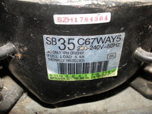

Posted: 05:32pm 15 Nov 2012
This has been sitting unused for about 6 months...
Door seals fine! The freezer just ices over the shelf wildly sometimes! Cant complain really. Takes over a month or so to build. I can run the thing on the lowest setting and it is sufficient for my needs. Holds a weeks meat and veg for me so....

It says 0.6A full load.
If starting load is 10 times that, inverter needs to allow for 1500W surge.
Interesting if 1,000W/2,000W pure sine inverter would be enough?
