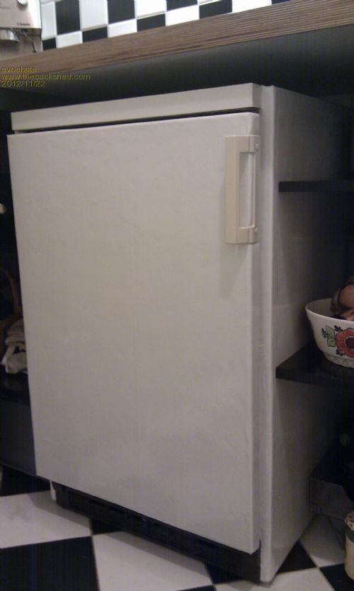

Hi all,
I just wanted to share a successfull story. A year ago i did insulate my 19 years old fridge with styrofoam which reduced . That means it equals a new fridge with an energy level of A++. And yes, the fridge still looks decent after the insulation.
A check after one year did show that no problems occured (no condense water or so) and that the fridge is keeping that low power consumption. For details and more pics have a look here: http://coolfridge.blogspot.de/
Here comes a pic of the freshly insulated fridge:
Greetings. Allen
