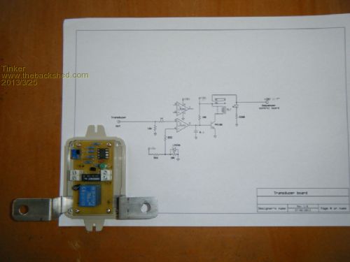

I now use current sensing, as soon as the battery bank charging current passes a preset level the LIPO equaliser turns on and runs as long as a charging current above this level flows into the bank. A picture of this gadget is here:
The little hall effect current sensor (blue box) runs of a single 12V supply and has a nominal 20A rating with a + - 60A capability. The output sits at 2.5V with no current flowing and goes above or below this depending in which direction the current flows. So its easy to combine with a 2.5V reference and a comparator do do the job.
LIPO cell equalising now starts as soon my preset charging current is exceeded and continues throughout the charging time. This can only be good for the cells, no more late equalising to even out the charge and no cell needing to bleed off excess charge as is used on the in between terminal post equaliser strips.

Nice work Tinker , can you give a bit better detail on the schematic? . So am I correct in thinking what you are saying, is you have a 12V powersupply to balance while the battery is in its charge cycle and a super cap for active balancing when discharging.

Not quite Phil, let me explain.
What you see on the picture is just a current activated *switch*. This feeds 12V power to run the sequencing electronics on my LIPO equaliser. It senses current in the negative lead from the MPPT controller to the battery bank so this switch only turns on while the batteries accept charge above a preset level.
I described the sequential equalising idea in more detail here about 6 months ago.
Since I obviously don't want to run this all the time, especially since relays are involved which have a limited mechanical life, I let this current sensing circuit select when its worthwhile to balance my LIPO battery bank.
The supercap (2 x 25F in series) connects sequentially in turn across each LIPO cell, thus transferring charge from the high cell to the low cell. This happens during the entire charging time, it stops when the bank no longer accepts charge (its full) and it stops over night when no solar charging happens.
This is active balancing, as you call it, during the charging cycle.
Nothing is done during overnight discharging, I found the battery cells do not drift far from being equal in that time and whatever difference they may have by morning immediately gets actively equalised as soon as the solar charging is on and supplying charge current.
