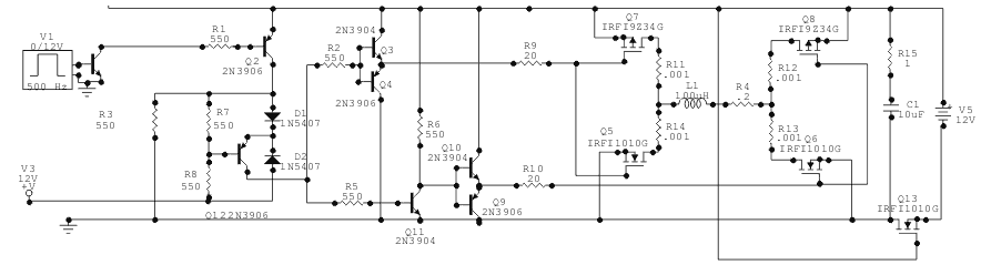

I have had some success in using the smartdrive as a motor. It is reasonably straight forward to derive a signal from the hall effect sensors and use it to drive some fets. I have a pretty basic circuit diagram here that I used to get full speed forward/reverse. I used pwm on the power supply (12V) to this circuit and achieved speed control as well, but it was not without problems. The motors need re-wiring to drive off low voltage (12/24 etc)
It was quite a while ago that I did this and I haven't got time to go over it properly. The parts quoted are just whatever was closest in Circuitmaker. There are some .001 resisters that are just there to measure current. This shows the drive for one phase (I never built the full three phase driver). Anyway, for what its worth:

@jimovonz,
Do you have a schematic or connector pinout for the position sensor board. The board I have I have attempted to trace, however on testing we got no output.
Much appreciated,
