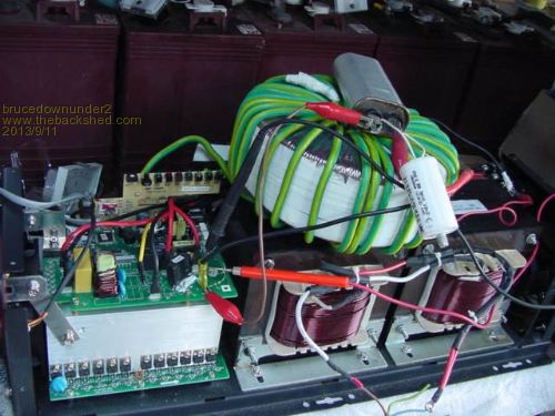

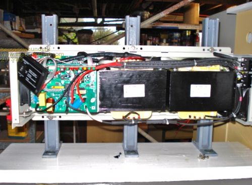

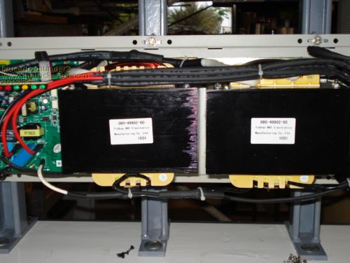

Well, the "boat anchor" did not happen, the transformer is a beauty,very heavy ,weighing in at 14 Kg .
I had some fun,(not) , getting the manufacturers epoxy core plug out , but nothing is free , as they say..Thats part of it sitting on the transformer.
I've been following Oztules (john) instructions and as he said it is fairly straight forward. I have to buy a ferrite "H" section choke ,,fairly large , if anyone knows of a chinese link ..or aus.
I've taken the old outer winding off ,2mm wire, and am ready to wind the 30mm square wire winding of 30 turns. Thats big wire..

A fun project for sure , but when you see 235 watts of your solar being wasted on the inverter, you start wondering what can I do ???.
John,(ostules), a long time forum member ,and very intelligent, has my exact same inverter ,,,So, who better an engineer to show us how to do it ??.

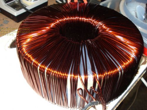

I removed the 2mm outer winding (old Secondary) and now have the new Primary to source and then wind -thats going to be a tight fit ,30mm square wire is around the thickness of a pencil or even more,30 turns of that ..
I ordered the E55 size ferrite choke halves yesterday ,so only have the 30mm X 10meters of winding cable to source ,wnat to get the thin covered cable if possible ,for ease of winding.

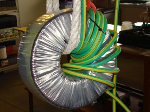

OK ,, I've got the 25mm square earth cable now ,,11 meters of it ,, so the question is ,,how do you guys reckon I should wind it on the Toridal.. She's pretty thick and stiff cable ,by the way.
Now 11 meters is around 40 feet in old ,( my terms) mesurements , so pulling that through a small,(100mm,4 inch) hole is not so easy.
Question is , could I double the length and pull,(wind) the two lengths ??.
Still the same amount of work ,, but half the pulling through ,if you can see my idea??.
What do you reckon ??
