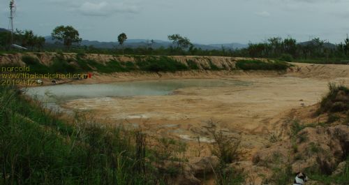

In another thread have spoken about dams and solar pumps. I have a problem with "cloudy" water in my main dam, the "cloudy" caused by clay. It does not settle out between wets, and then the new wet introduces more. There is a chemical solution, adding Alum (hydrated aluminium sulphate)to the dam water, which basically means you change the Ph of the water from alkaline to acidic.
There is a method called electrocoagulation that is gaining popularity. Basically my understanding of this is it is a little like the air ionisers, but applied to water. Am looking for such a device I can construct and mount near the suction of my pumps utilising a small amount of the DC solar power I use to power the pumps.
Perhaps a 4M member has some experience here and can assist, as far as electronics go I am a "paint by numbers" kit constructor, thus can probably build such a unit but not understand the theory behind it. As my pumps only pump to 10 l/min, am thinking of a sort of inverted funnel on the suction with the devices "electrodes" near the apex of the funnel. I am trying to avoid mechanical filtering, this only introduces more maintenance, and the particles are minuscule.

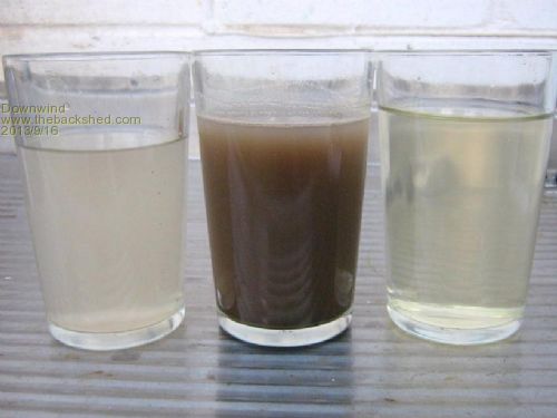

Here is a test i done earlier. it was not conducted under test conditions, other than what appears to work best.
You have to guess which glass was the control sample.
The one on the right was done first, with V+ to iron and Gnd to aluminum, and has had more settling time, the one on the left was V+ to aluminum and Gnd to iron, it has have less time to settle, although as it did it lost the yellow tinge the right glass has.

and the 3rd guess is which one is Adelaide tap water and no prizes for picking the middle one..........
