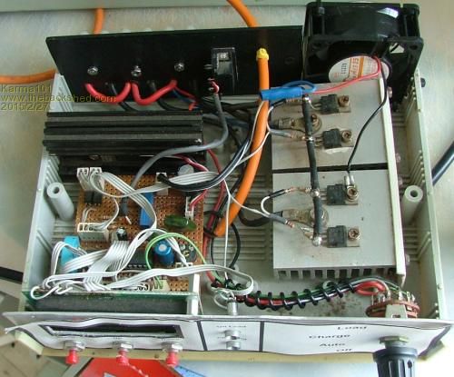

I am building a wind turbine out of a 3 phase Baldor 2hp motor I turned down the rotor and am installing magnets. I want to build Gizmo's Picaxe based Windmill Controller/Charger. that uses's the picaxe 28x chip I found the chip on eBay for $29. after shipping.
From what I understand you program the chip on the board. using the 9 pin serial plug. What is on the other end?
I have a few questions about the Items in the case like.
#1 the circuit diagram dose not show a 3 phase bridge rectifier before the Battery or is that what the 4 mosfets are.
#2 what size resistors are used for the dump load I take it that is the long black object on the left behind the circuit board?
Looks like fun I want to build the data logger next.
Thanks for your help

Hi, i replyed to your question on the picaxe forum.
As i had commented you can get USB to serial cables far cheaper than the crap RevEd sells well over priced, for example i have found all adaptor cables that use the HL340 chip work with Picaxe, so search ebay for "HL340 USB to serial" and you should find a few like this one ..........
http://www.ebay.com.au/itm/USB-to-9-pin-serial-cable-USB-to- serial-COM-port-USB-RS232-HL-340-A978-EW-/331197929551?pt=LH _DefaultDomain_15&hash=item4d1cef584f
Just understand not all cables will work with picaxe as some have the siginals inverted, so any cable that states TTL will not work, only cables that has true RS 232 data works with picaxe.
Basically its still TTL with a inverter chip added to the board, which makes it compatable with picaxe.(RS232)
